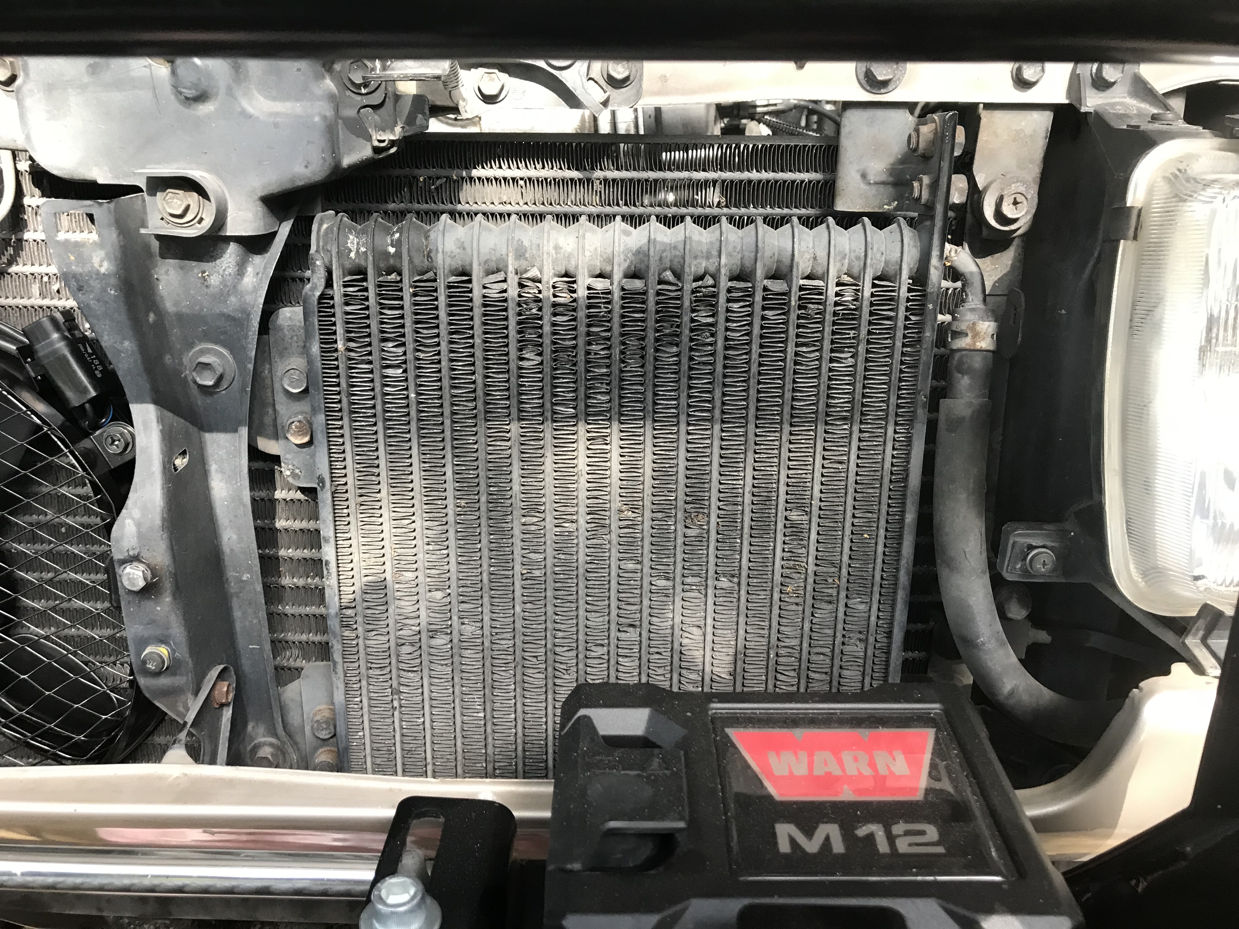

I am replacing the four rubber ATF lines for the trans coolers - 2 that attach to the radiator, and 2 that attach to the transmission cooler at the front of the truck. Does anyone know the four Toyota PNs for these lines?
Any idea what this hose #8 in the scematic is? PN 32942-60231? In the schematic, it's hose #8 - a second inlet hose. I have #7 and #9 (32941-60110 and 32942-60121) but not sure what that third hose is. I'm not seeing where a second inlet hose would go. The schematic is a LX and mine is a '94 LC but don't think that is the difference. Trying to get stock hoses back in place after PO hose spaghetti just let go. Thanks for the post and this thread prepped me for this job taking a little longer than I would have thought.

#8 is a return hose. It connects the short steel tube that transitions through the radiator core support to the steel return line that is routed along the engine block (lower line). You can save a lot of money by using 3/8” Gates trans cooler hose at every location save the preformed hose that carries fluid from the upper steel line beside the engine block over to the inlet of the radiator on the passenger side. The preformed shape ensures the hose won’t come into contact with the belts and fan.

Will any trans cooler hose work for the inlet & outlet of the trans cooler. If so, anyone know the size I should get?
3/8” Gates or Parker trans cooler hose has worked for me 5 years now using regular hose clamps. Constant torque clamps like the oem clamps are optimal but not mandatory if you don’t mind doing a clamp check every year or two.

3/8" ATF compatible hose is 9.5MM ID, the OEM hoses are 10mm ID, however with a little bit of lube (ATF) many people have used the 3/8" hose, including myself. Maybe try a different manufacturer??
You could also check out Absolute Wits End, IIRC they had a kit with all the transmission cooler hoses.
the wits end kit is 3/8" hose too
i did this last year using parts store ATF rated bulk hose. lube the fitting and shove it on. maybe warm the hose w/ a heat gun if that isn't enough. buy a box of good hose clamps b/c the stock ones will be too loose.
