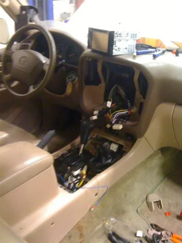

well with the help of a few mates I got it all installed...

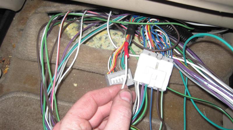

the cable they send out plugs in perfectly... the speaker wires all correspond but the other 4 wires that come with are USELESS.. they dont go to any power source etc... you have to find the other 3 wires needed (power constant, power switched & ground) out of the 2nd harness that provides power to the amplifier then from there to the head unit...
so we had to pop 3 of the wires out and place2 of them in different spots in that harness then place the 3rd into the 2nd harness as a jumper to get constant power I believe...

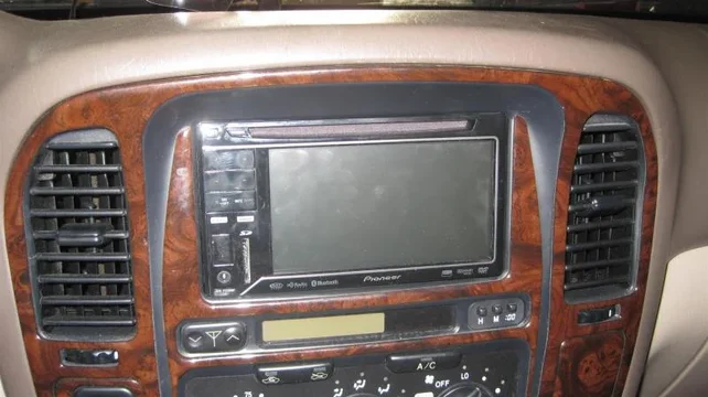

just adding some pictures to show the fitment and wiring... (98 LC)

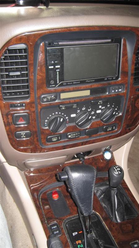

shows final fitment.. no trim pieces needed.. all factory

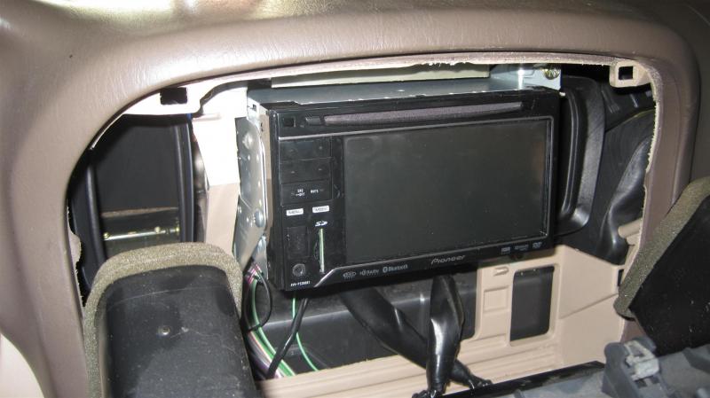

showing the factory brackets that you use from the factory unit

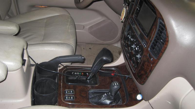

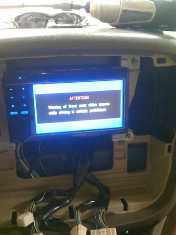

button installed so if someone wants to watch a dvd while car is driving (not driver of course ;) ) they can...
amplifier bypass harness.. the white wire had to be removed form the harness I purchased and tapped into a power source on the other harness..

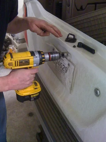

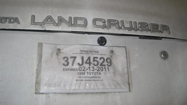

rear camera installed (there will be another pic with the hole cutting).. it ended up being about 1/2 in too high as it catches the upper door along the top of the HU screen but actually thats where the warning writing is so it is kinda ok... I will be machining another adapter to angle the camera some more so I can see the tow ball / trailer for backing up
