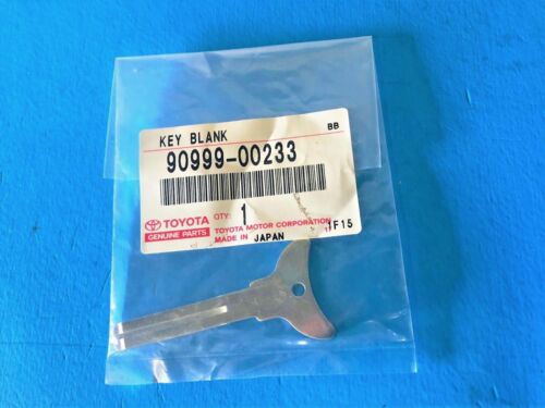

If you're looking for a flat physical key that will work on 08-15 LCs - this is an option. Albeit separate.
