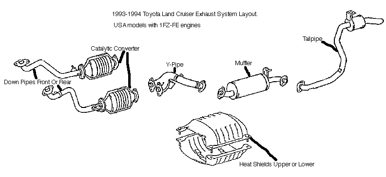

    The BOR sliders are designed for the later style 1995 - 1997 Land Cruisers. Mike said that the side-by-side catalytic converters on the 1993-1994 models prevent the BOR step-sliders from fitting.
    The 1993 - 1994 exhaust has the Y-pipe after the cats and the cats are "side-by-side".

    My question is, can I install a 1995 - 1997 OEM exhaust on my 1993? Are the exhaust manifolds themselves different? Or can I install from the Y-pipe to the muffler? Does anyone offer an aftermarket stainless steel exhaust that would solve the problem? Would it be less expensive to just fabricate a custom exhaust?
    Also, are the frames identical from 1993 to 1997? Even if I get the exhaust/cats solved, will I be able to mount the sliders on a 1993 frame? Or are the frames different from 1993 to 1997?

    Pretty sure the exhaust manifolds are the same. However, the 95-97 OEM exhaust parts are more expensive and they route below the frame. The cats might be interchangeable, but everything else is different. You kinda have to go with either the 93-94 set up or the 95-97 setup. There really isn't much mixing and matching.
    The frames are similar, but I think the exhaust hanger points are unique to either the 93-94 or the 95-97. There may be other differences that others can chime on or correct me if I am mistaken.

    The oxygen sensor locations are different between the two 94-94 has a sensor in each down pipe. 95-97 has a pre cat sensor and post cat sensor. I haven't done it yet but it looks like you can either mount the o2's where your PAIR system mounts to the manifolds or you could add new sensor flanges at the top of each 95-97 down pipe branch and cap the single sensor hole down by the cat.

    White knuckle offroad makes some sweet 93-94 specific sliders. Mine have held up well after multiple Rubicon trips. If your OEM cats are rattling, you can easily replace with a 95+ style cat with y pipe from Magnaflow. You will have to relocate the O2 sensors into the manifold and delete the PAIR system but that only takes an hour. Definitely a few different ways to do this.

    Mounting points for the right side are very different due to the cats. Just did a set of Luke’s 4x4 Labs on a 97. The right side front and middle mounts are pretty creative as they go above the exhaust instead of below like most sliders. Hard to imagine doing that on a 93-94 setup. Way too crowded.
    IF emission testing is NOT an issue, I would suggest doing like mine. Switch over to a late model style single pipe with an aftermarket small single 3-way cat, then there is room to still exit OVER the frame for improved clearance. I already had Slee Sliders, which now provide excessive cat protection. But too much is better than not enuff. I MAY go back and trim them down some day.

    Run the magna flow exhaust from the manifold for 95 97 go to single cat. Then remove pair system and put your o2 there. It works fine and does not throw check engine and gets your o2s to easily serviceable location and keeps them cleaner

    I think this is the best option. Buy the Magnaflow Y-pipe/catalytic converter, remove side-by-side cats and relocate the O2 sensor. I'll have to get an exhaust shop to fabricate from the Magnaflow to the stock exhaust already in place (and add bung for O2). But then the BOR sliders should bolt right on.

    Our Stainless cat back runs from the Magnaflow down pipe to the rear. Runs over the frame rail like the 93-94. Depending on what your local exhaust shop wants for custom it may be an option. Stainless Exhaust

    That looks like a great option!!! I could use the Modified Magnaflow downpipe and retain the PAIR system, plus switch to your full stainless steel exhaust which would work with the BIO step sliders.
