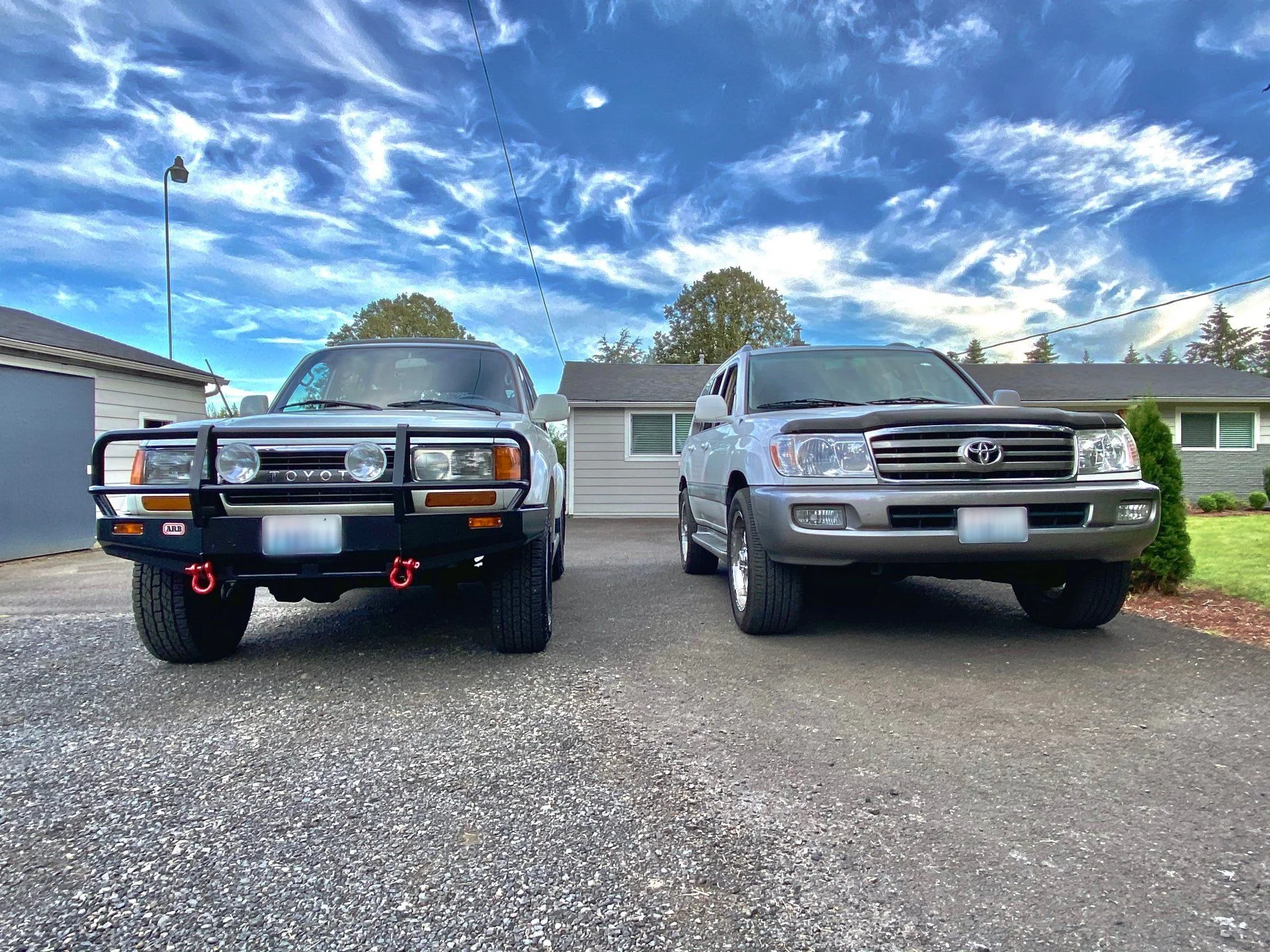

Pic for attention (my 80 and my mother’s 100).
