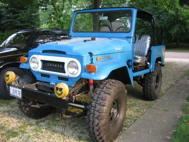

Q's do great up here in the North East! I run them on stock steelies with SOA. Pics of my rig are all over this board.... but, here it is again:grinpimp:

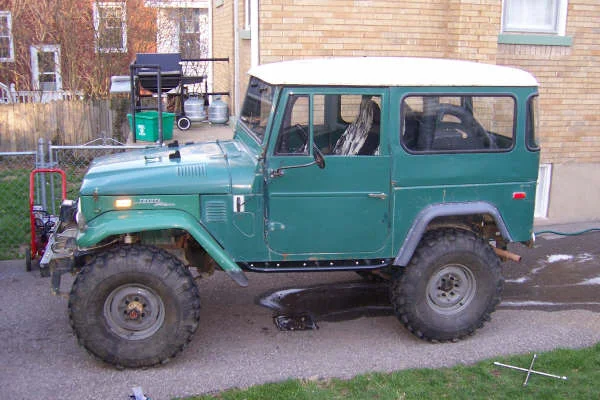

Q78's with stock wheels, 4" SJ and some extended shackles.....Not enough rubbing to be worried about, if any. Obviously my rear fenders are cut. As soon as they warm up, they ride fine on the street/HWY. There might be some used ones in the FS section
