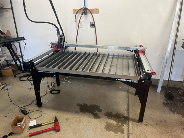

So, I've bitten the bullet and bought a Langmuir crossfire pro. And all of it's parts have arrived this week.
what people say is true, it arrives sporadically over about a month and there's no way to really tell when every thing arrives. But, I checked with them, it's all here.

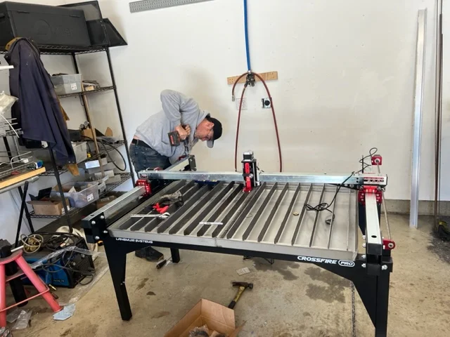

So, @Andrew Vincent drove an hour yesterday and spend the entire day from 9 to 4 helping me and it made a HUGE difference. We got the entire table assembled and working in one day. Only made one, two, three mistakes (that we know of so far). But, we were able to backtrack and fix all of them.
We were able to fire up the table and get it to move, and it does move manually in the software just fine (after we figured out that we'd installed 2 of the lead screw brackets backwards and the lead screws was bending horribly as it got near the end). But ... there's a problem with the Z-axis controller and a problem with with the limit switches and it doesn't home correctly. So, we weren't able to even run the break in program and we still haven't put the plasma unit in place. we ended up with a few extra parts, and I figure out that one set of stuff is for the torch height control, which I can do today, and one set, that looks like torch handle clamps, I'm going to have to ask Langmuir about. I've got an email into Langmuir, but I won't hear until tomorrow.

If the coupler is bad on the Z axis control, I'm going to have to wait for a new part to arrive, so that will hold us up a few days. Hopefully, we'll the limit switch issue sorted on Monday and we'll be able to at least simulate cutting out a part.

Okay, the part finally arrived to fix the Z axis, and it's now working. While screwing with it, I found 2 things that still needed to be done despite having gone through the entire instructions - and one was connect the remote fire control to the plasma torch - that took a few minutes to figure out which cable needed to be connected. And, doing that, I found I was using the wrong bracket to mount the plasma head. But, the Z is working now and the torch is firing.

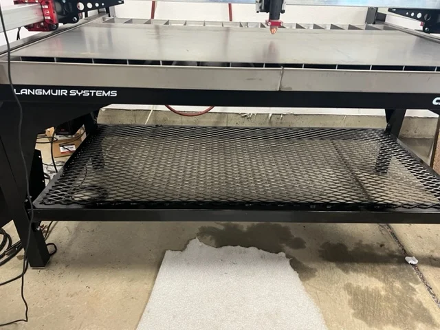

Also put a shelf under the table to hold the torch and the new computer.
I'd advise against this. Even with the water table, there is a fair amount of metallic dust from the cutting process that ends up coating everything. Put the computer in some sort of enclosure with filtered air and just have the keyboard and mouse outside. It doesn't have to be anything fancy, but it will help prolong the life of the computer.
  • Like
Reactions: PIP
There is no place in that part of the shop that is not subject to lots of metal dust. Under the table is actually probably the best place to be.

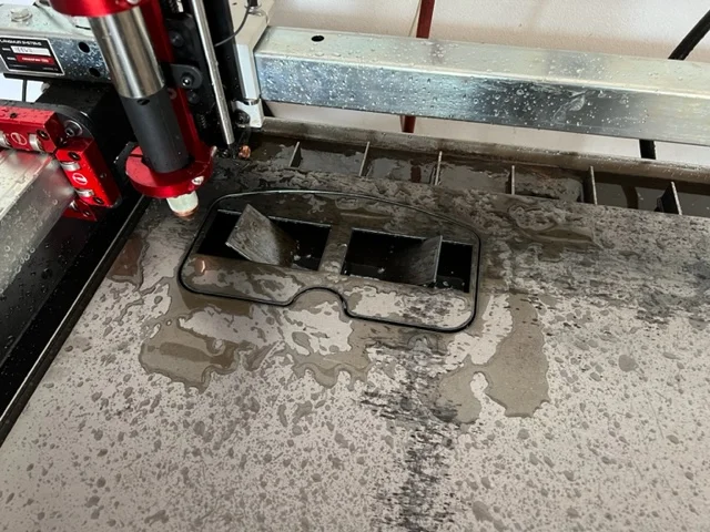

The machine is running!!!

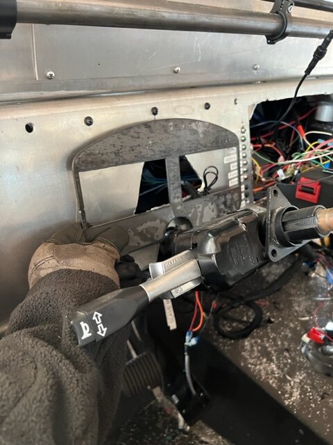

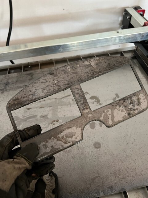

Here is the first cut - fj40 gauge cluster cut out for electric motor display panels. this test run was in steel, final product will be in aluminum.
So, been doing a lot of cutting, the thing works great. I'm getting the hang of it and the modelling software. I had been making it too complicated.

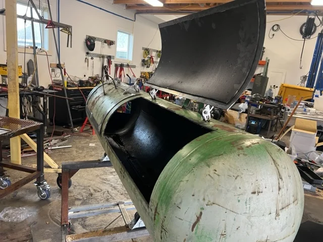

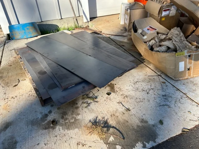

So, in preparation for make the firebox for my smoker build
I bought some 5/16 and 3/16 and 1/4" plate.
And now I realized that I can't move any of it onto the table. It's too effing heavy. I ordered one of those lifting magnets and with the tractor, if I take the ROPS off, I should be able to get a sheet into the back of the garage where the table is.
