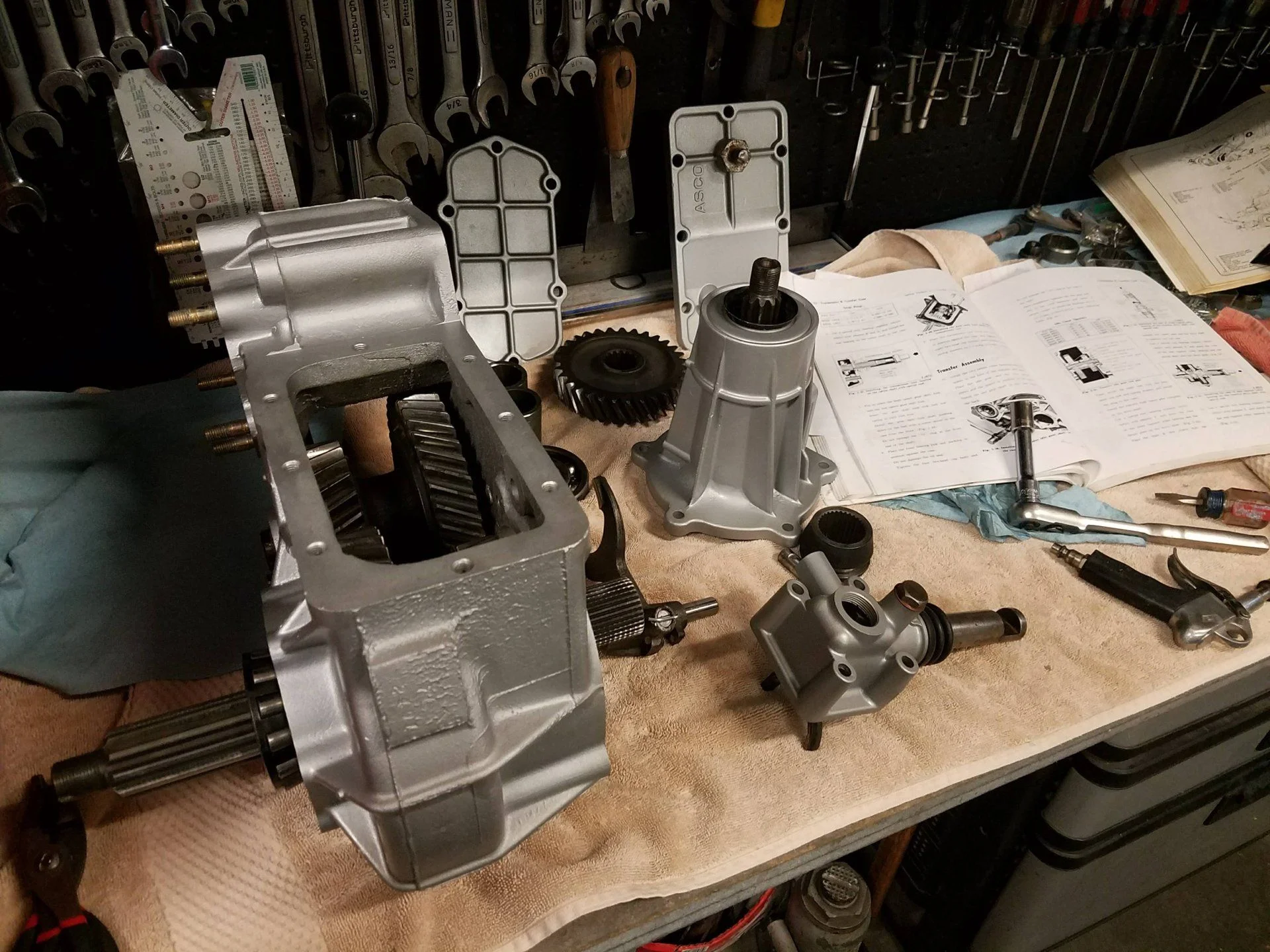

Valid point. What I've found is that aluminum parts I've beadblasted look like crap pretty quick so now i bead blast them, clean them with POR Marine Clean (strong degreaser), then either put a coat of VHT aluminum finish (if the bare cast isn't great looking), and finish them with a good high temp clear coat. The clear coat seems to be key, a $7 rattle can will keep bare metal parts looking great for a long time.
I'm going to start wrapping everything in paper and shrink wrap to seal it up, I'll test it out on something first for a few weeks and as long as nothing degrades and sticks to the painted surface, that's about all I'll do for now.
The engine in particular looks like junk, lots of nooks and crannies in there for dust and debris to settle into (think about everything that's in the air after welding and grinding for several hours - or all the dust from doing bondo work and sanding/priming). Drop cloths covering the finished chasis/drivetrain was a horrible idea, everything just floated under it and landed on the finished work.
So what I do now is restore, clear coat, wrap (loosely) and seal as much as possible.
