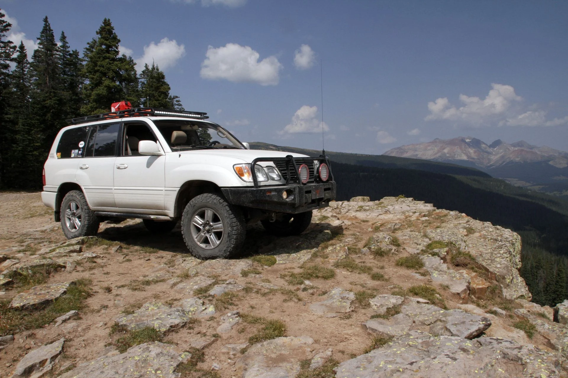

In the end, I think 16" and 18" wheels are the min and max of the appropriate range. 16" is more biased to off-road IMHO, whereas 18" is a solid balance where the majority of your driving is on-road. 33" is the overall diameter most go with as it requires no lift and really is more than fine in nearly every case. I run 275/70/18 KO2 (33" overall) and find them more than sufficient for on-road AND off-road, dry, wet, sandy or a little snow. I run all over the passes of Colorado and the desert harshness of Big Bend and South Padre Island with 40psi on-road and down to 18psi off-road. Never had an issue with denting a rim or rolling a tire (knock on wood). I like the look of a 33" overall on an 18" wheel. I think the 16" look a little blimpy. Keep in mind, your odometer is going to be wrong.....the speedometer is off (5.1 mph at 70 indicated for me). That means I have to be very cognizant of fluid and maintenance intervals as they can be off a fair bit over time.

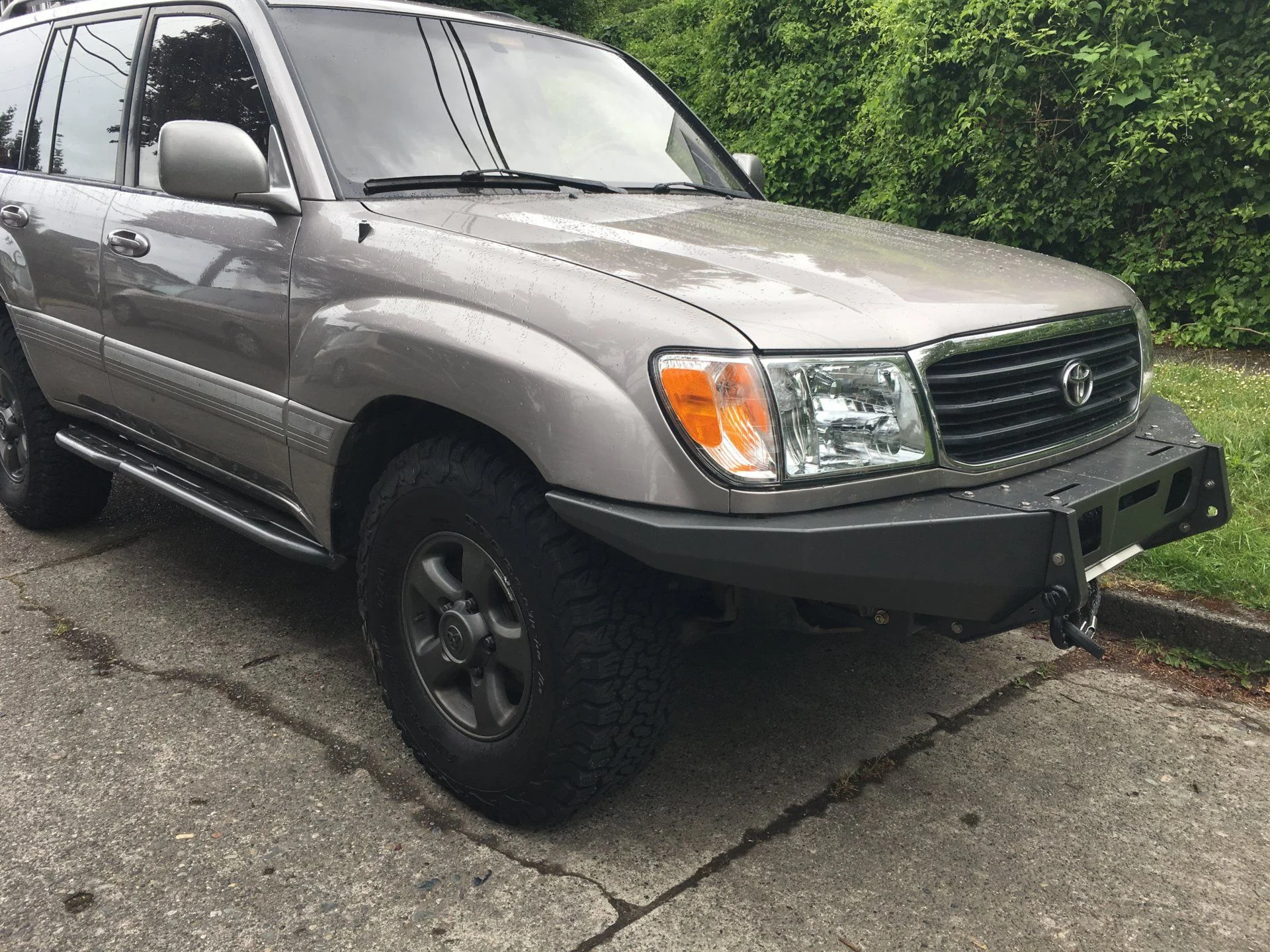

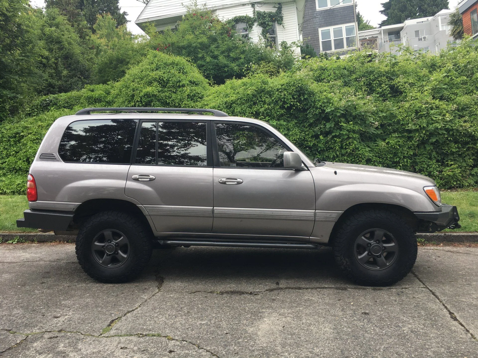

I went down this path a few months ago, decided to split all the pro's and con's mentioned above and went 17" wheels with 32" tires. My reasoning is the 100 already felt slow compared to my V8 4runner and it'll be a little easier on the 4spd transmission/drivetrain when I accelerate. Or that's what I tell myself (when I sometimes feel like I should have went 33's). ;)

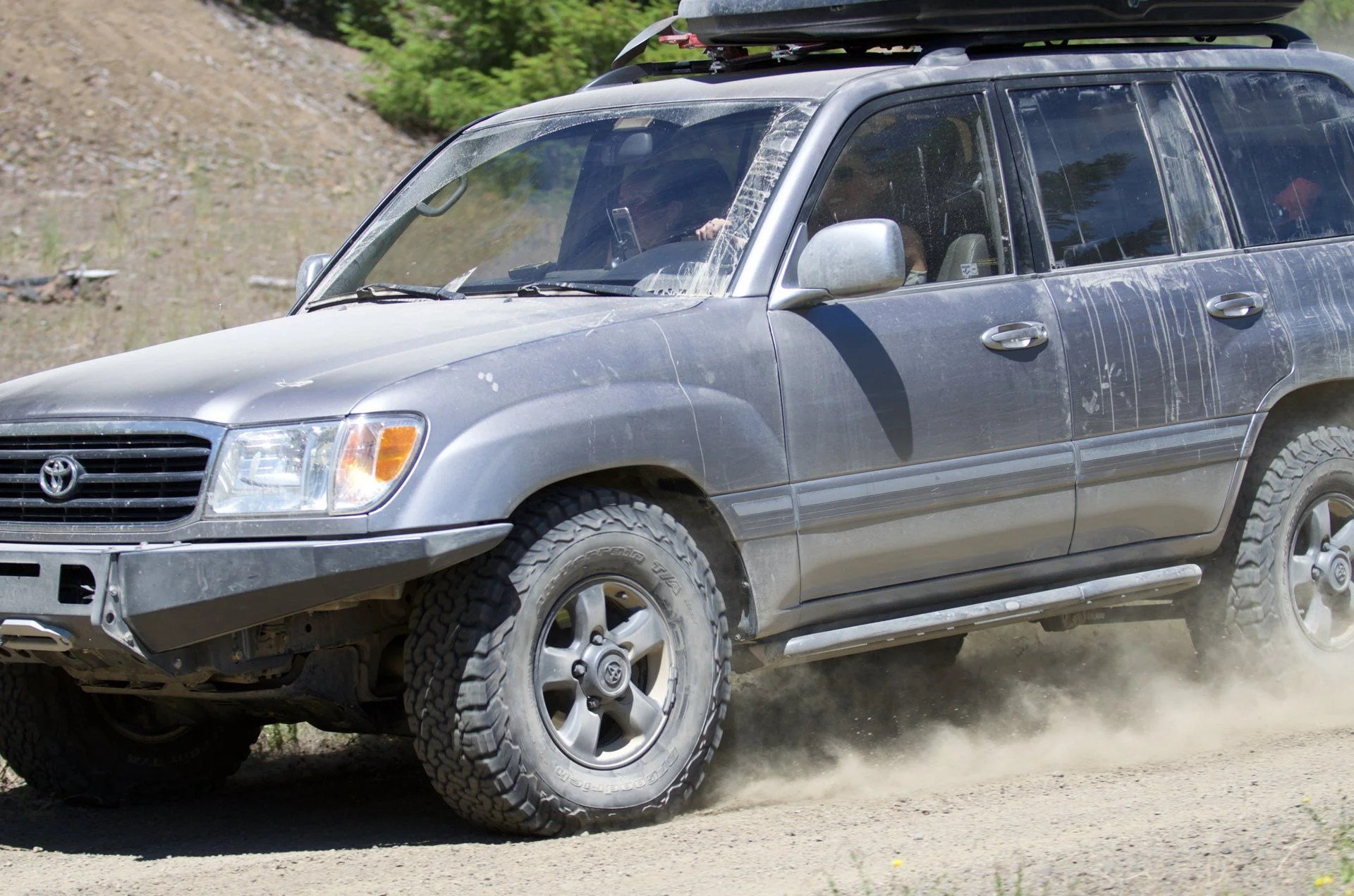

There is some good advice in here already. My 100 came with 16” wheels and brand new 305/70 mud tires on it. I traded them for 285/75 BFG ATs. They were great for three years. I’m now running Cooper ST Maxx tires in 255/85-16 and I like the skinnier 255s better in the snow.
You won’t really tell much difference in flotation between any of the 255 to 285 width tires. I’m you go to a 305 or 315 you would notice some flotation. These trucks are heavy, and do not really “float” over anything.
