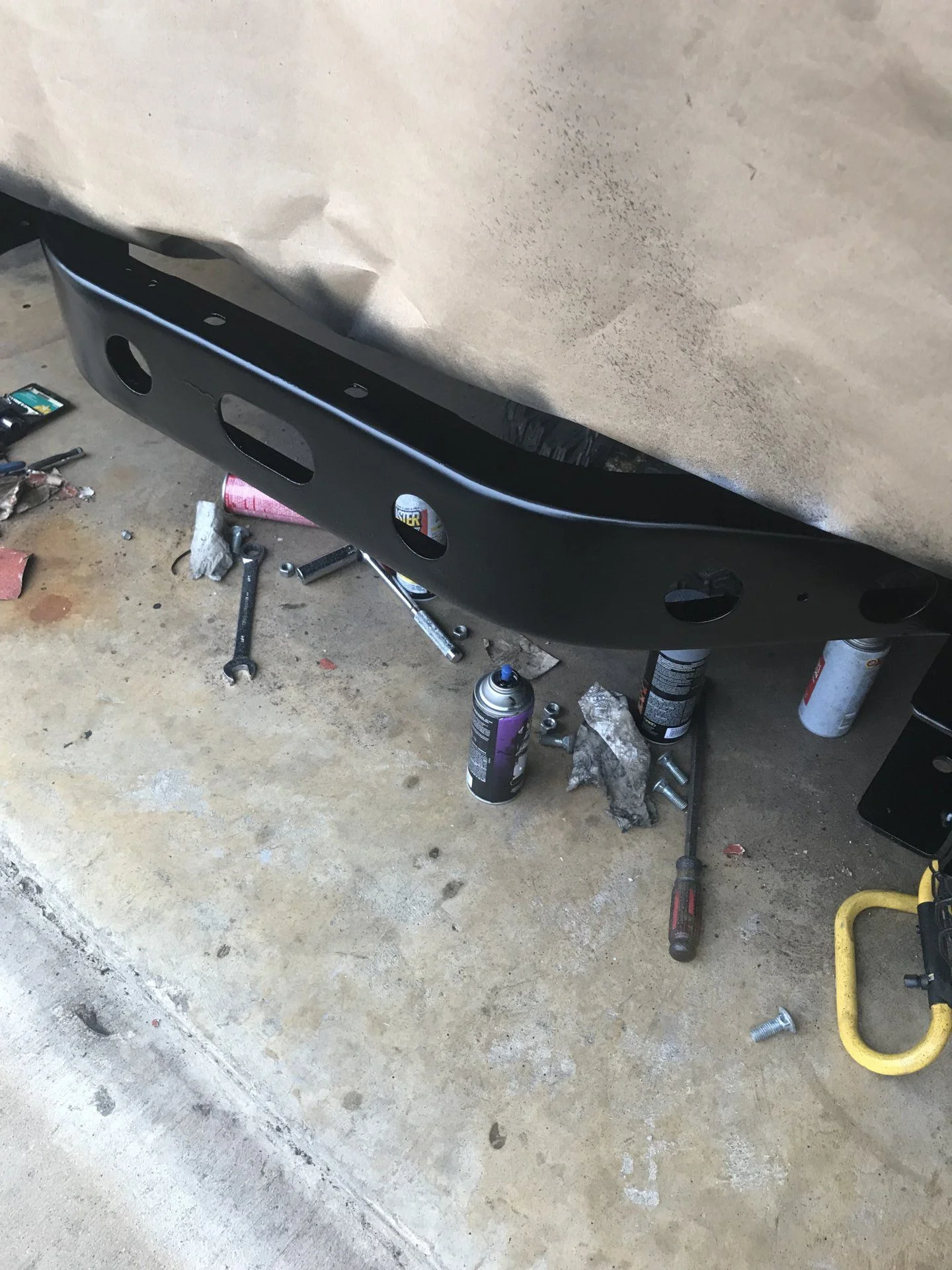

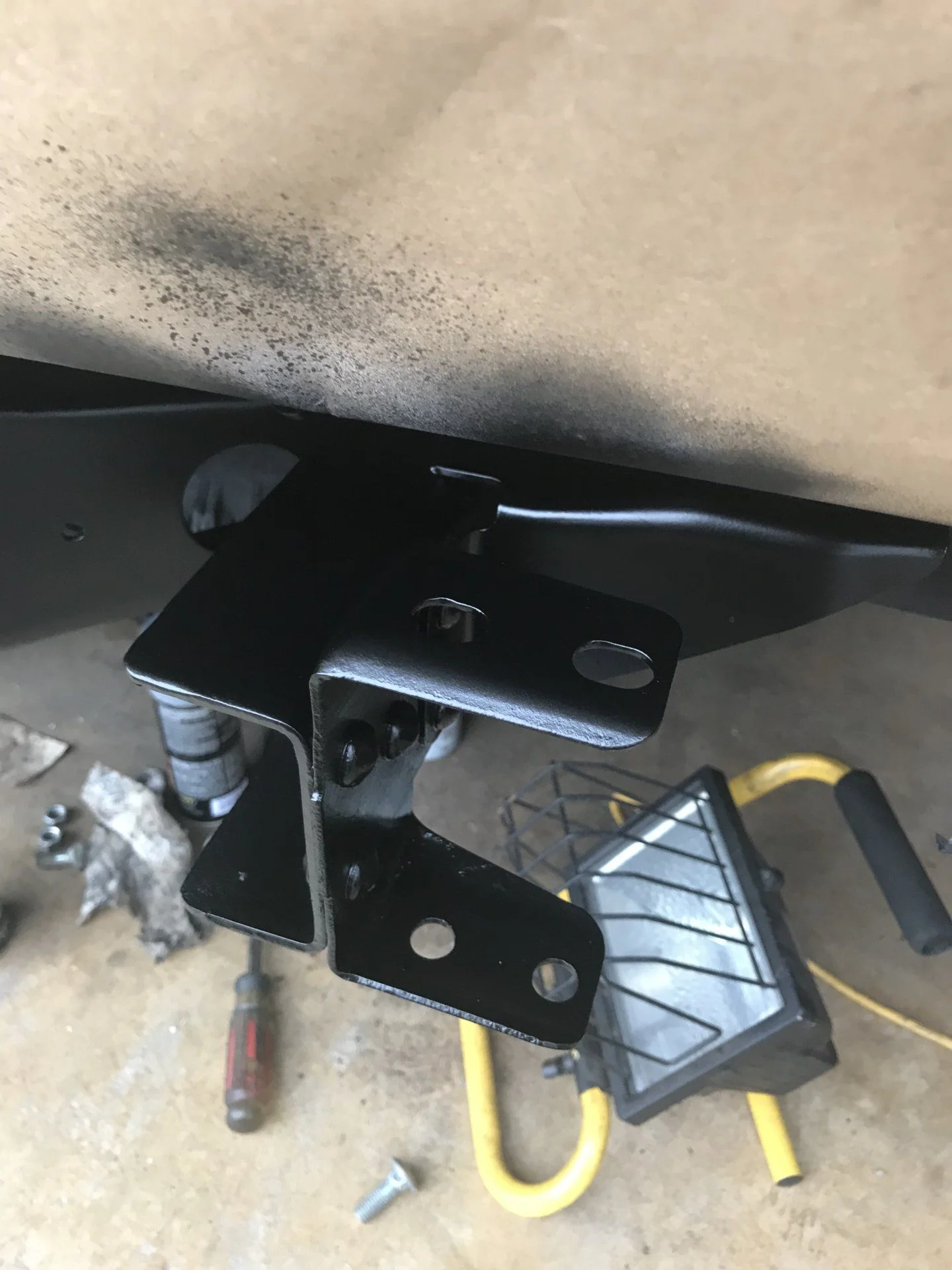

Everyone has an opinion on this. I've had excellent results. The original bumpers on my Tacoma rusted to pieces so I bought new aftermarket pieces on Rock Auto. This was a stupid amount of work but:
  • Stripped to bare steel
  • 2 coats of POR 15 all over
  • 1 coat of POR 15 Top Coat inside surfaces (normally for UV protection)
  • 2 coats of POR 15 Tie Coat primer on show surfaces - sanded
  • 2 coats of high build 2K urethane primer - sanded
  • 2 coats of ChemFlats Hot Rod matte black
Pics when the sun comes up. Not for everyone but in my opinion they will never rust again.

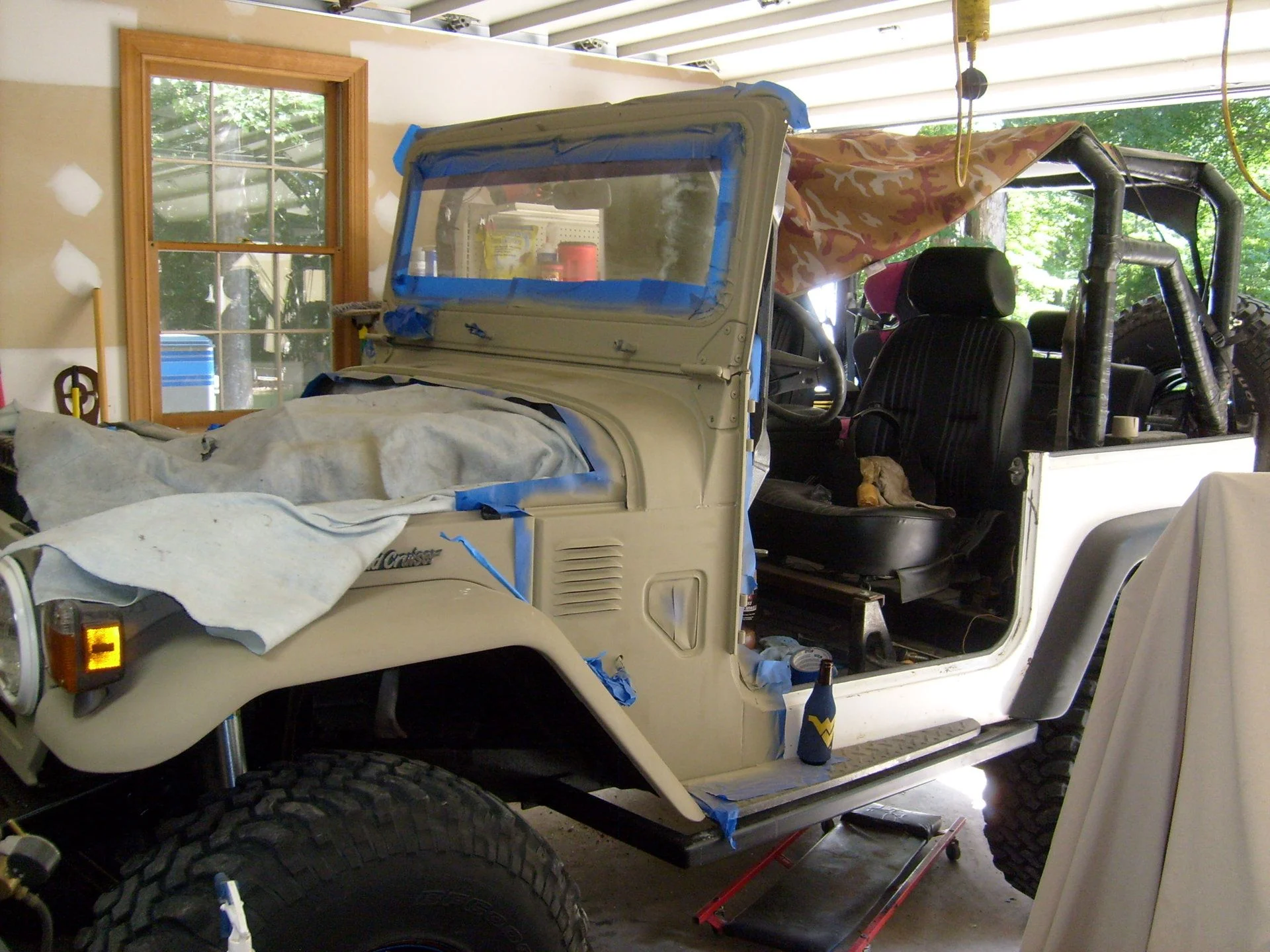

What @Shes Mad said.
I will add
1. Clean/sand/wire brush—whatever you need
2. OSPHO Rust Converter (read instructions)
3. filler
4. sand
5. glazing putty
6. sand
7. primer
8. wet sand
9. top coat
10. want to get fancy wet sand this again with a super fin grit and then polish and wax.
Unless your 60 has been resprayed with a clear coat. You have a single stage paint. Want to gt a close match, check out places like autotouchup they do a pretty good job.
