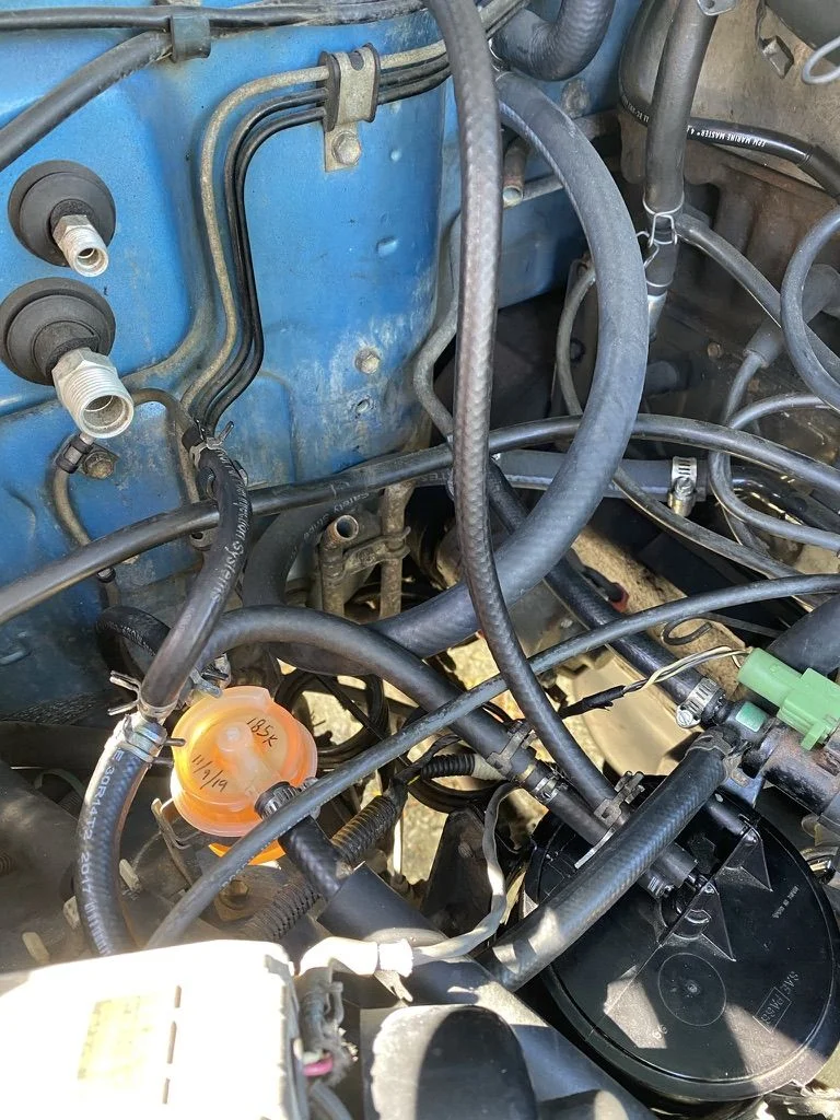

Regular air port with dust cap:
Setup with tank and carb vent combined:
All of the ports on the top of my gm canister are used for the setup with the FJ60 carb. Take a look at the emissions manual and it shows the correct routing. I can take a pic tomorrow when I am back with my cruiser. The top port is probably venting fumes that should otherwise be burned up by the carb. If nothing else, plug that fitting. The canister vent is built into the bottom.
IIRC that port that you are not using I connected to the carburetor canister intake.
