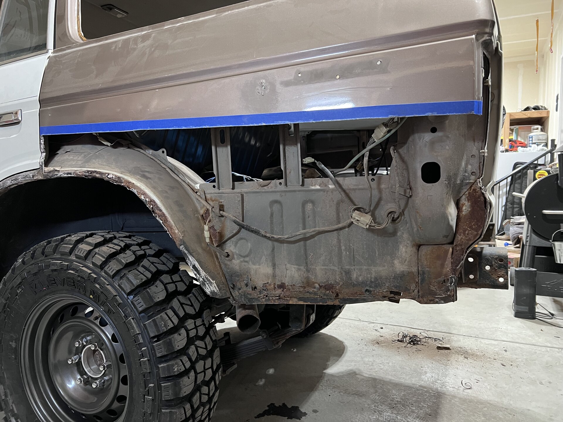

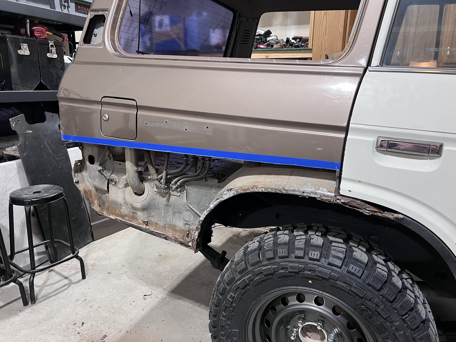

Tonight I will start stripping the interior to get prepped for chopping the rear quarters. Hoping to start that process this weekend, so any advice would be greatly appreciated. The entire quarters are very solid on the donor, so I think I'm planning on pulling the rear windows out and cutting them up in the pillars to lower the risk of warping the metal when I weld the new ones in place. Anybody done this and could point me toward a thread I can check out? I can't seem to find a very comprehensive one. Still learning how to navigate this forum efficiently.

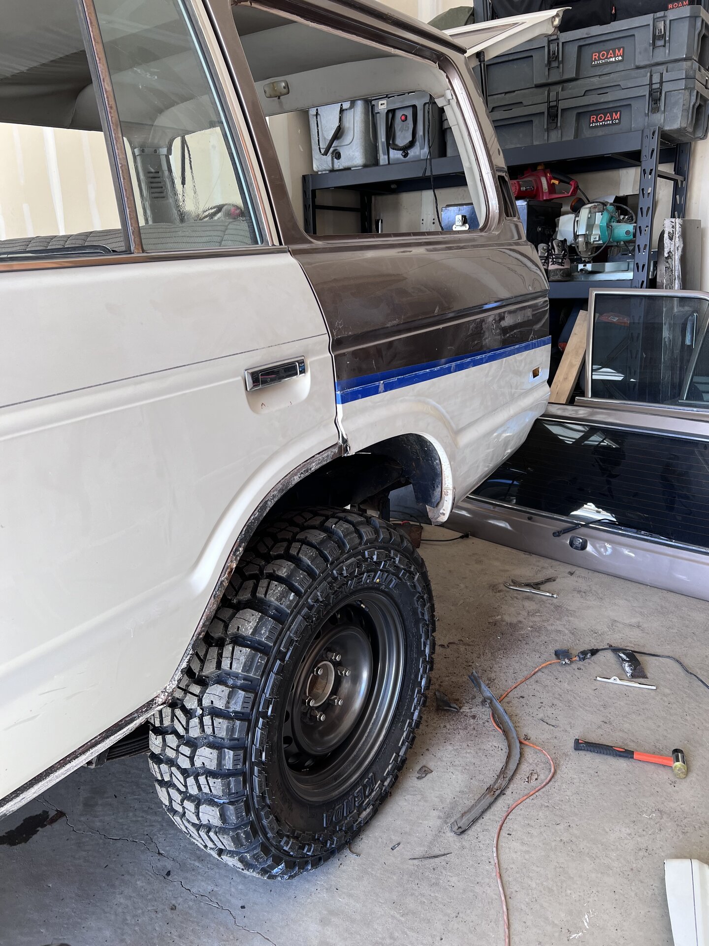

Got the windows all pulled out to start cutting the rear quarters out.
I was originally planning on cutting up in the pillars close to where the green line is roughly on the photo below, but the window sills on the donor ended up being rotten. What’s my next best bet? It would be nice to cut somewhere along the blue line-ish, but I’m worried about having that much welding on the exterior face of the panel. Any thoughts?
Decided to go with a similar cut to the blue line from the last post, but kept the cut straight to avoid as much warping as possible.
Cut the quarters from the donor a little on the sloppy side, leaving more material for me to trim down once the quarter is off the vehicle. It was a lot easier to make precise cuts once the new quarters were off.

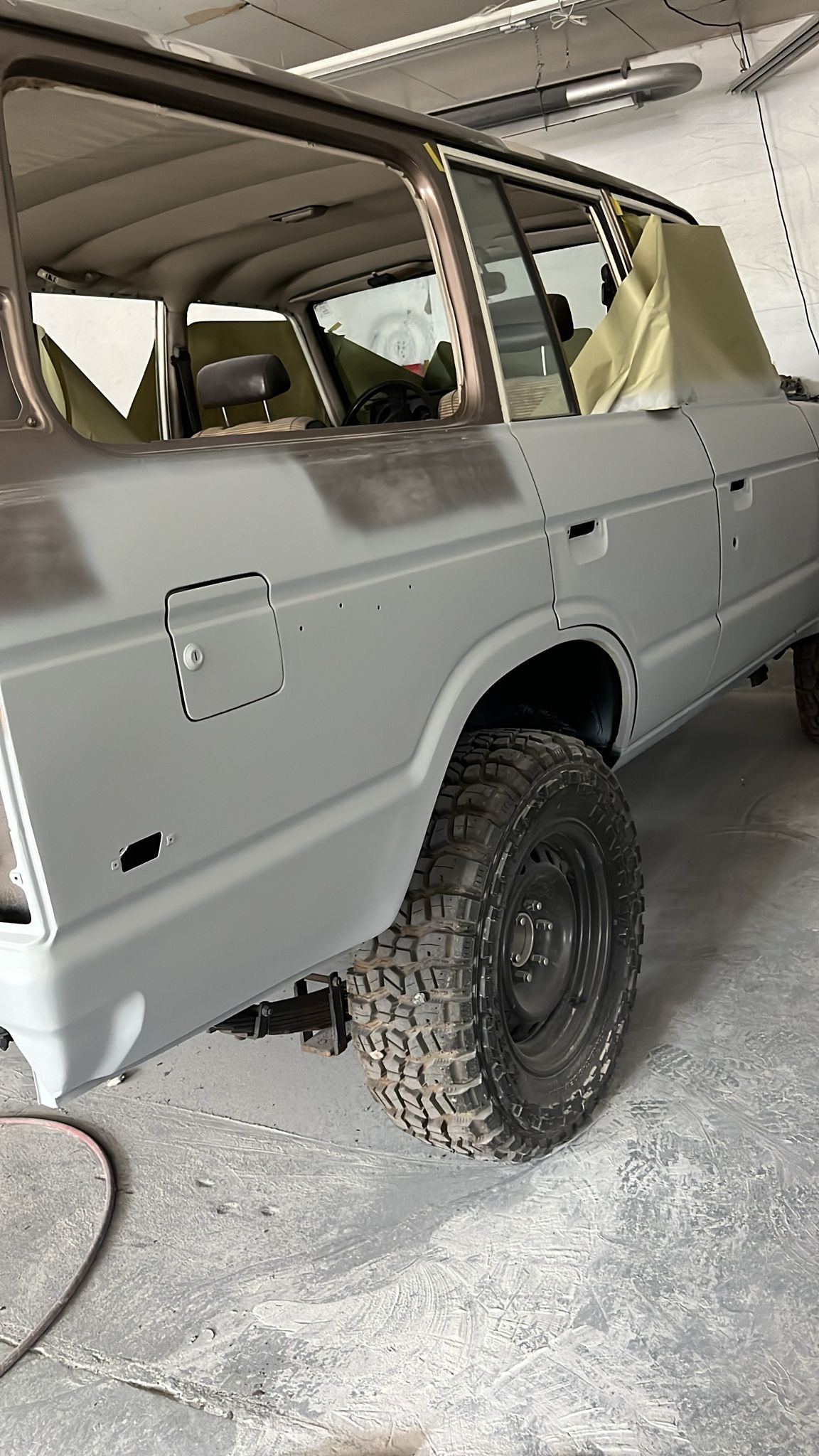

After only touching the rig a few times over the next couple months, in July I finally realized I wasn't going to be able to enjoy this thing before the weather gets bad this year if I didn't hire some help. Ended up finding a local shop to finish out the welding and to finalize prep and paint. I cut out the rocker panels from the donor rig, threw them in the back for them to weld in, and sent them on their way.
