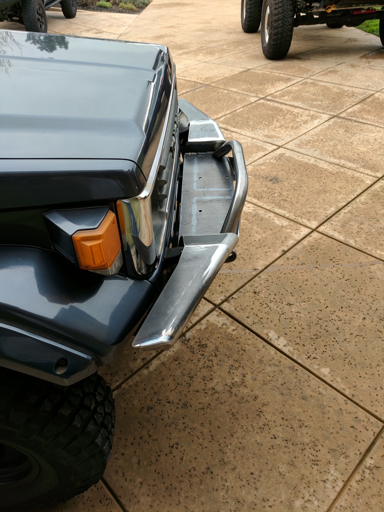

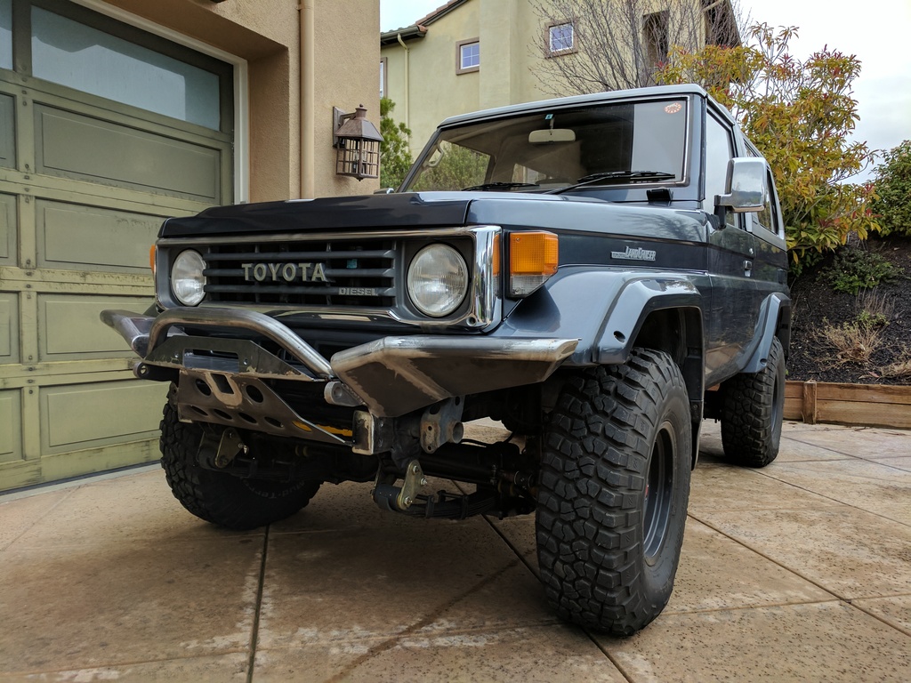

Started working on my front bumper today. Hoping to get it finished before I go back to work on Tuesday. :) The bumper is a 4x4Labs DIY front bumper kit. Luke is now producing these bumpers in kit and built form. I love to build things, so went for the DIY kit. I also have a rear kit that I will get to eventually.
Here's the parts that are included in the bumper kit...
I got some help from my son. He's really started to enjoy building things and working on his car.
First things first... the park bench of a front bumper had to go...
There was a little rust and some left over dirt from who knows when.
We started by making the frame horn mounts. Had to open up the holes a little in order to make things fit.
Then we tacked the winch tray and cross member into place. Then assembled the wings and got one installed.
Got the other wing on and decided to call it a day... more tomorrow.
Today was a lot of welding followed by cleanup. Got the bumper fully welded. Took my time and didn't get it too hot. It stayed nice and straight...No warping. I did experience one casualty today. . My Makita grinder of 15 years gave up the ghost. Shot out a nice display of sparks and that was it.
I did personalize the bumper a little by cutting down the front hoop that 4x4labs supplies. I wasn't a fan of the tube being mounted on the top corners. Turned out nice and low profile...
Tomorrow I'm going to bend up a new hoop and see if I can't personalize the bumper a little more. Now I'm off to home depot to pick up a new angle grinder.
Played with building a new hoop that went up from the angled sides and crossed over at a height equal to the middle of the headlights. Tilted it forward, stood it up straight, connected tubes to the lower hoop, but it all looked like crap. So for now... I'm sticking with the small low profile single hoop. Might consider adding some 1" straight side tubes, but I really like the small hoop the best so far. Everything I tried just looked like too much on the front of the truck.
After playing around with different hoops I cleaned up the lower frame section and got it painted.
Then I started spraying on some flat black rustoleum pro. I will get the bumper powder coated once I finish the rear bumper and the sliders.
I did put a small notch in the top plate for the headlight washers. The bumper just clears the headlight washers, but they would spray into the backside of the bumper without the notch.
And finally got it setting on the truck so I could finish painting. I'll let it dry until tomorrow then I'll install it for good.
I like it, but with no winch I would want to close up the center part better.
I'm not sure if I will put a winch on this truck or not. I'd probably never use it. Maybe the next owner will. I'm still thinking about how to close up the lower section a little more, I like the way it turned out, but I also like to put my own spin on things and I haven't really done that with this bumper...yet. :)
