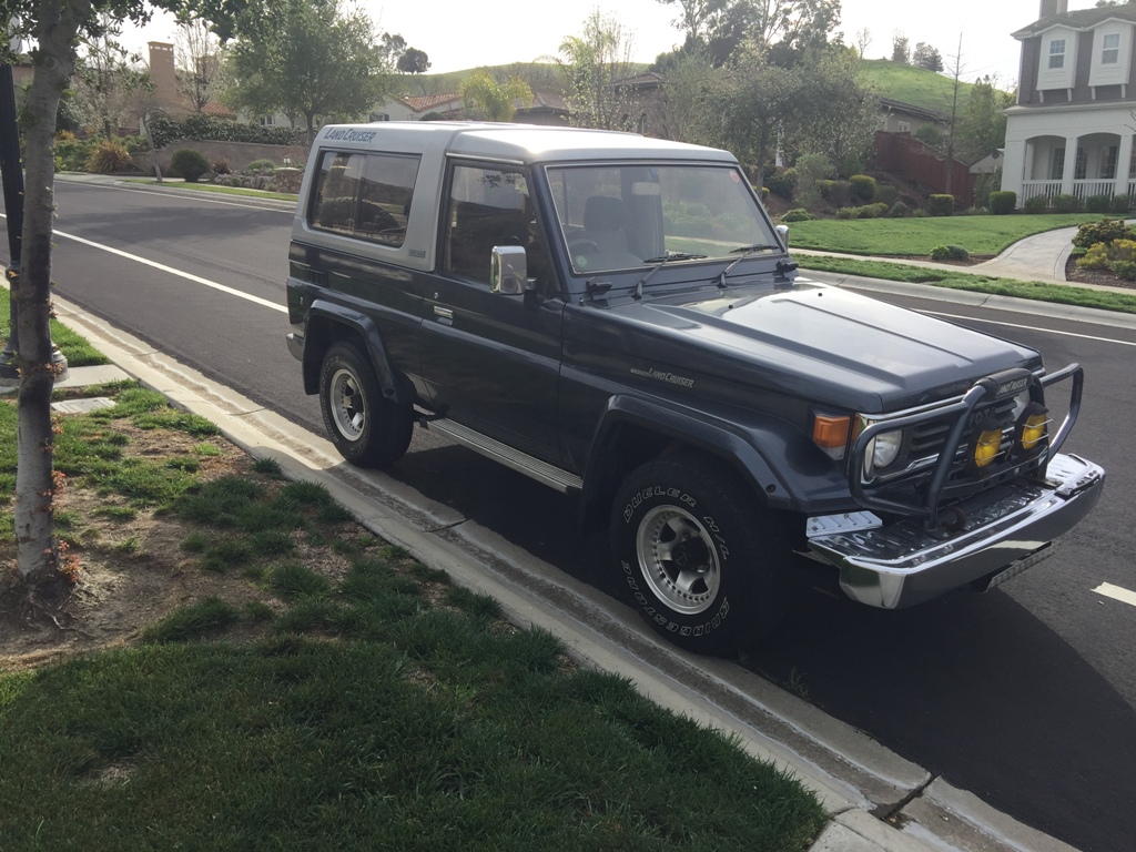

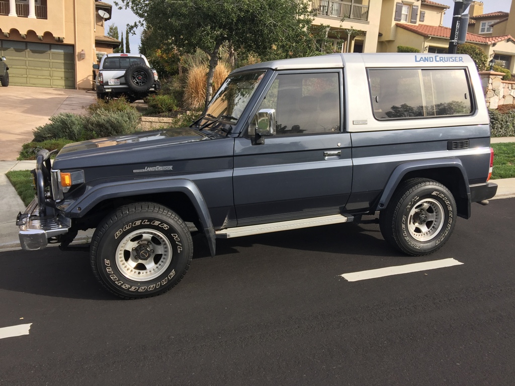

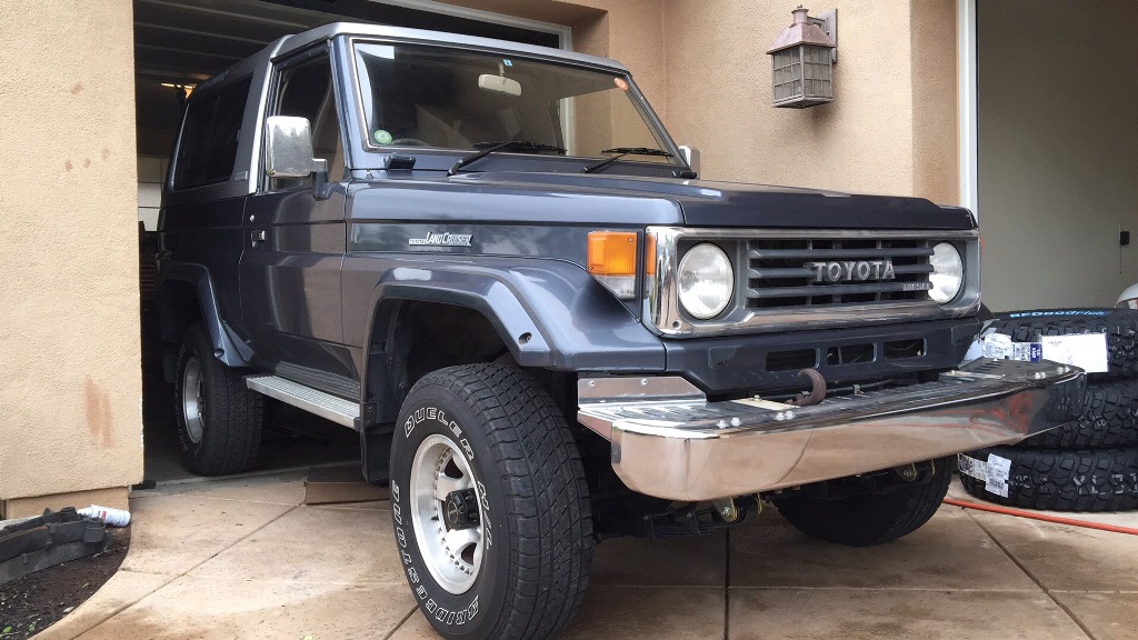

I've built a few 40's and I've always liked the 70 Series, so I decide the time was right to pick one up. Many thanks to @SteveJackson at Land Cruisers Direct for answering a million questions and helping me decide on a truck. I bought the HZJ73 in February of 2016 from Land Cruisers Direct and it landed at my place a few weeks later. Steve was awesome to deal with and I am really enjoying the truck. I was concerned about registering it in California, but to be honest it was a very simple process. This truck will be my daily driver and weekend warrior for easy camping and fishing trips. I already have a dedicated trail rig for the Rubicon weekends. Anyway... I have a fair amount to learn about the 70 Series, but I intend to keep this thread current as I learn and improve the truck.
Here are a few pictures of the truck on the day it arrived.

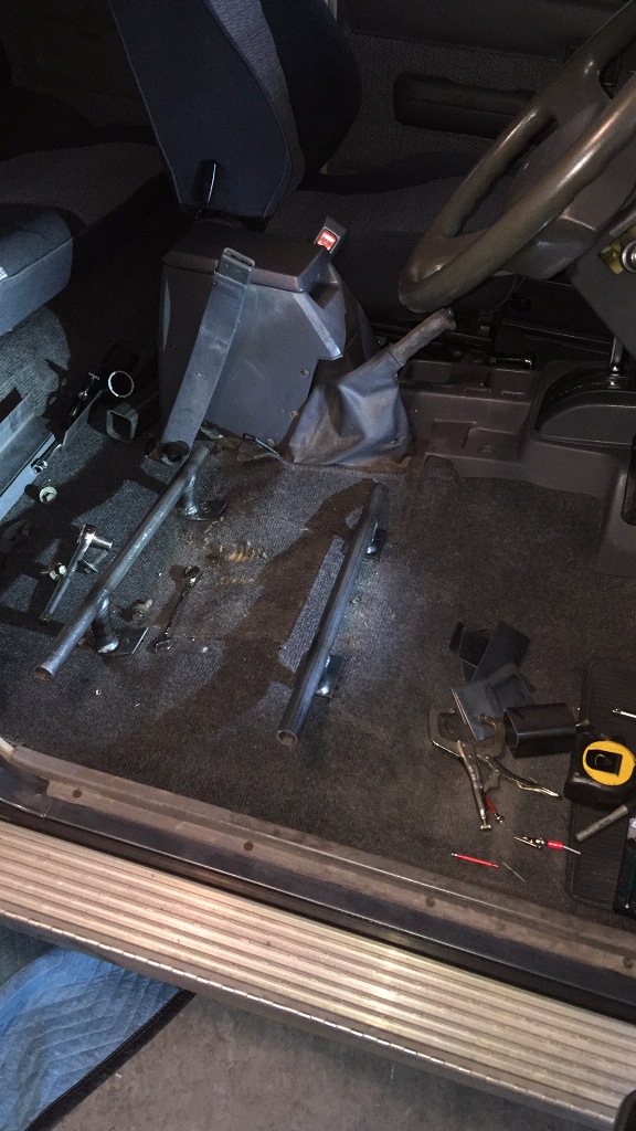

After pulling the factory seats out I started building a new seat mount. I used 1" hrew tubing that I had in the garage and some plate and angle. Started by making the mounting points, then notched some tube for the uprights and eventually ended up with something workable.
Here is the start of the seat brackets...
Ended up with this...
Mounted to the bottom of the seat...
And finally the seats installed...

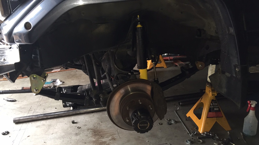

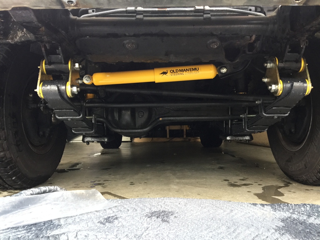

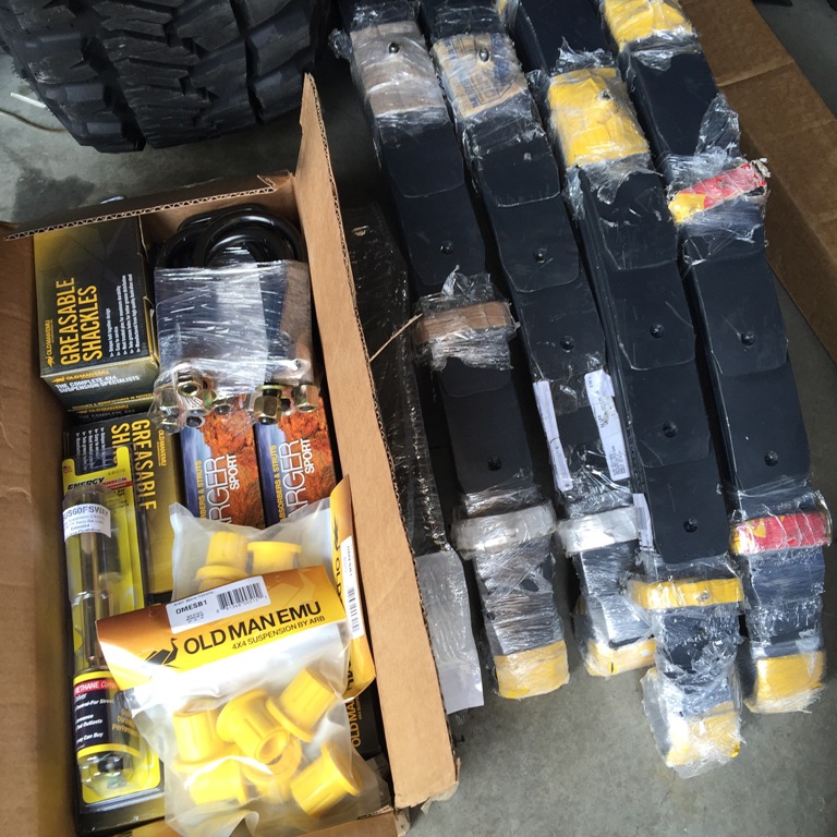

Yesterday I installed an OME lift kit. I went with heavy front springs and medium rear springs. I will be adding front and rear bumpers and I plan to make some sliders. Cruiser Outfitters hooked me up with a complete 70 OME setup.
The goods...

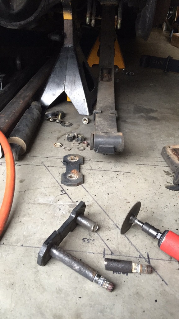

The rear shackles were fun... I didn't want to drop the fuel tank, so out came the cut off wheel. I ended up using the cut off wheel a few times to persuade things to come off. :)
I've never installed a complete OME kit. I've installed a number of newer vehicle kits with coilovers or coil springs. It was pretty easy... I did soak everything with pb blaster the night before. Here is the front setup installed.

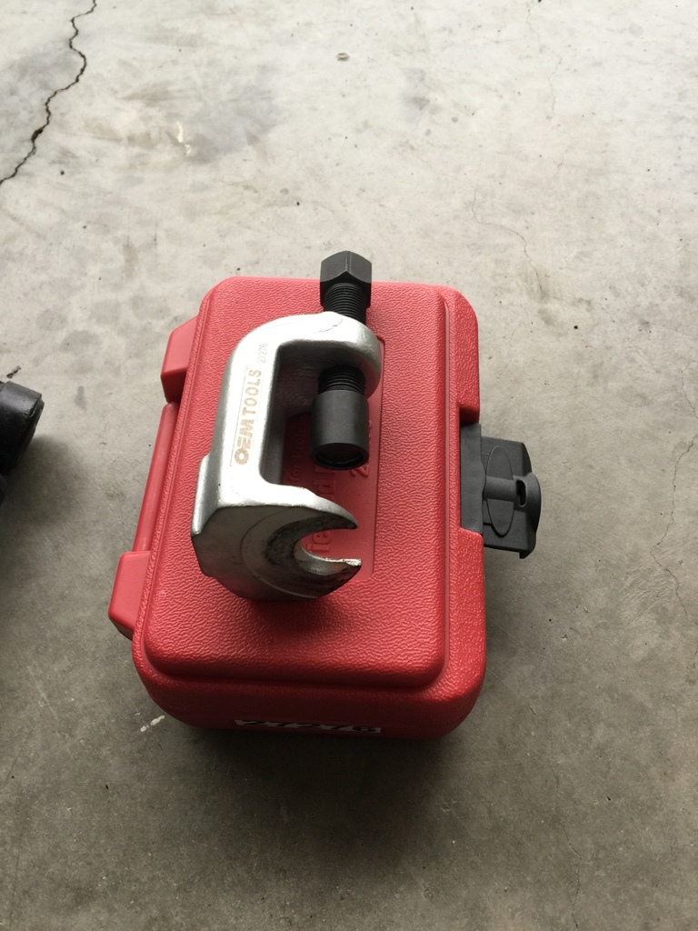

The steering stabilizer didn't want to come off. I ran down to autozone and borrowed a tie rod end puller. Worked like a charm... then I installed the new OME stabilizer.

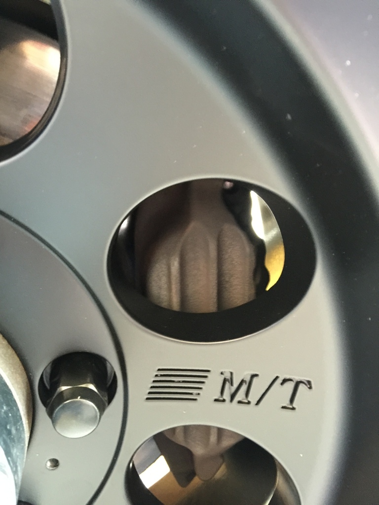

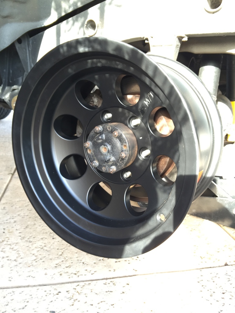

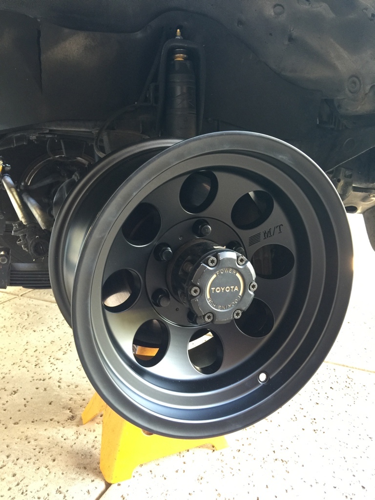

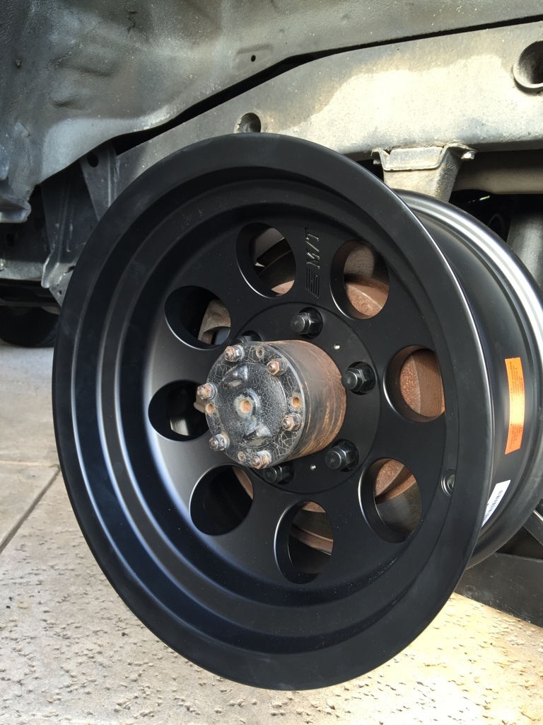

Mickey Thompson Classic III in black 15x8 with 3 5/8 backspacing

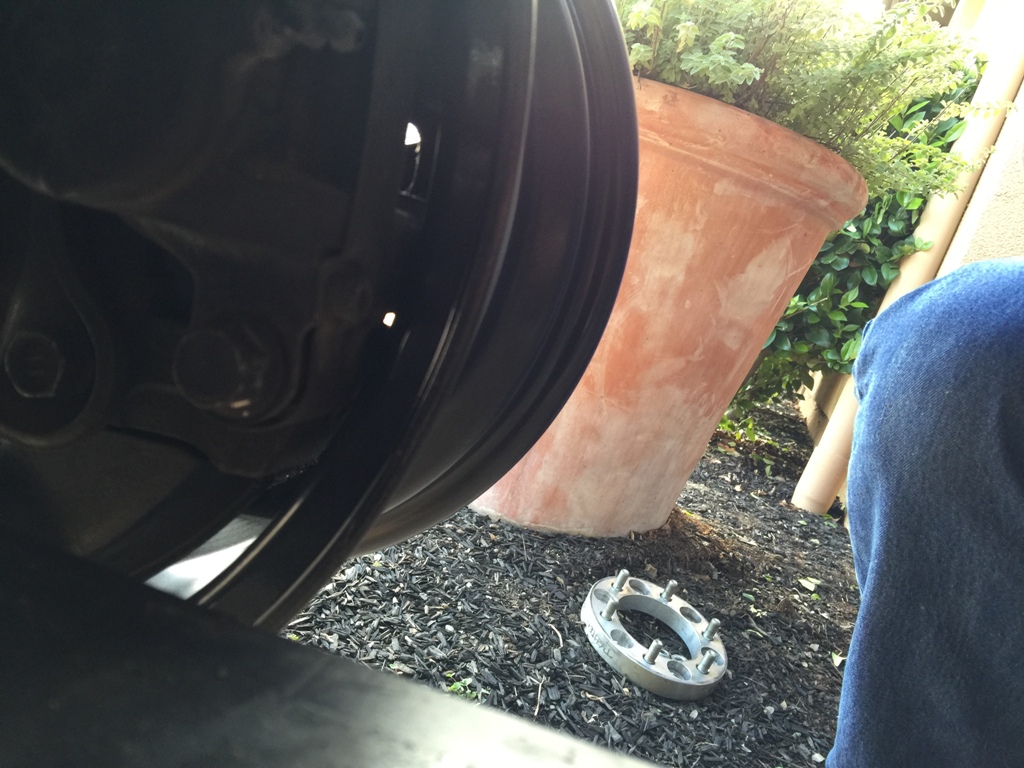

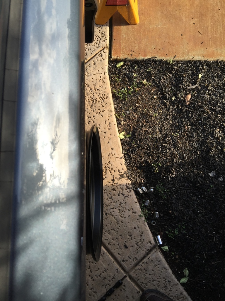

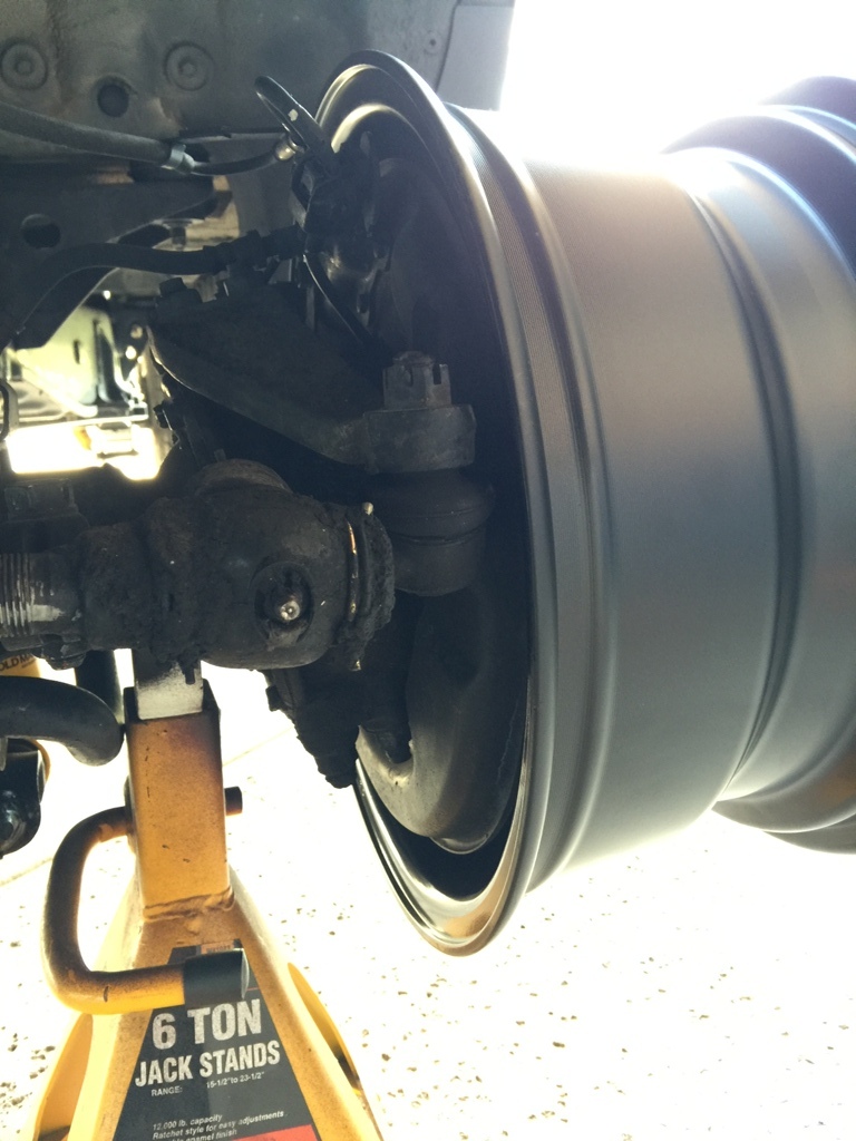

Brown was nice enough to deliver 3 of the 5 Mickey Thompson wheels today. :) Can't do much with 3 wheels other that test fit them and make sure they clear. Good thing... since they didn't clear the front calipers. I had a 1/4" wheel spacer in the garage, so I threw it on there and they now they clear the calipers. The wheel studs are too short (as expected) with the 1/4" spacer. I have some 1" wheel spacers in the garage that I will probably run for now. At least until I can pull the hubs apart and figure out the dimensions on the wheel studs and find some longer ones. We did the longer wheel studs and 1/4" spacer on my son's Tacoma and it worked great. I think we bought some Lexus wheels studs that had the same shanks, but were ~5mm longer.
I think they'll look great once tires are mounted...
Tie rod clears fine with and without any spacers... (pic is with 1/4" spacer)
Front caliper clears by about 3/16" with the 1/4" spacer...

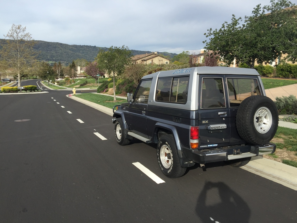

Rear wheels:
The wheels fit on the rear without any issues. The caliper is VERY close, but no closer than the wheels that I took off.
Here is the rear brake caliper and how it clears. Not a whole lot of room. Probably no more than 3/16-1/4" clearance to the wheel surface.
I decided to throw a 1" wheel spacer on the rear. I like the stance WAY better and the clearance is MUCH improved.
And the best part is the lip of the wheel is now almost flush with the fender flares. Maybe I'll run 1" spacers all the way around for now.... hmmm.

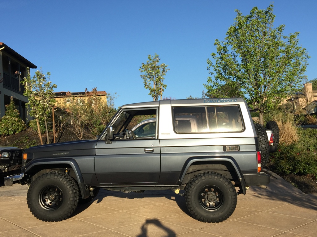

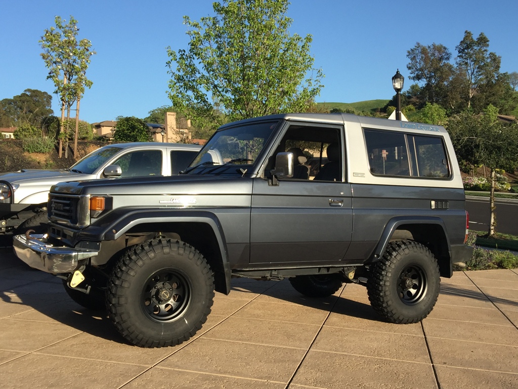

I had time to drop the tires and wheels at the tire shop today. I installed the 1" spacers on the front. I like the stance, so much so that I ordered a set for the rear. :)

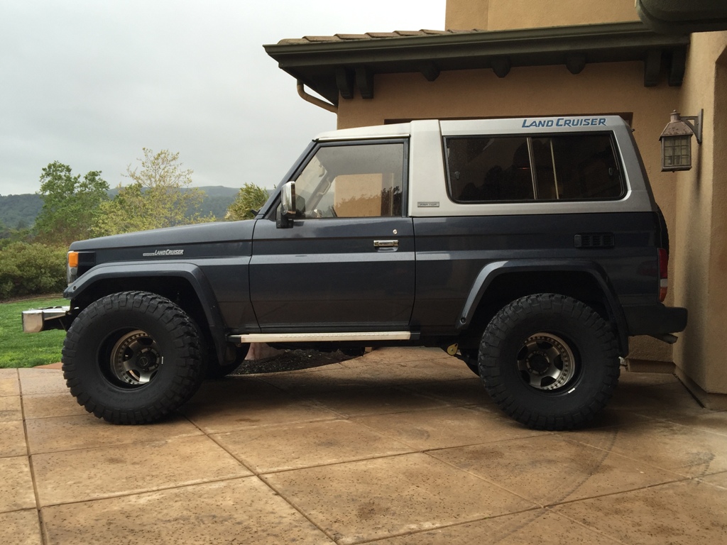

Here are a few shots of the truck with the wheels installed. It's starting to look like a trail rig. I really like the MT wheels. Very nice quality and not super expensive.

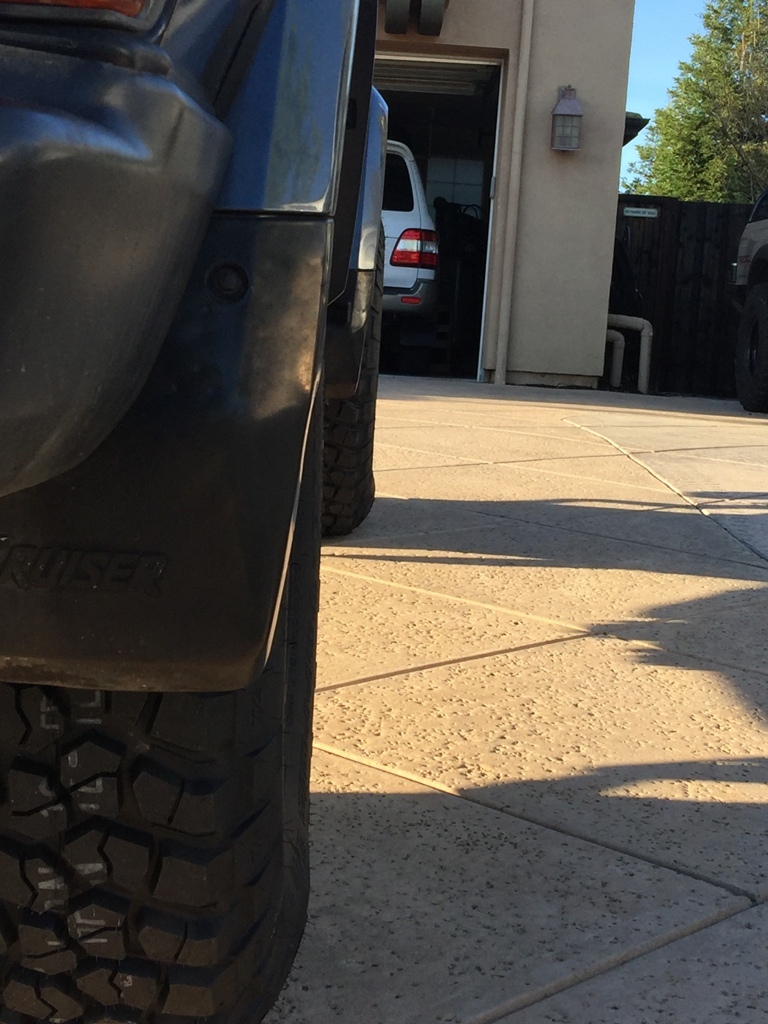

Here is a picture to show the difference in the stance front to rear with the 1" spacers in front and nothing in the rear. Note the front tires are just outside the fender flares while the rear is about 2" inside the fender flares.

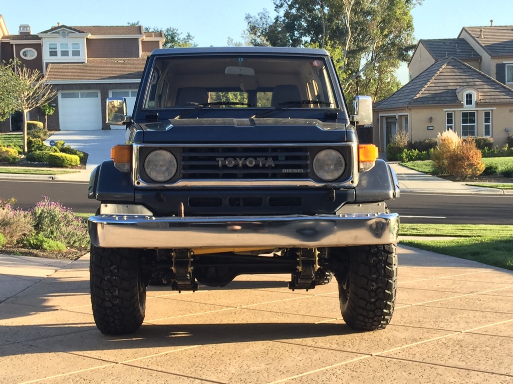

Last one to show the stance from the front...
