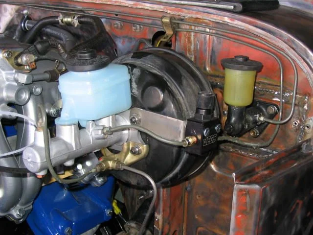

Pic of the brake system. FJ62 booster, FZJ80 master cylinder.
attachment.php

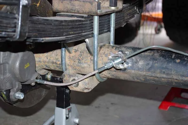

Plumbing the rear disk brakes.
attachment.php

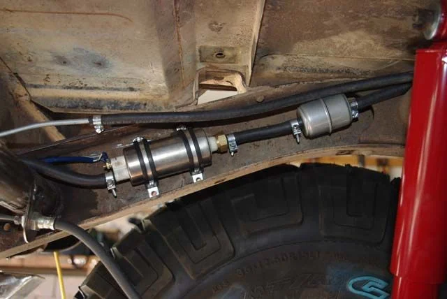

Plumbing the fuel pump and running the lines.
attachment.php
attachment.php

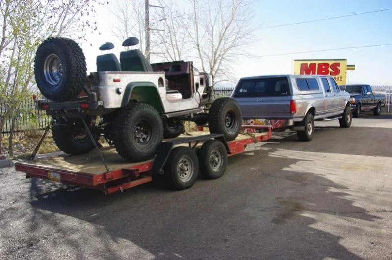

Paint.
The project on the trailer at the muffler shop.
attachment.php

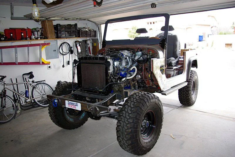

As it sits now in the garage.
attachment.php

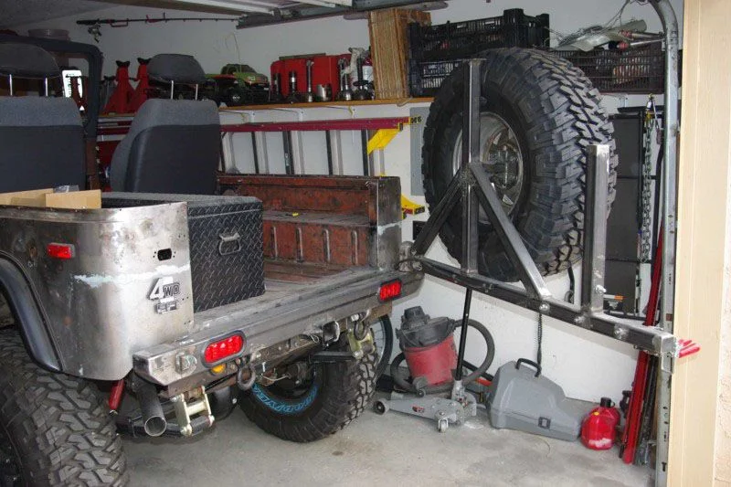

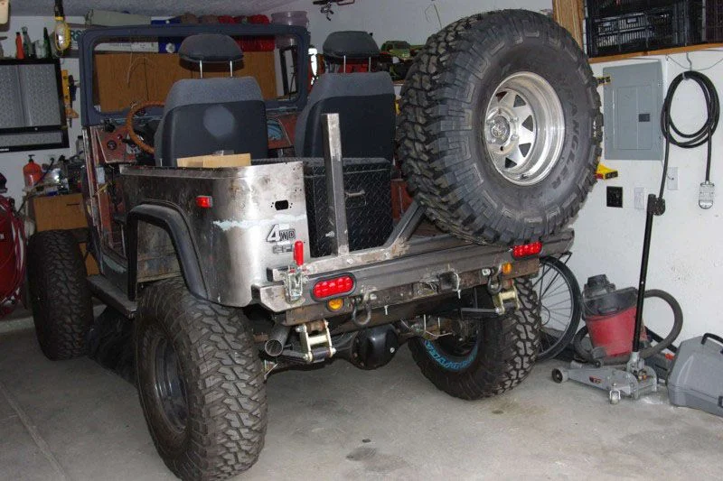

The rear bumper open and closed. The post with nothing on it is for a removable gas carrier.
attachment.php
attachment.php
