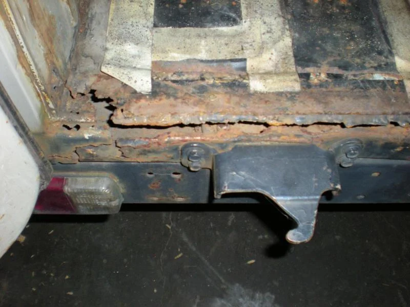

Just aquired a 1975 FJ40 has rust on rear sill and on floor under driver seat. Can panels be purchased on floor, or do I just need to look for a complete tub. Also looking to upgrade to power steering, saw a kit that is $399+ steering box from '79-85 pick-up anyone installed this, it almost looks like I can get that steering pump anywhere. Any ideas???:)
If the worst your tub has is a rusted rear sill and driver floor then consider yourself in good shape. There are quite a few vendors supplying part to repair these area's. You can start with places like Pacol, Cruiser Solution and Cool Cruisers, just to name a few. Like Saintdog said, the search button on this website is your friend.

You probably do not need an entire tub...but you may be chasing rust forever. Welcome to the madness!

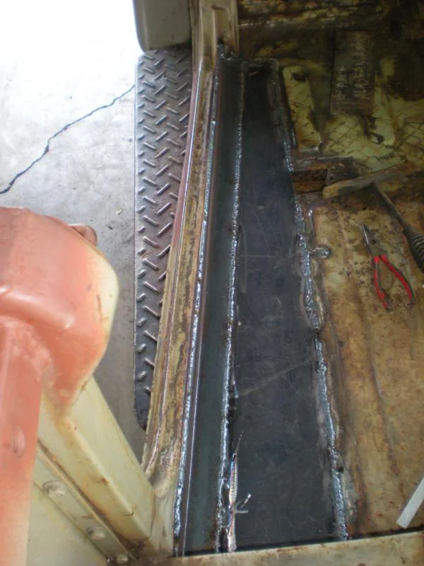

The pics show the rear sill before and the new one we fabbed.:cool:
