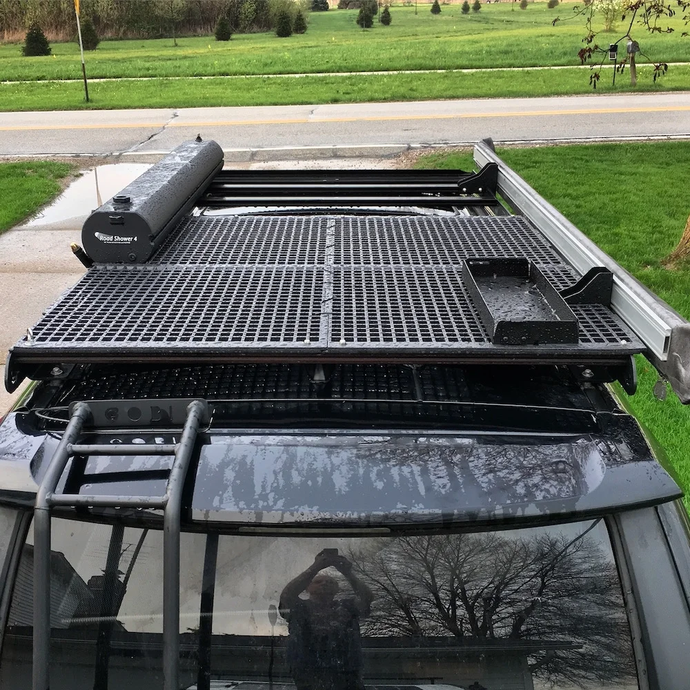

I don’t have a prinsu, but can fit #4 5 gal scepter cans and a large firewood bin on my yakama skinny warrior. Could probably attach a skinny warrior to your rack?
