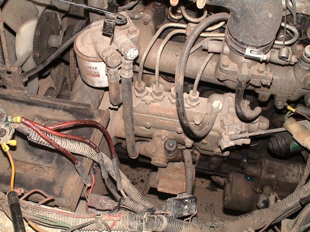

heres a pic of the donor vehicle..

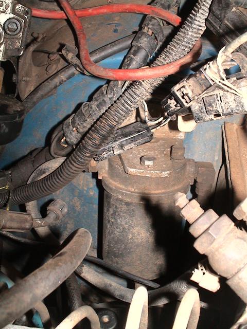

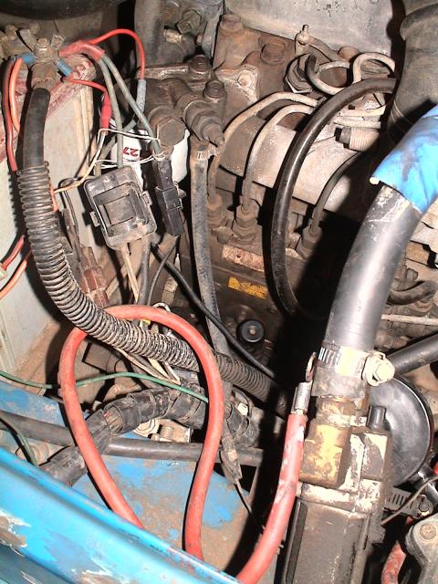

and the one on my blue 40..
you can kind of see where it disappears from leaving the primer pump then comes from the water seperator to the filter..
