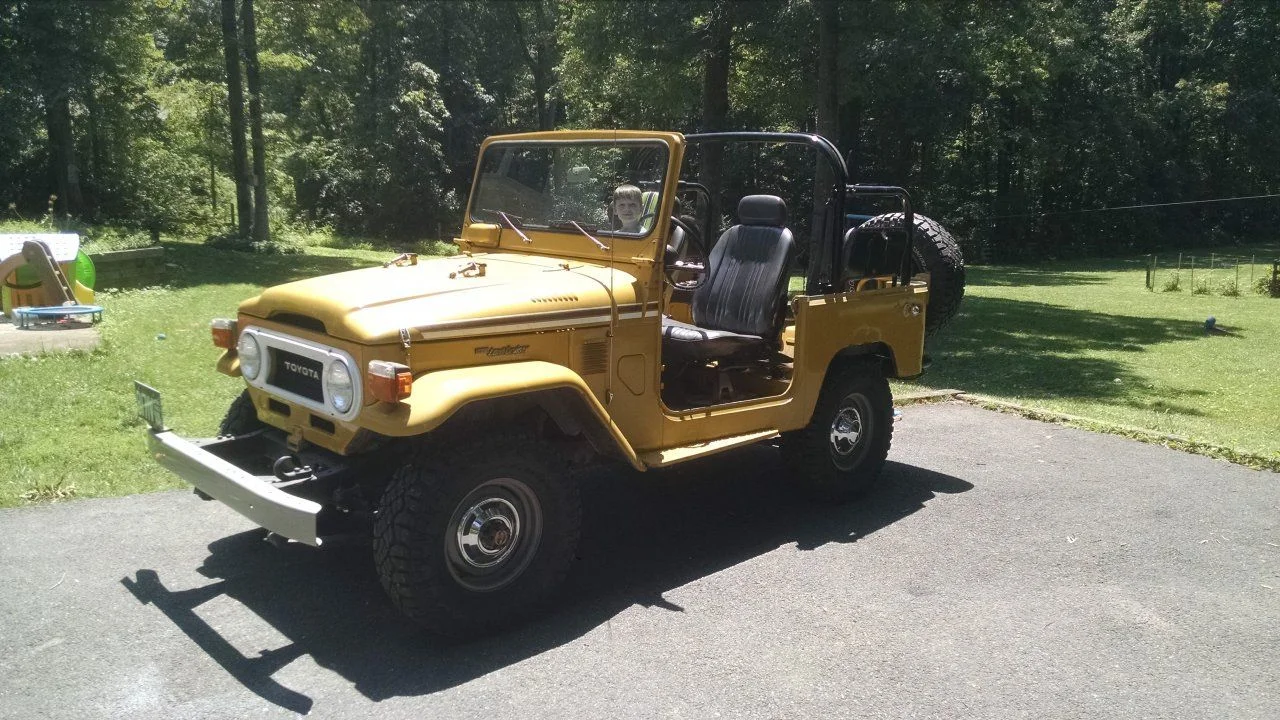

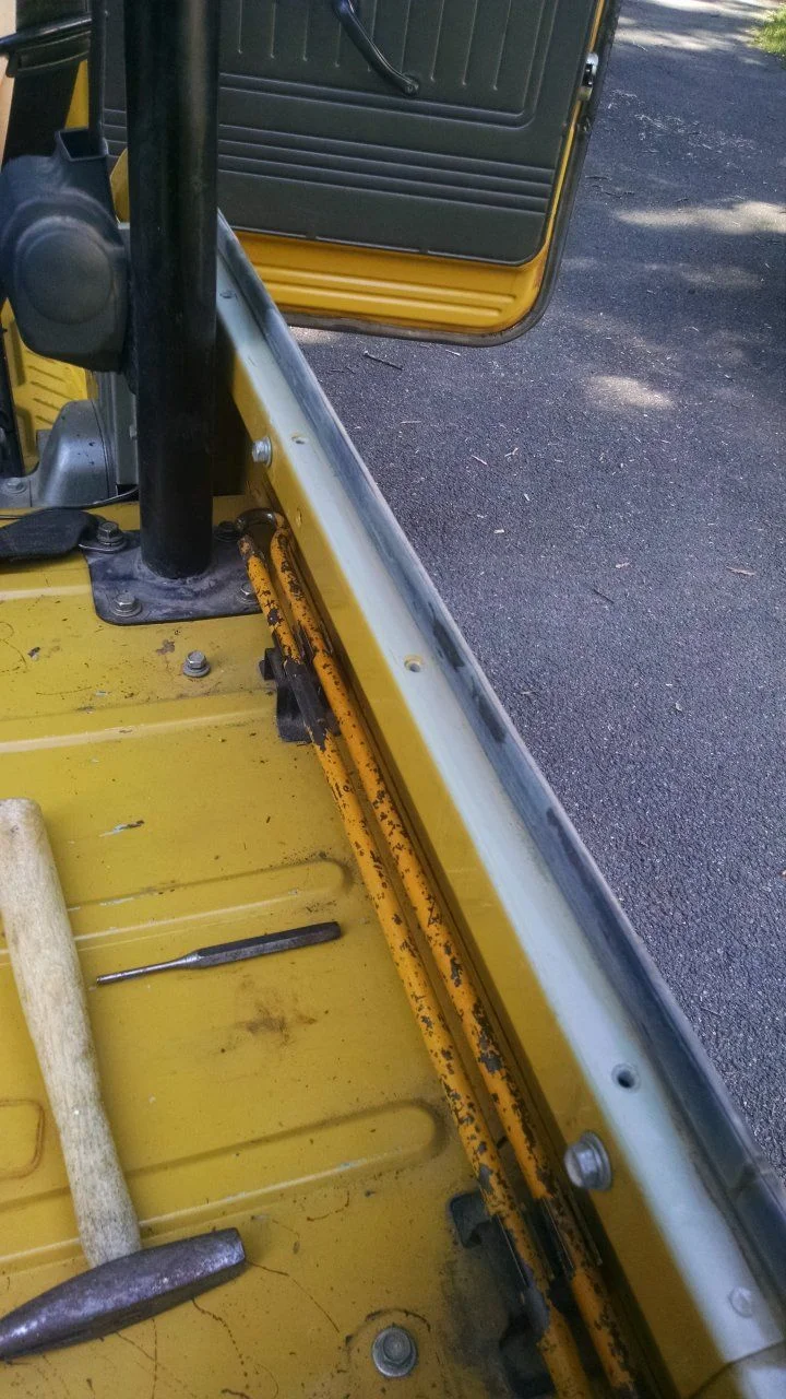

So I pulled the top off today and discovered this. Were these primered, tops put on then painted?
Primer is a very common find under there. Doors off is way cool but it is a pain in the ass getting them aligned when putting them back in. Truck looks good dude
Definitely doors off windshield down. If you haven't driven with the windshield down yet you are in for a treat. Just don't go over 45...

Alright....I've come to the conclusion my hinge pins are welded in. Not really but I've been banging on them for 30 minutes and I can't get any of them to even budge.

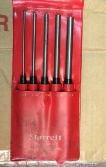

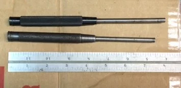

Yeah the door pins can be tight and hard to remove if they've been in place for a long time. Get rid of that small punch you have and get a bigger one. I use these punches to remove door pins, they're long enough so you can hold them at a slight angle to keep the head of the hammer a little further away from the side of the door when hitting. These are Starrett but I'm pretty sure Harbor Freight sells knockoffs. And this is Krolloil the best penetrant I've ever used. Get those doors off the truck is much cooler without them!
Now your style-in!
Looking good for the summer!
Ahhh, the fresh air feeling.
