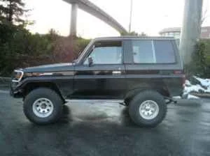

Hey Folks
Would appreciate your thoughts on the following
85 Bj 70
Owner's Descrioption

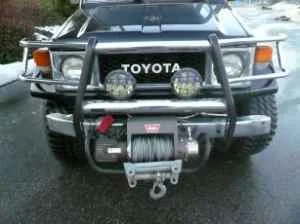

bj70, Steering wheel on left side, 357,000 km, 3.5L diesel, mint condition, driven daily, runs great! little to no rust! 9000lbs Warn winch, 4x4 front manual lockers , 33 inch Remington "mud brute" tires (almost brand new!) suspension lift, PIAA fog lights,bush bar, JVC Syrius compatable cd player and mint condition interior.

Check the inner frame rails very carefully for rust, especially in the back near exhaust. Check out the exhaust system-stock exhaust snakes around to finally exit out the left in the rear. If the gears are stock, that's not ideal for those 33" tires. If it's really clean, I guess it's worth around 10K since they're such a rare item. If you've got the money, why not?

Check to see if the axle angle was corrected for the lift depending on how high of a lift the angle needs to be corrected or something will break when you are in the bush having fun.

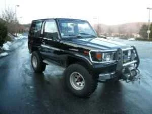

The truck looks nice and maybe it has received great care. Check her out. Good luck.
