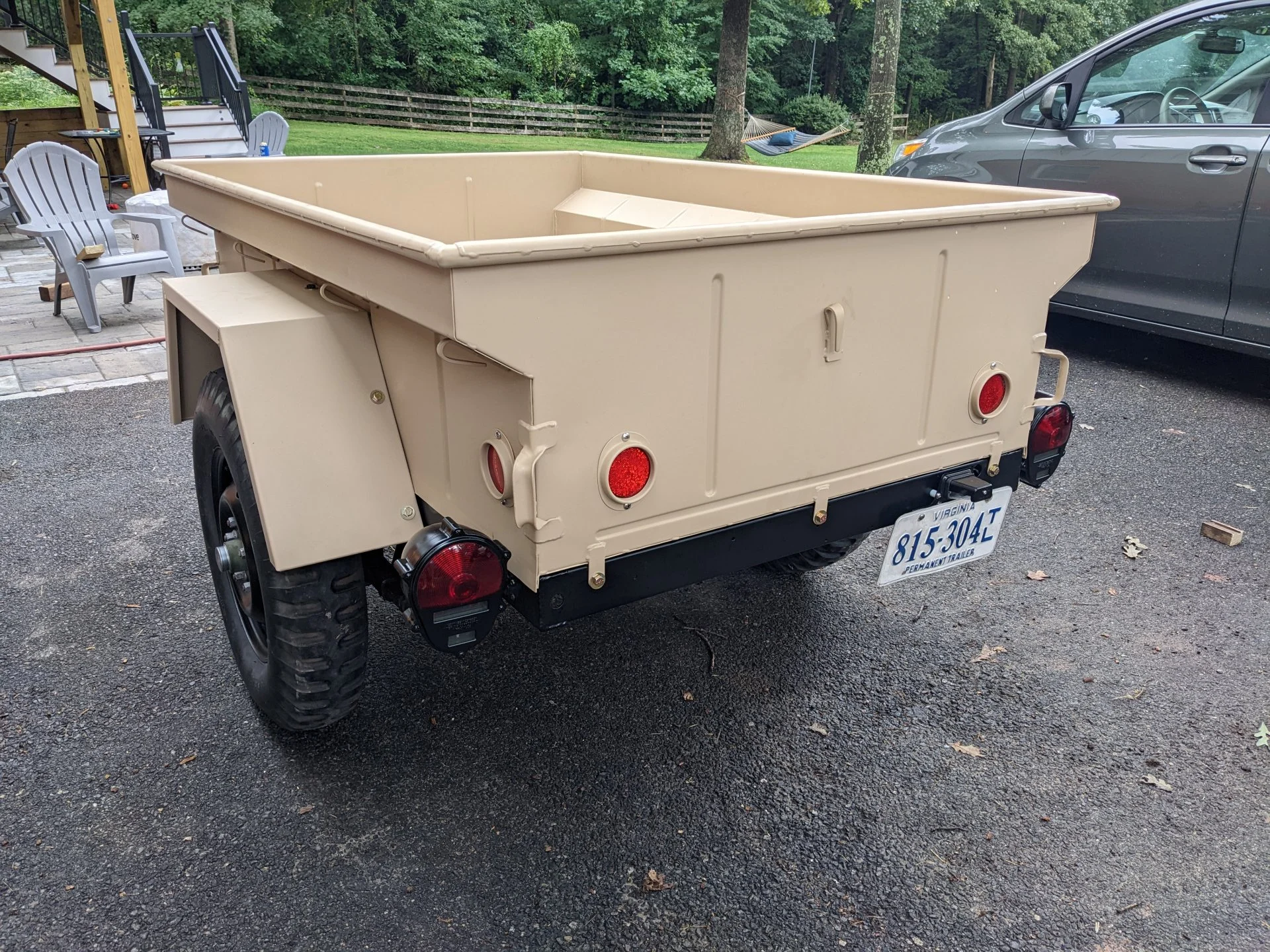

I got my M416A1 trailer build, phase 1 done. Time to go get it VINed, titled and hopefully a permanent registration.

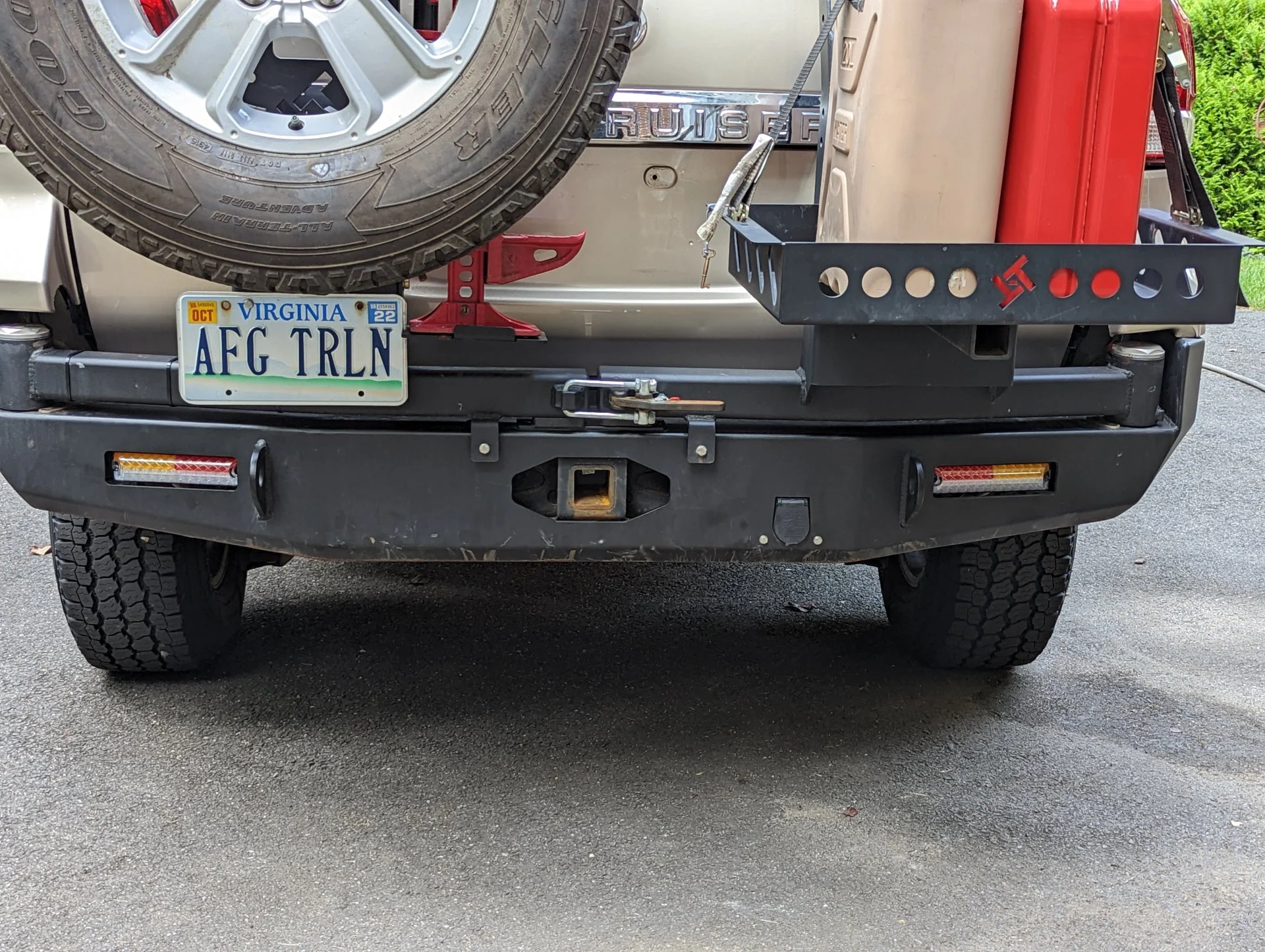

So I was able to snap a few photos of the V2 updates we did to the swing arm...
So we didn't really change any dimensions or angles on the arm itself it was mainly cosmetic updates. The plate bracket originally we had broken the mounting screws when we put them into the arm so it was mounted unevenly. We drilled new holes and threaded them instead of just using metal screws. MUCH nicer that way. Also since we were able to run the wiring inside the arm after we corrected a brain fart when building the arm the first time we filled in the holes and also sealed the bracket/light with silicon to prevent any water intrusion.
We also relocated the backup camera and ran that wiring down the tire carrier post where it joined up with the plate light wiring and then was ran to the end of the arm and exited just before the hinge and into the bumper shell.
What is not seen is that in the bumper area there is a 4 pin trailer light plug and an RCA connector so the wiring can be disconnected without having to cut the writing. Makes for a nice easy package. Unplug, unbolt, dismount the arm! Gods I love the simple things in life!
Simple, clean... functional!
Still need to sort out a better rear camera mount then the one currently on there but even at the offset angle it works and I shouldn't hit anything.
So V2 is a great update to the original in terms of appearances and of course the camera is great to have back again. It was has been very functional and sturdy from the start so I am very happy with it in that respect.
Looks good.
Works good.
Cost effective vs having to do a full bumper or even a hitch tire carrier.
Again shout out to my buddy Chris in VA couldn't have done it without your skills!!

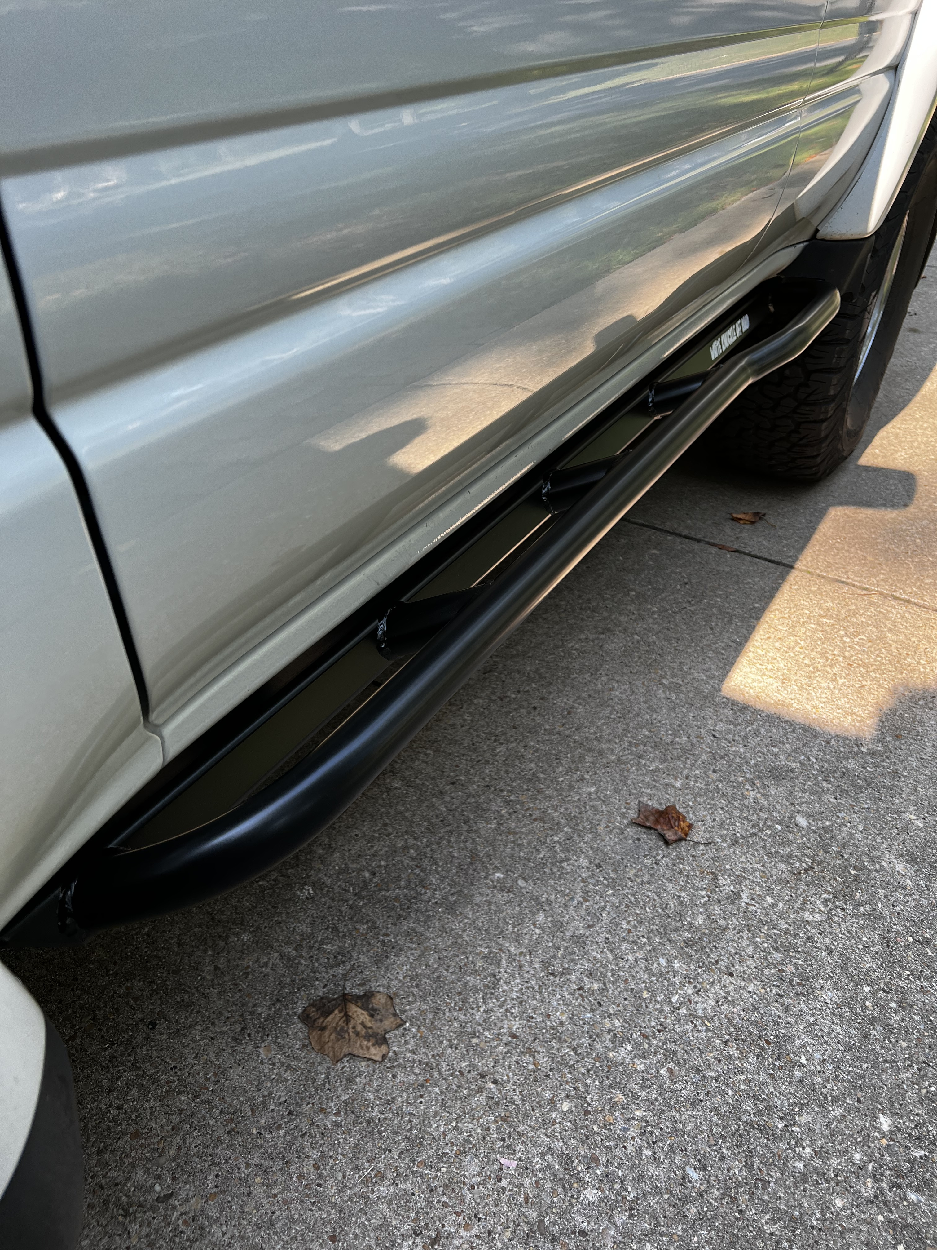

Got my White Knuckle Sliders installed...I must say, fit, finish, and quality seems to be excellent. I went with the shorter ones so I can still run my front mud flaps and the steeper 20 degree angle. Also went with the DOM tubing, seemed to be a no-brainer to step up since the option was available.
Seems that White Knuckle is the choice of the club... I love mine im sure you will love yours too they look great!

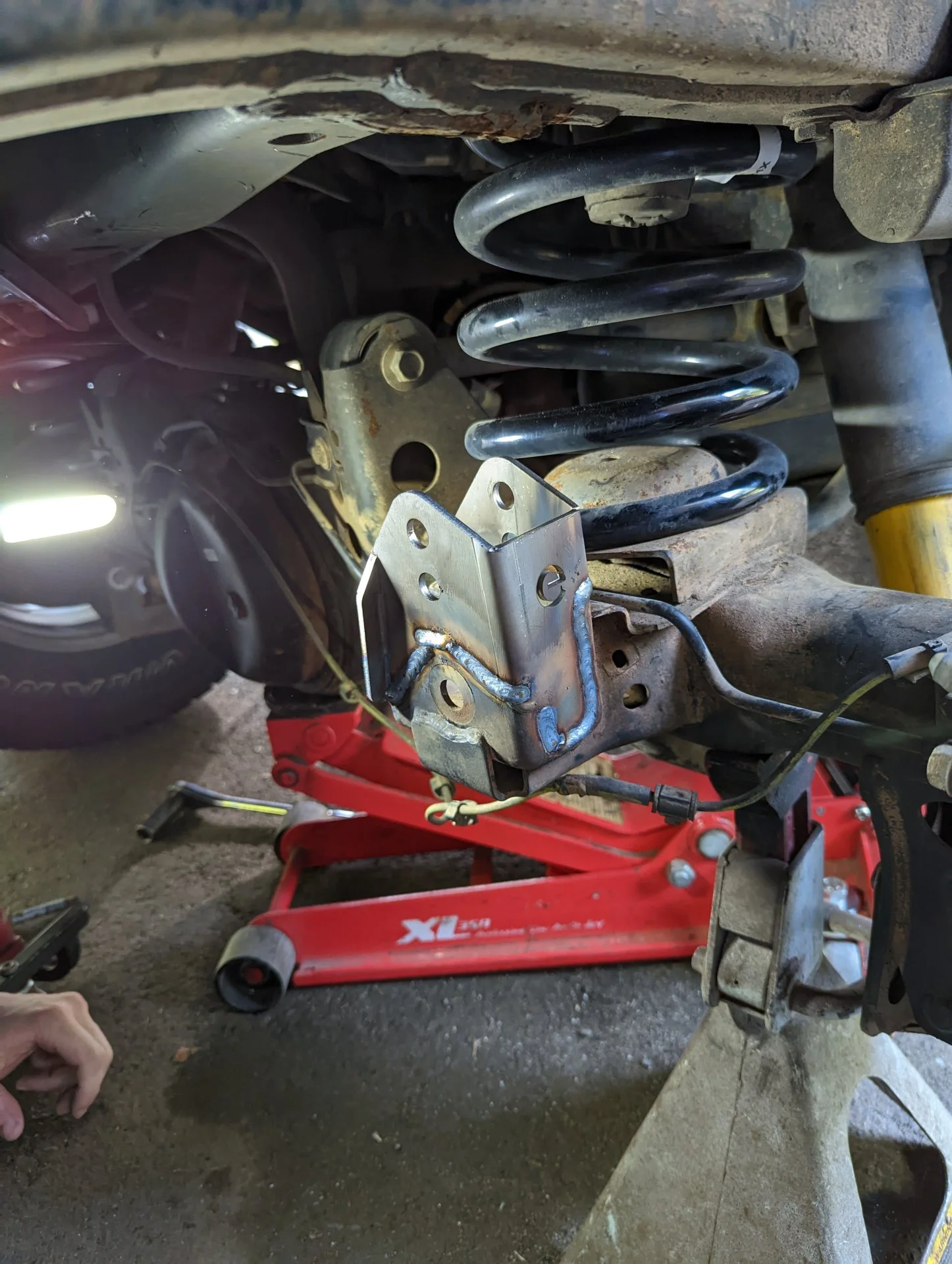

Installed a panhard correction bracket and wired in lights for the rear bumper to pass inspection.

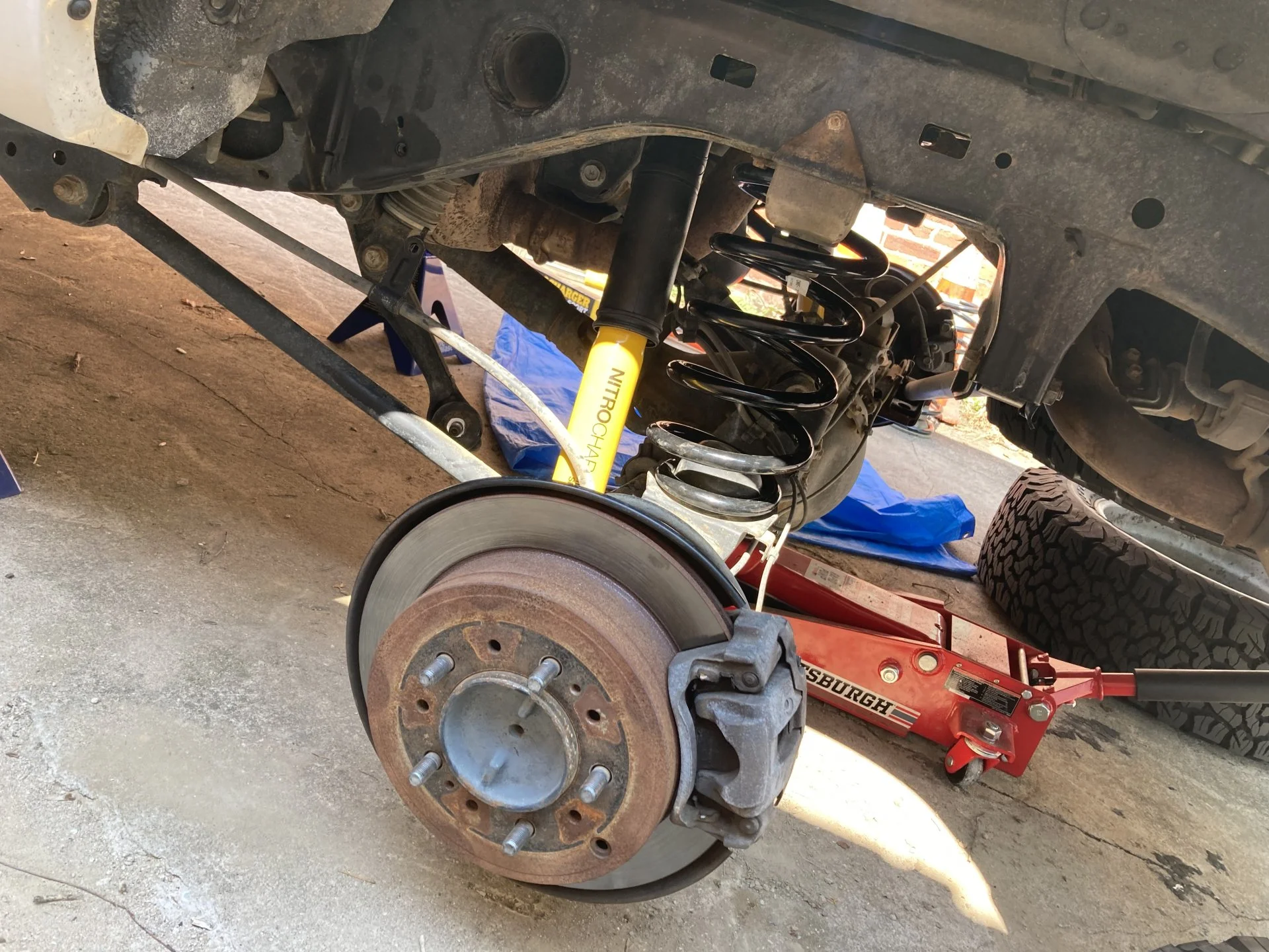

Completed the Old Man Emu lift kit install on my 200 this weekend... Seeing @afgman786 post above- as we now have the same lift, apparently I might need to look into a "panhard correction bracket"?
The rear was way easier to do than the front. Got tired of fighting to pull the old front shocks out of the Lower Control Arm so hit em with the Diablo carbide blade on the sawzall. Zip zip.
Not sure if it’s because of the KDSS system, but the sway bars and sway bar links were a huge pain during the install process. Always in the way on front passenger and hard to get seated again.
Truck rides way nicer with the new suspension. Front came up by a solid 5”. Rear is up by 3”. Clearance at the lowest point of the front skid in now at 13”. It had been at 8” with the old blown shocks.
Now off to alignment and I’ll throw some wheel spacers on it this week to fill the wheel wells a bit better with these tiny 33” girl tires. As @afgman786 had warned- it looks like the truck skipped leg day.

If you feel after an alignment that you still pull to the right especially under throttle then you will definitely need the bracket. It's not expensive which was nice, I do also run trim packers on the coils for a little more lift.
