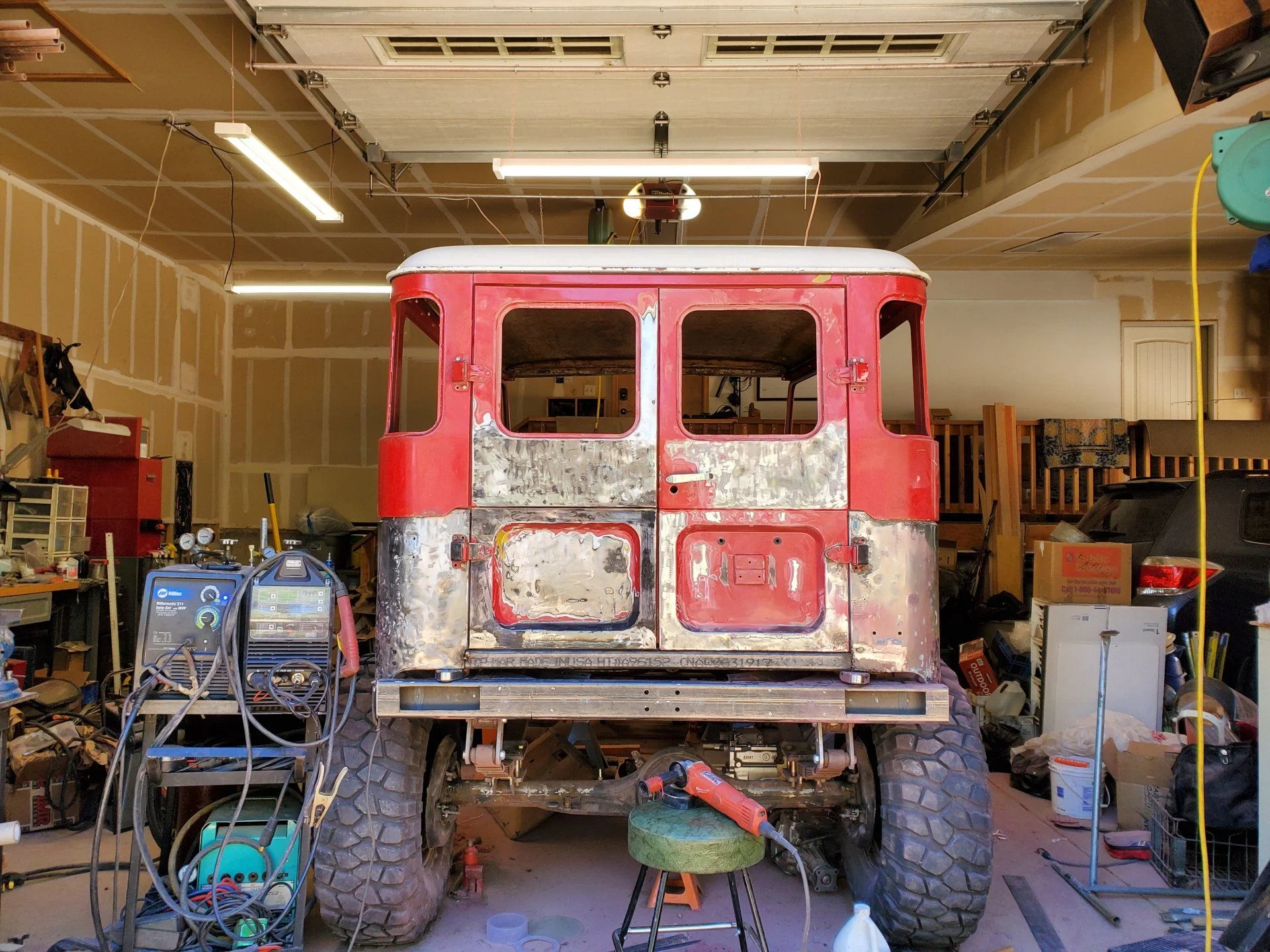

Hi everyone. Need a bit of advice. I was able to trade a friend for a 72 fj40. I’ll try to take pics of it and add that later. The friend stripped it down to metal and rebuilt the back half of the tub (did a decent job). Frame is in need of help on the back wheel arches and the passenger side front. The engine froze from sitting so he took the head off and put Lucas or something in and cranked it over. Seems to be ok but I haven’t finished putting it back together yet.
