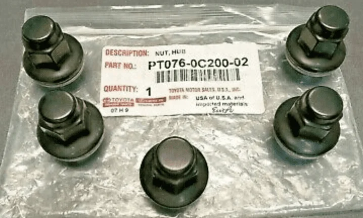

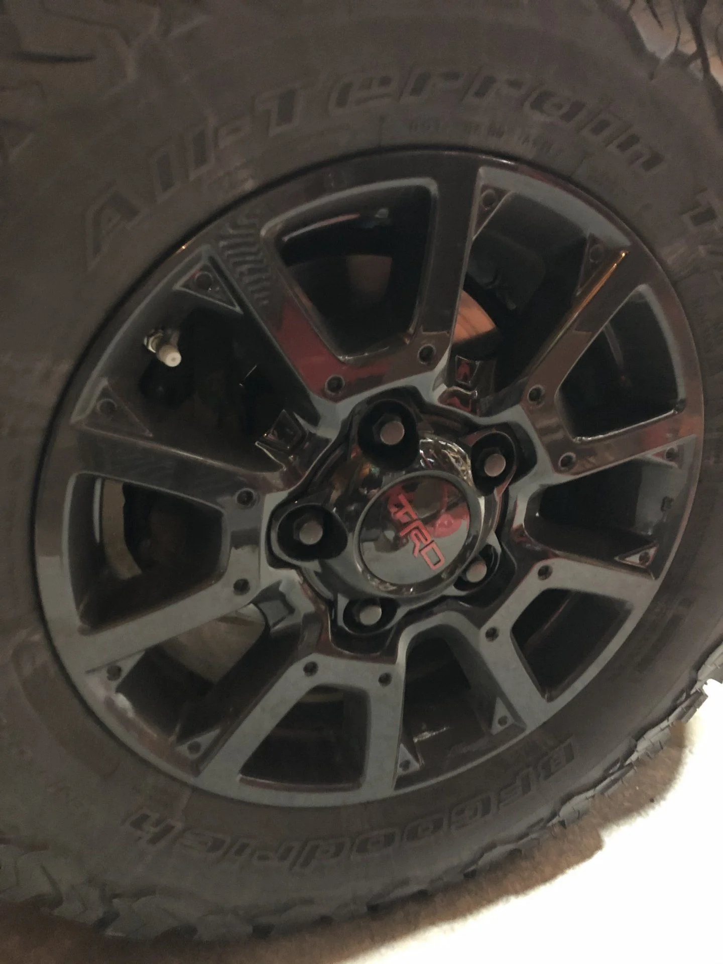

Are you putting the black lug nuts on any of these builds? With the chrome deleted and the black trd rims, they'd be a nice addition.
PT076-0C200-02
PT076-0C200-02
Though about it but I think they’re like $16 per lug. Just feels dirty
I got four sets for around $55 total... $13.81 per set of 5.
Dang! I spent countless hours looking for these a few months ago. What is "PVD", a fancy name for powder coat or are these black chrome?
Edit: never mind, I googled.
Stronger than powder coat?
PVD is a diamond like coating (DLC), popular to make various metals black. Probably used in lots of industries but I have seen it in the watch industry for years

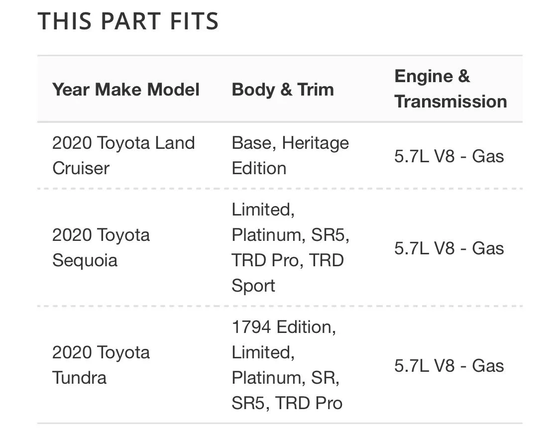

@CharlieS I don't think those are the actual "Heritage" lugs. This are probably off a Sequoia or Tundra. Do you like them?
Thanks, Eric. I do like them, since they cut down further on the bling factor. I like the more stealthy look.
Yeah, I don't really have any idea what exactly they are off originally, I thought the Tundra TRD Pro, but I don't actually know. They are the same as the land cruiser ones that were in my rig, but in black.
From a quick google search:
