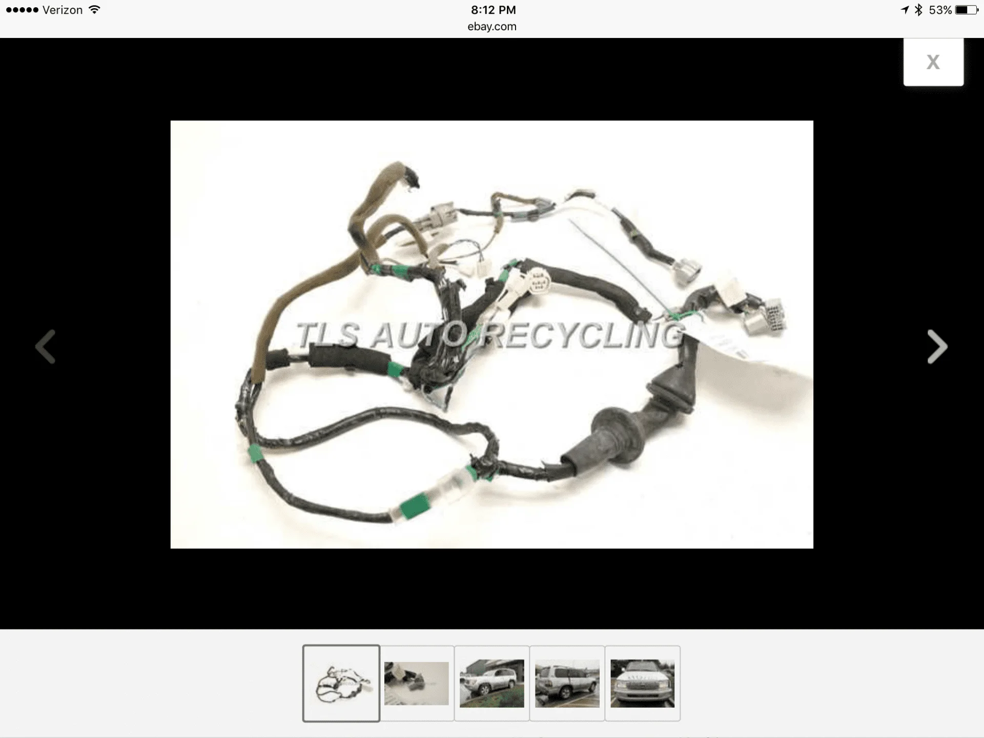

This is a picture of the passenger side wire harness, you can see how far the boot extends into the door.
I will have another look, but I could not compress the boot very far.
You can unplug the wire harness from the main wiring and pull the wire/wire-plug out of the body. Then remove the electrical tape on both sides of the rubber boot. Now you should be able to move the rubber boot to inspect the wires.

Ok, here is a follow up....i cut the rubber conduit open and found 3 broken wires and one almost broke.
I used butt connectors and everything works now.
