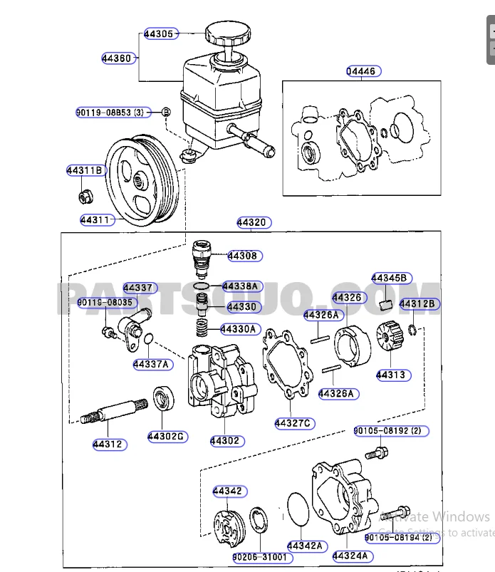

looks like the PN is 44311-60090. but as mentioned, unlikely its the pulley..its just a splined pulley there are no wearable parts. more likely the bearing in the pump. a new pump does not come with a new pulley btw. take the nut off the pulley and slide it off, see if you can wiggle the shaft with your hand..would take all of 2 minutes.

im going to circle back to the comment about not having a nut holding your pulley on. there is most definitely a nut on the end of the pulley shaft, you can see it in the drawing. if yours in missing, thats probably the issue.. unless someone can chime in and say that there is a different model pump out there that uses a pressed on pulley with no nut.

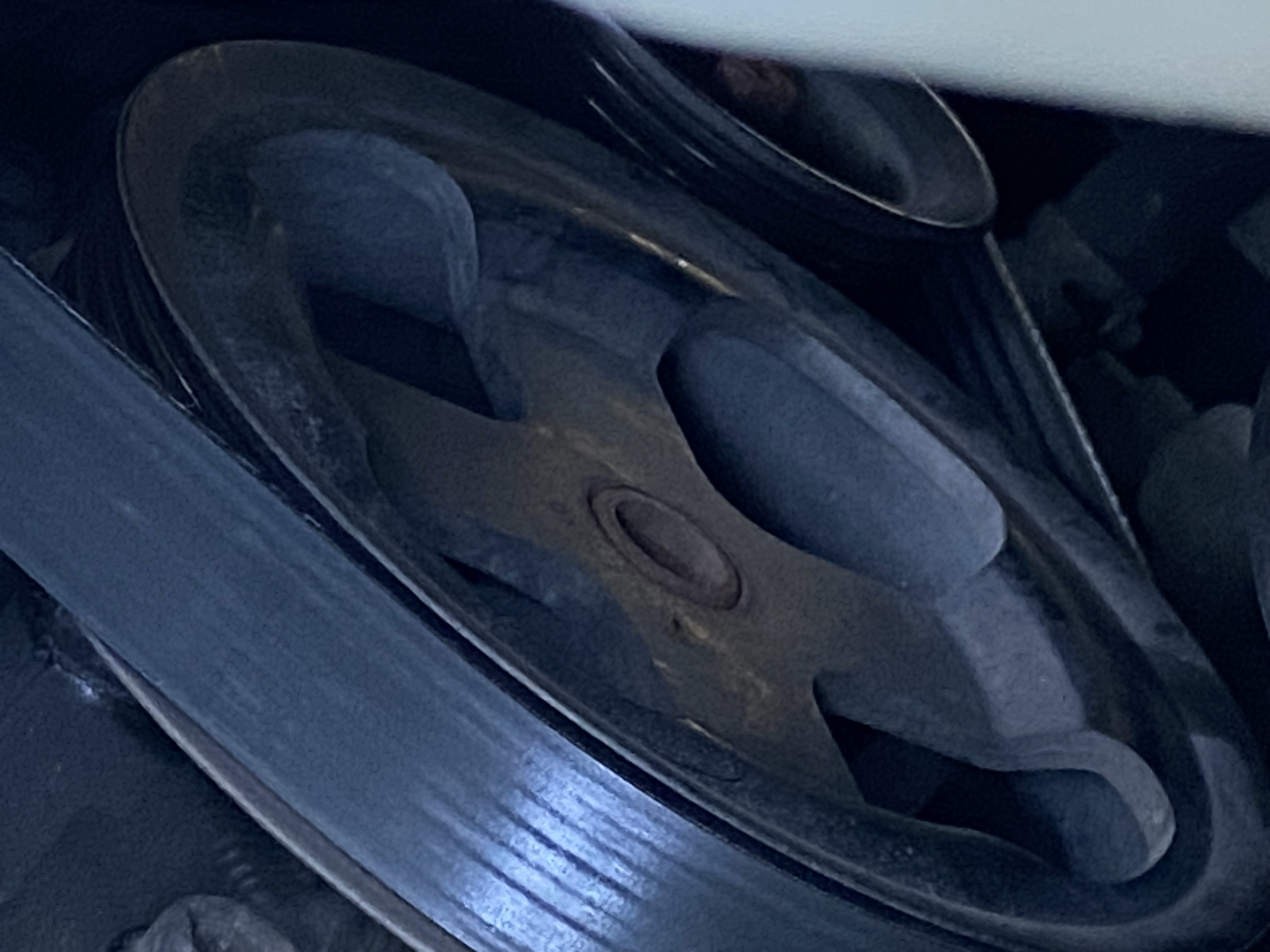

Here is a pic. I believe I am supposed to insert a tool to remove?
What year is your truck?

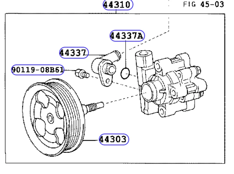

ill slunk back into the shadows, sorry i was not aware the pump changed for the newer models. looks like you have your answer! new pump time.
Can confirm the change, I just had the pump replaced on my 99 and it came with no pulley, had to reuse my OE one.

OP has a pulley permanently fixed to the pumps vane shaft. On our vehicles (I also have a 99) we have an older version with a removable pulley which IMO is preferable, but I wonder if Mr. T was going for less parts.
