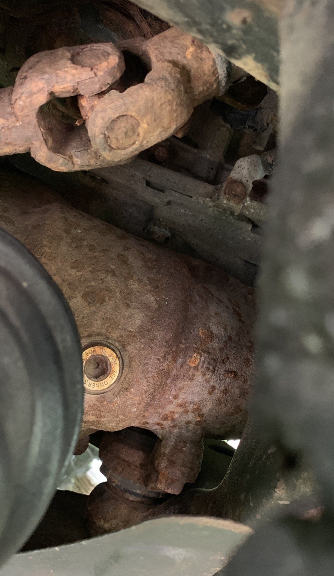

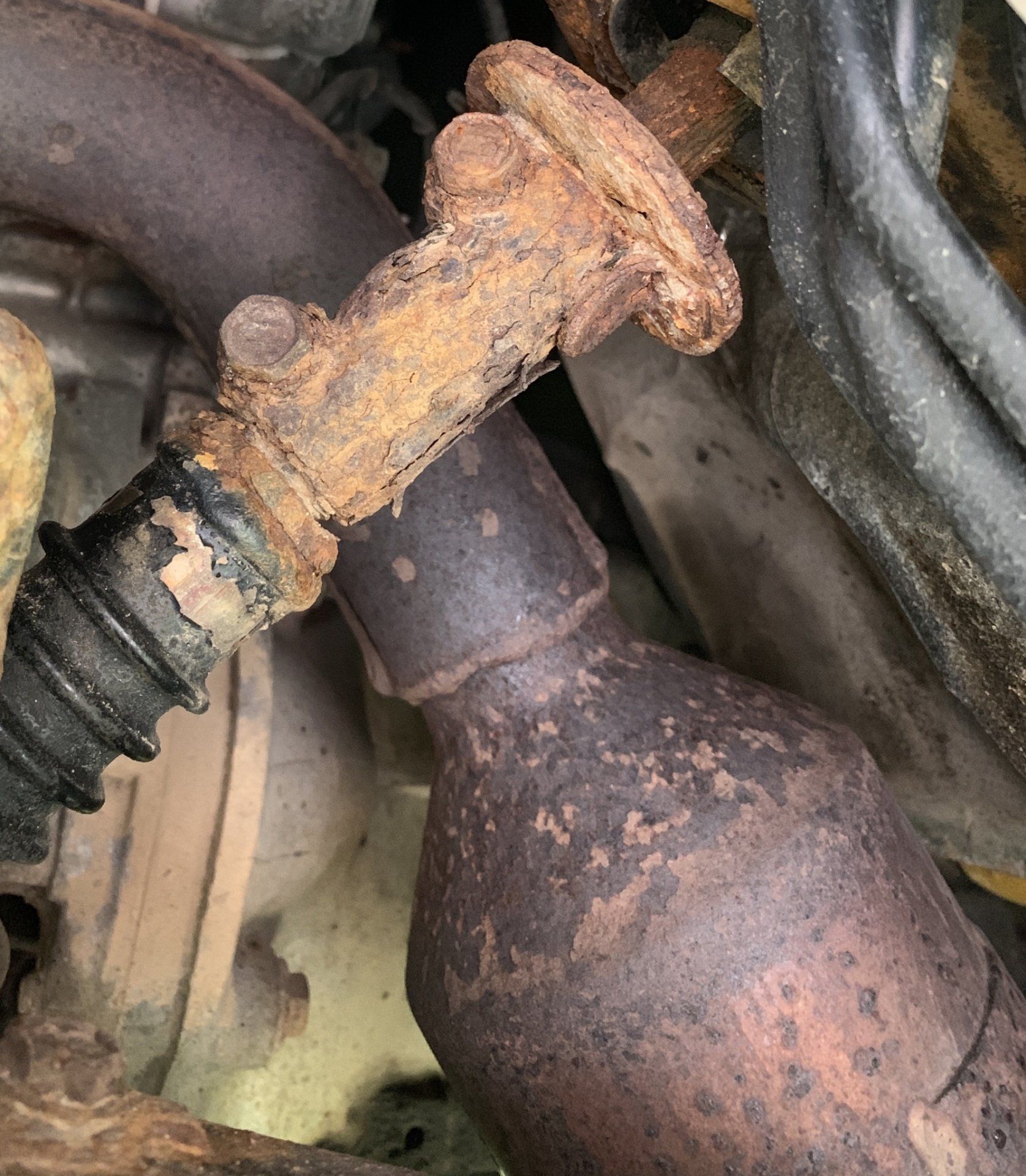

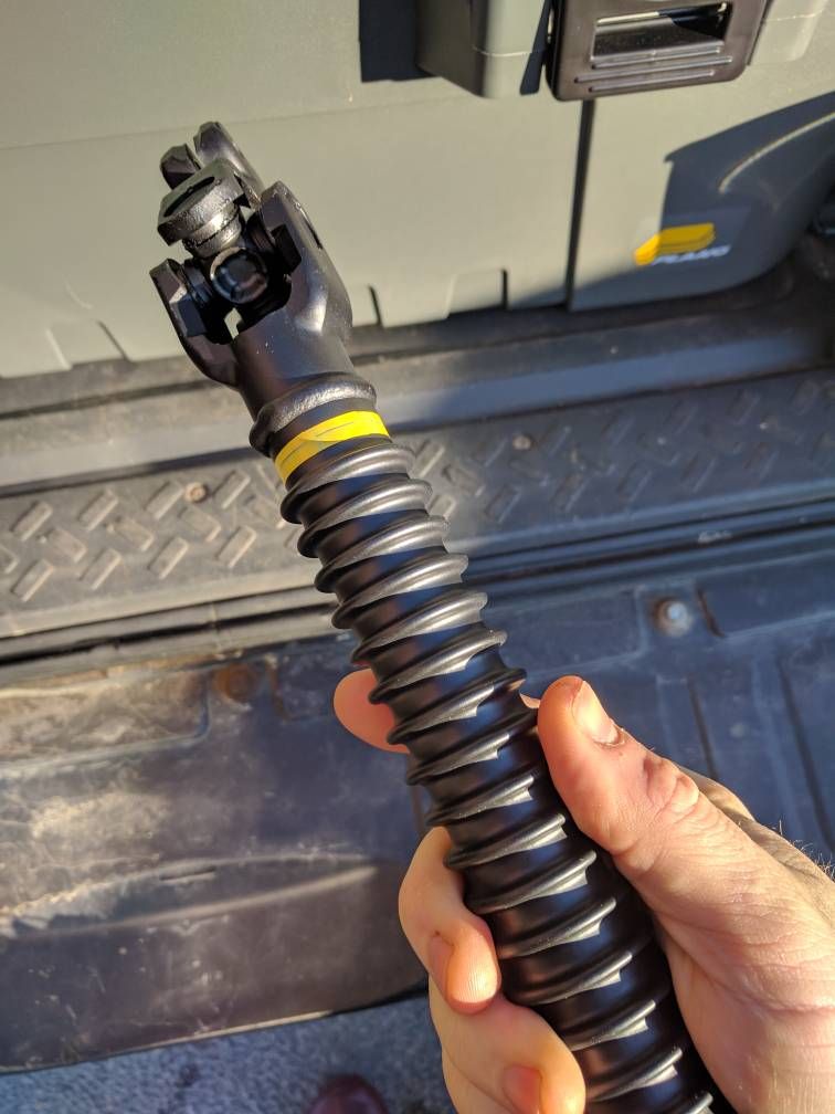

Well , thanks stoshzack for the information. I was busy and figured it out. I jacked up front end, took down plastic dirt shield so I could get to lower intermediate steering shaft. Top end. The bottom end was hard to get to at the universal joint end . The bolts were in bad shape but after soaking them for days with penetrating oil while waiting for new shaft they came off. If you knock up the yoke on the upper end the shaft will clear it and swing free. To do this I used a air chisel to knock it up. Same thing on u-joint end , air chiseled it up. To air chisel the u-joint end you have to use a pipe, or solid rod better , to reach it . New shaft and 3 new bolts, and new yoke. I give it a four for difficulty if you have the tools. Ours an hours of freeing it up but 30 minutes to put it all back together . End it drives like brand new . Somebody had assumed it was the power steering pump and put a brand new one on before I bought it, yay.😑
