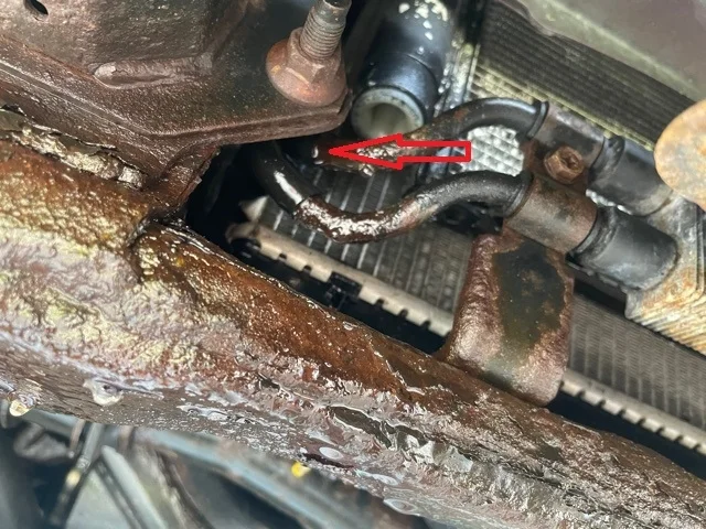

Appears my power steering is leaking at one of the cooler lines. When running there are air bubbles and dripping at the juncture of the upper tube and rusty metal. (Beware: the following photo may be unsettling to some with rust phobia). Thinking of replacing the whole cooler and power steering pump if it ran w/o fluid for a while? 08LC just passed 250k miles. Or maybe just patch it temporarily to get by for a bit. Need truck for trip late next week.
anyone else encounter this issue? Any advice? I'm going to have my mechanic look at it this week see what he says.
Update. Replacing the p/s cooler with an aftermarket one for now, mainly due to cost and speed of getting my truck back. Only $40 for aftermarket while an oem is $440! Figure it’s only $40 and if it lasts a while I’m fine with it.

I “changed” the fluid by sucking out what was in the reservoir and adding fresh (several times). Probably around 200k. The leak was due to corrosion on the cooler tubes.

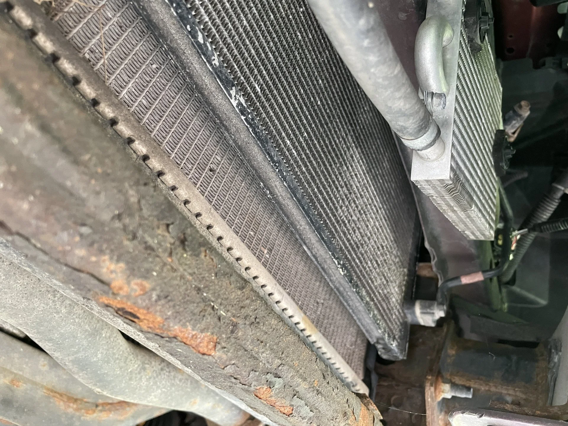

What cooler did you go with? Dorman clone or in front of the radiator? Was cooling area and capability better, or similar?
