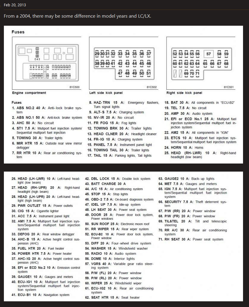

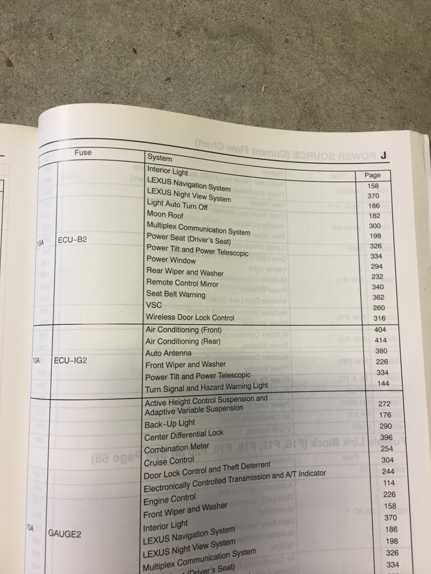

After searching through the archives, I found that the ECU-B2 powers the seat, window and moonroof. The fuse is like blown or damaged. I’ll confirm tomorrow. Thinking back, I had this strange smell in the cabin a few months back. I’m wondering if a wire had melted or burned.
Its the big 40 amp fuse.

Anyhow, pulled over again at a gas station to check things over with better lighting and my windows didn't work, locks didn't work, seat adjustment didn't work, key fob didn't do anything. Pulled some diagrams from here and found that the 40 amp fuse puts power to the small fusebox. The big fuse was blown so since then I just disconnected my lumbar support motor and went to my local pick and pull to get like 50 random Toyota fuses and relays that you cant find in a gas station or Napa.

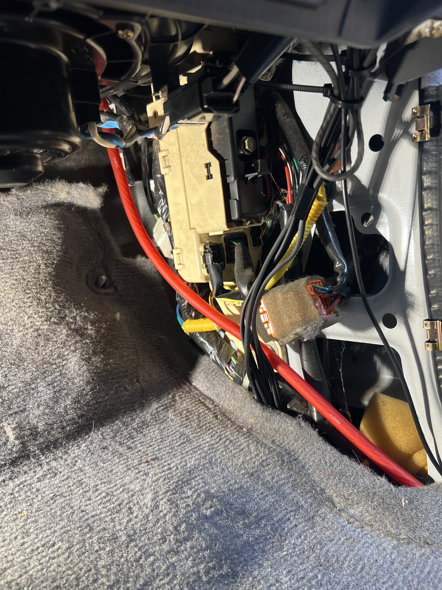

Is this the fuse box on the left or right side of the footwell?
I finally have a few minutes to look into this. Is there supposed to be a fuse panel on the passenger footwell? Maybe I’m not seeing this correctly.
Got it. It’s the 40 amp fuse. I did press the lumbar button before the fuse blew. I’ll test the circuit and see what’s going on.
