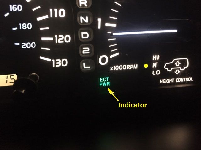

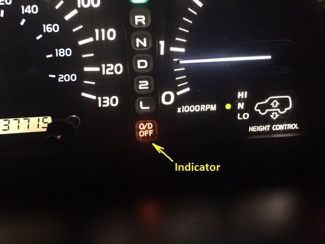

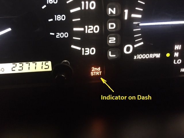

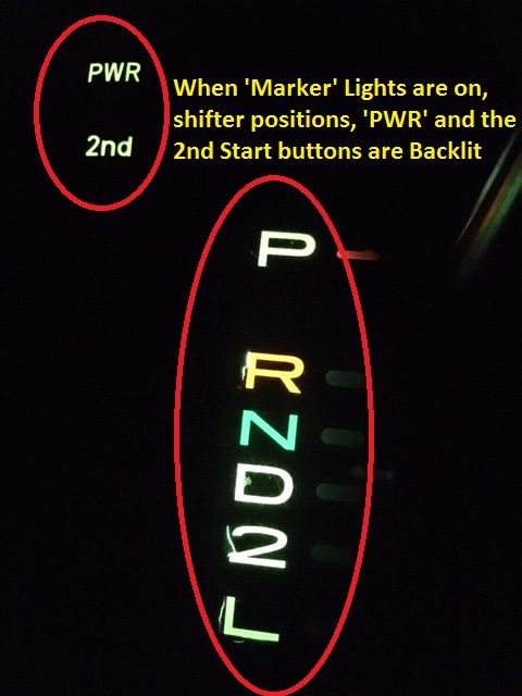

The buttons themselves do not light up separately, they ARE back-lit anytime you have your 'marker' lights turned on as are the shifter positions.
However, when you select OD (disable), PWR (ECT PWR ) or 2nd Start.........the indicator light should appear on the dash (provided your bulbs are working). See Below:
