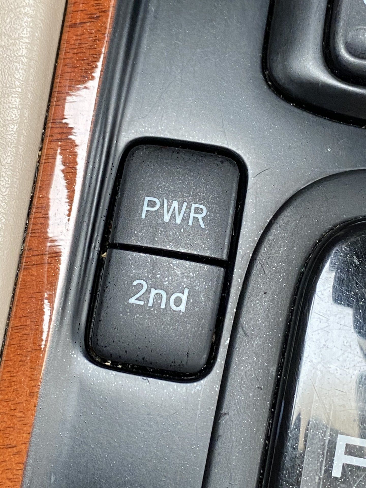

What are these buttons?

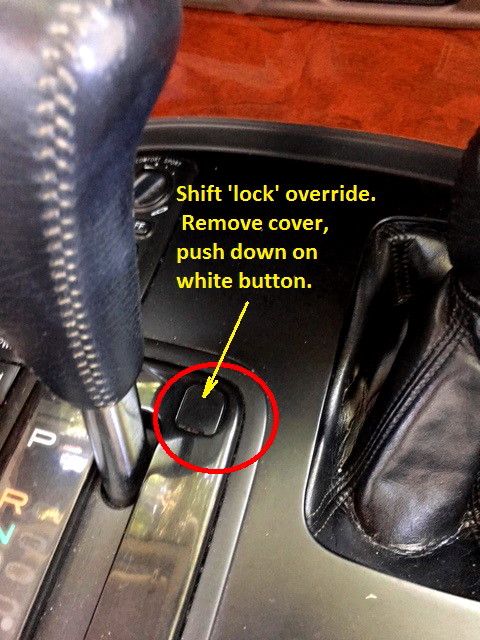

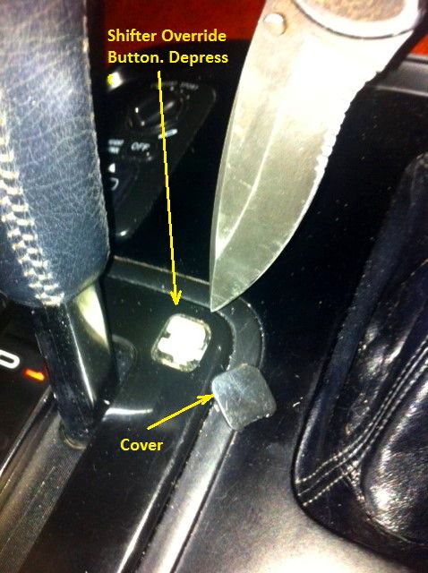

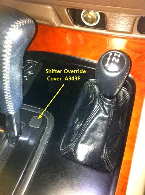

In that same general area there is one more thing to know about. Shifter Lock Out 'Over-Ride' button (underneath the small cover). You might need to use it someday.
2nd start will skip first gear and start your rig in second gear. The reason for this is to avoid wheel spin and too much torque. In my experience it is used mostly in 4low when 1st gear is to much torque for the given terrain
PWR is supposed to hold your gears longer and hit higher rpms but I have never seen this have any effect on my rpms or driving so I only press the power button as a joke now a days as I chug along
Someone else mentioned it in a different thread, but I have found the PWR button make a significant improvement if you engage it for steep hills at highway speed. Thats about the only time I use it.

I use it towing....as it DOES hold the transmission points a bit longer.

If your engine is down and you need to move the truck for whatever reason, push that button then shift trans to neutral.
power = higher shift points in the revs
2nd start = starts you off in 2nd gear instead of 1st.. lets say in a snowy situation too much torque on first will make you spin, softer slower 2nd will just feather you off the spot.

If certain things in your brake light circuit fail....you won't be able to shift out of park without first correcting them OR using the over-ride.
IF your battery falls below a certain voltage you also will not be able to shift out of park.
I don't know exactly why Mr. 'T' burdened us with this.....but he did. So I thought you should know. Well that....and I can be insufferable. ;)
I leave the PWR button on all the time and notice a significant difference in the way it delivers power. I have not noted any change in fuel consumption and in fact my highest MPG rating ever of 17.2 I think it was came while using this button on a 3-hr highway cruise, and no I don't baby the pedal.

The 'main' purpose for the 2nd start is to reduce torque (when initiating vehicle movement) to avoid wheel spin on slippery surfaces (I.E. Ice, Snow). Many folks use the feature in Low Range to avoid a harsh 1-2 shift or just to start in a higher gear than 'low'.
