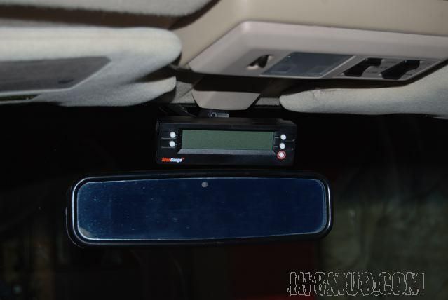

    Post your scan gauge installation with the setup numbers you used. Like gas tank size, cutoff, ect. I used what the manual said the gas tank size was, 25 gal and it says im getting about 11mpg which seems to be pretty accurate.
    [​IMG]
    sorry for the crappy picture. Ill replace it later.
    What it look like now.
    [​IMG]

    how does the tank capacity affect the mpg calculations?
  3. lndcruz
    lndcruz
    Messages:
    1,604
    Media:
    5
    Albums:
    1
    Likes Received:
    13
    Joined:
    Nov 11, 2008
    Location:
    Anniston, AL
    not really sure, but in the owners manual it says to put all that in before it will give you a reading.
