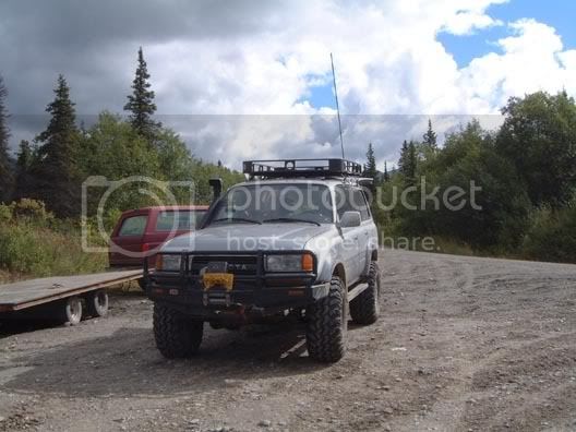

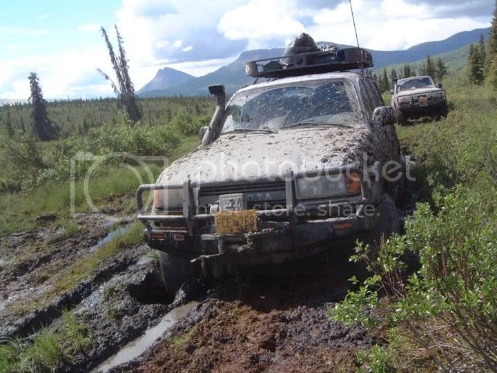

Heres mine. Flareless and then flared; man do they make a difference in keeping the truck clean! Iroks on a hybrid Slee 4'' and OME J spring lift, L shocks and tundra wheels (5''bs x 7.5'' wide)
All other suspension pieces are stock. No aftermarket arms forward or back, no relocated shock mounts, just the way she came. It will rub the shoulder lugs on the front control arm at full lock and will rub the frame rail at full stuff in back. Wheel spacers would solve these issues but i havent got around to them yet. Adj. panhards would be nice too and the lack of them contributes to more rub in rear on driver side.
Wheeled this way w/ the flares and they were not impacted. w/ the wheel spacers the flares would have deleted themselves likely.

I love those Tundra rims on an 80 - they are ~5" BS though, not 3.5".
:doh: Yup they sure are. thanks.....edited post.
If i could commit to flareless i would run minimal width spacer just enough to get me off the control arm up front and frame in rear. thinking 1/2-3/4''. But I do like the flares on the eighty, i just dont want to constantly be reattaching them. I think ill end up trimming and lining the flares, installing, then adding a 1.25'' spacer similar to tools' setup.
