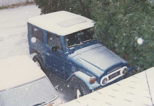

Cloverdale B.C. Canada
one of my first cruisers had a sunroof. this is the only pic i have of this rig .
i kinda liked the sunroof. i only ran the hard top for 6 months or so before switching to the softtop ,i never noticed any leaks .
pretty sure my sunroof was slightly curved .
