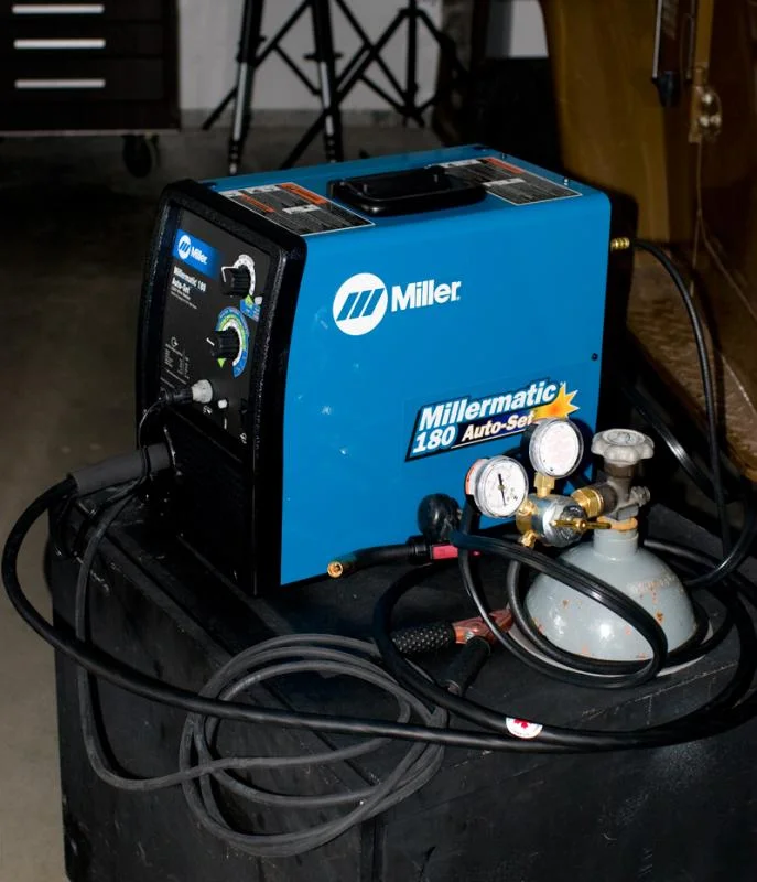

Picked up the 180.
Got the 55 cylinder because Airgas wanted another $100 for the 80. They said I could pay the difference later and trade up.
Passed on the low end cart for now - see the temporary old steel copier stand I rigged attached. It's got inside storage and wheels anyway. :D
Got the wire/gas more or less installed. Will try some of my first 18 ga butt joints on practice steel over the weekend.
Now I need a short extension power cord (10'-15'). Should I just go to the hardware store and put one together? What wire should I look for - should it be more or less the same as the Miller power cord or heavier?

Nice job on the cart. I wouldn't spend the extra $100 for a larger cylinder. Just buy a used cylinder on craigslist and keep the 55CF cylinder for a backup.

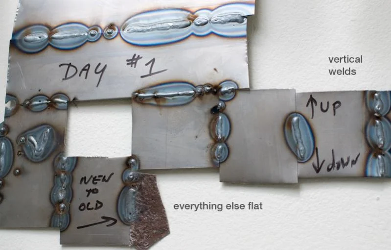

Attached are images of my first welds (all butt joints, .023 wire, 18 ga). Not done under the influence of alcohol or medication, though it may look that way. :grinpimp: Next I'm going to grind a bit and cut a few apart.
A few dumb questions:
When I turn off the MIG welder, do I just close the main valve on the tank or should I be purging the gauges somehow?
Do these beads seem large? I'm surprised at the weld contour and the amount of metal that seems to be getting laid down (for 18 ga)? And in most cases, if I get good penetration, there's much more of a "radius/metal" filler showing up on the backside than I thought there would be. These seem like strong welds but it also seems like a lot of metal to grind down, etc.?
I cut a sample from the rusty, pitted bed on my FJ40 for a test that seems to be one of my best first welds. I'm I kidding myself or does this mean I can probably weld to my old bed without completely replacing it with a new panel?
Thanks for any feedback.
