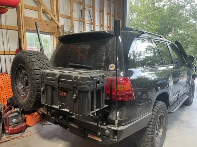

Have you driven with your outside antenna in the location in the picture at 80 or more mph down the highway and a observed how much it moves and bounces around?
My guess is it is probably ok. Mine, mounted on the bumper with the longer mast wags like a lab puppy’s tail. I’ve driven some 600 miles With it and it’s not getting damaged or scuffing my tail light but it either needs to be moved or restrained when on the highway. Signal wise, it seems to be working and improves cell reception.
it doesn't move. About half the can is below the roof line. It's most all in wind shadow. I have mine rotated a bit off vertical, it is the same angle the back corner is off vertical.
