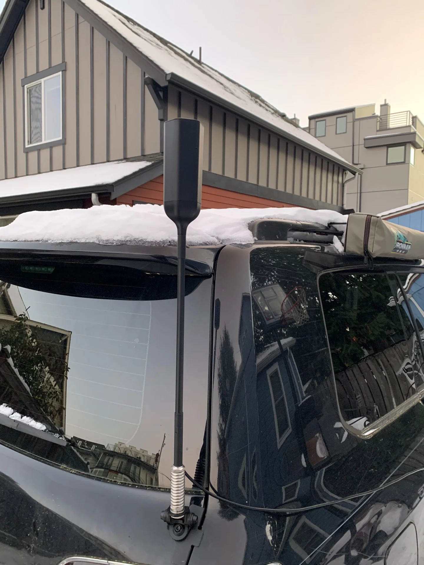

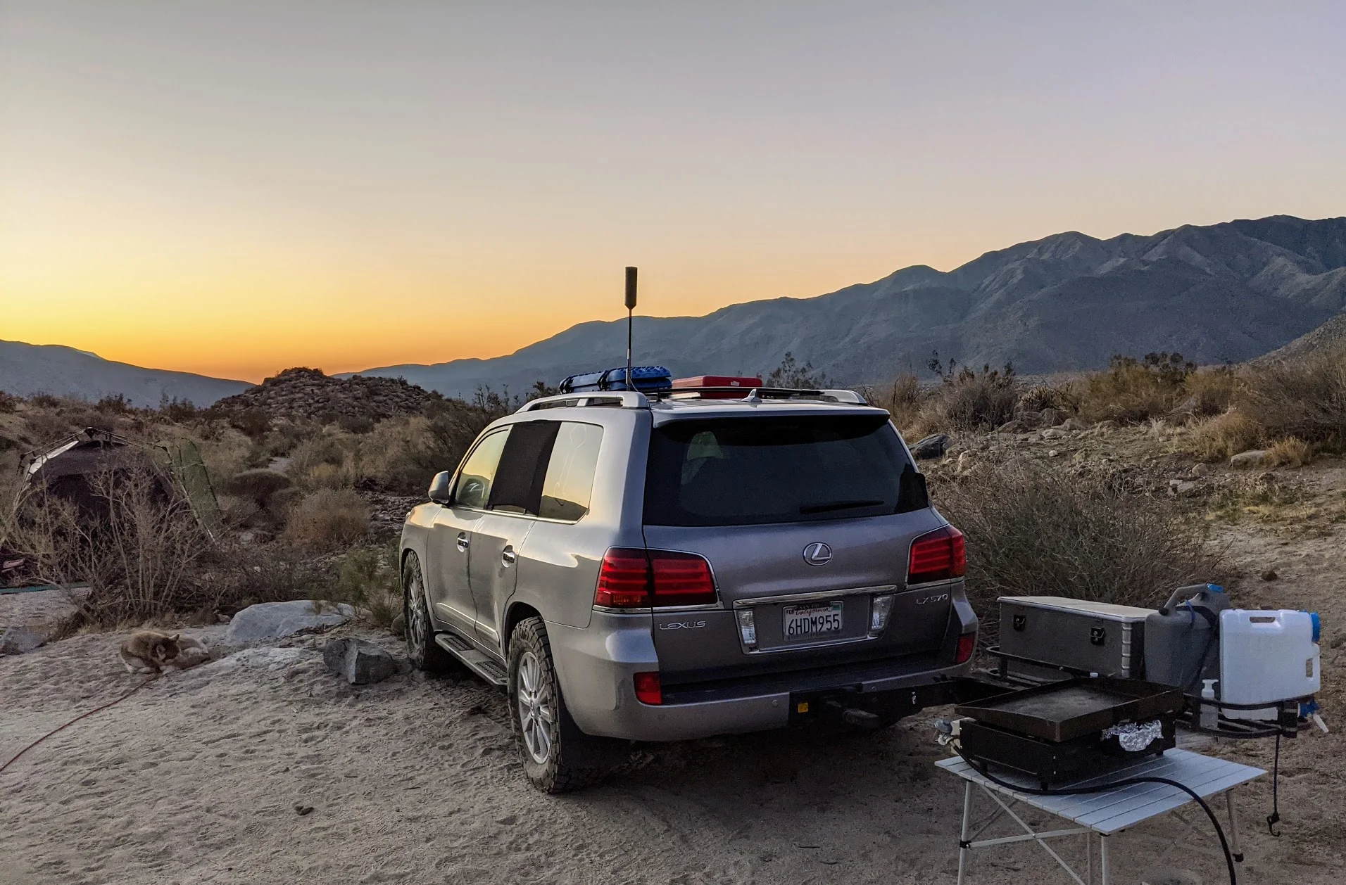

This is my install and is working well. Make sure your antennas are away from each other. If they are anywhere close, you'll have issues. Hope this helps, best of luck.

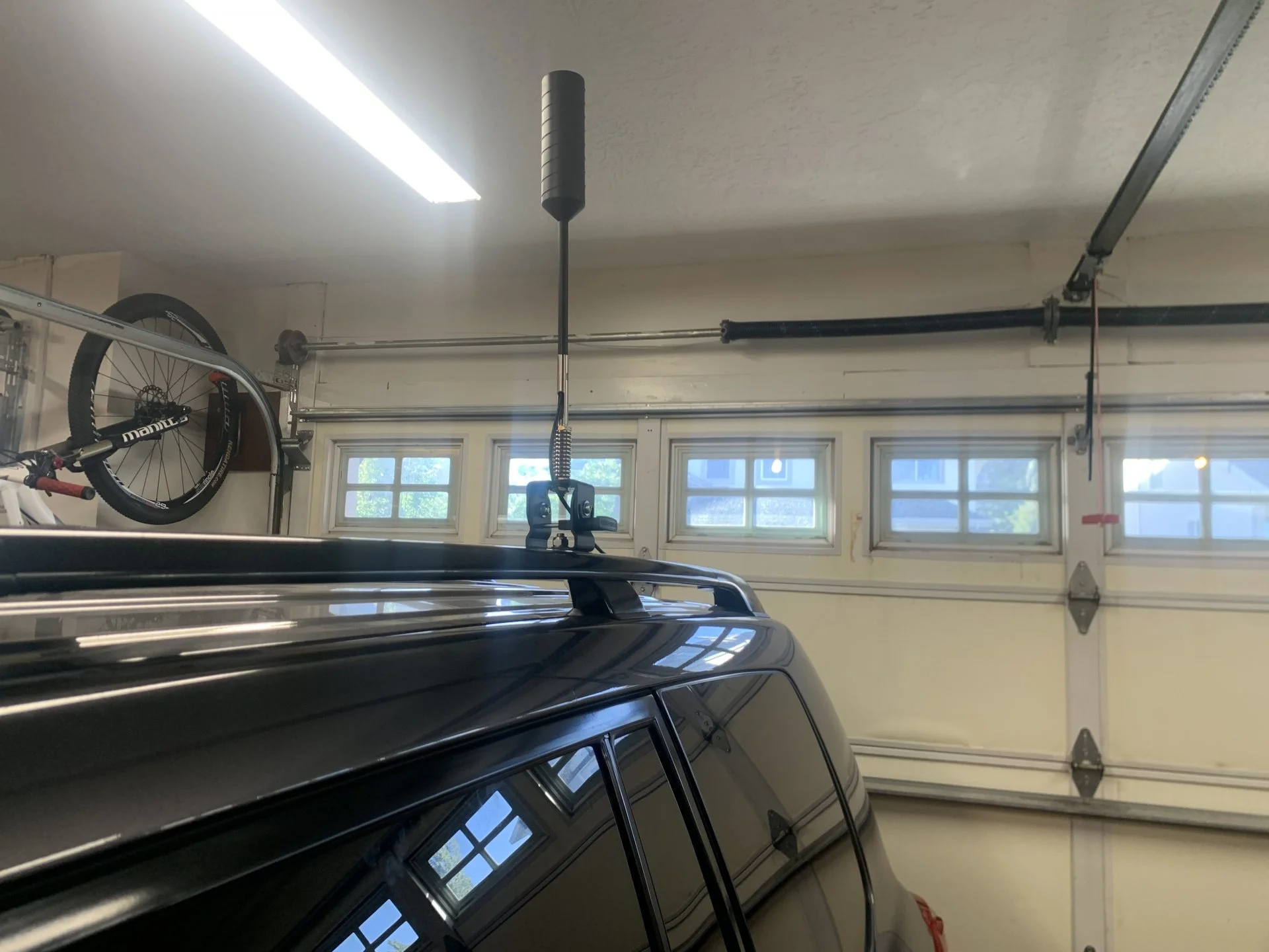

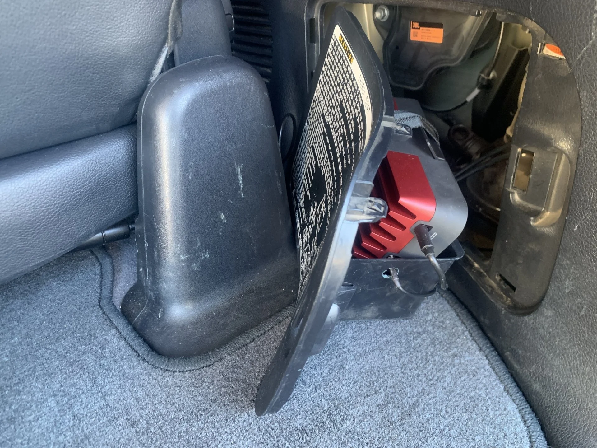

Here's where I have my antennas located
Thanks for sending. I recall your nice setup and tried placing the internal antenna behind that same panel (on passenger side) with Wilson antenna on rear corner like yours (even a little more distance between the two antennas). Good thinking on me/home being near a cell tower, that could explain it. However 2 weeks ago, went camping in a remote area with a very weak signal and got the same red light indicating oscillation, had to connect the small magnetic antenna to get it to stay green. Appreciate the response.

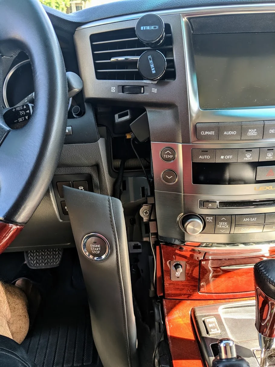

Second test, replaced interior antenna, powered up and green light. Granted, I did not run the new interior antenna under the carpet, from Weboost which is behind second row, along the center console to the front dash like the existing one. Don't think it should matter.
When I get back from vacation, I will run the replacement along the same path as the original interior. Maybe the original has a nick in the cable cover or something,… Will post results after testing.
How much above the ‘level’ of the roof does the trucker antenna need to be?
I can place it with the one tall extension and the base of the antenna pod/where wire exits is level with the roof. That is ideal from an exposure perspective but no point to it if it won’t get any signal that close to the roof plane. This is an install on the hatch; so the antenna is behind the roof/hatch aero wing a few inches.
What mount is that? It looks like it has a nice swivel so you can lay it flat?

Comet rs-840 hatch mount.
Yes, it’s from Rhino Rack. Works great.
It’s from Rhino Rack. Works great. They were hard to source earlier in the year.

I just picked this up and was going to mount in the same spot... How do you have the wire coming inside, where did you put the booster, and how did you mount the internal antenna?
