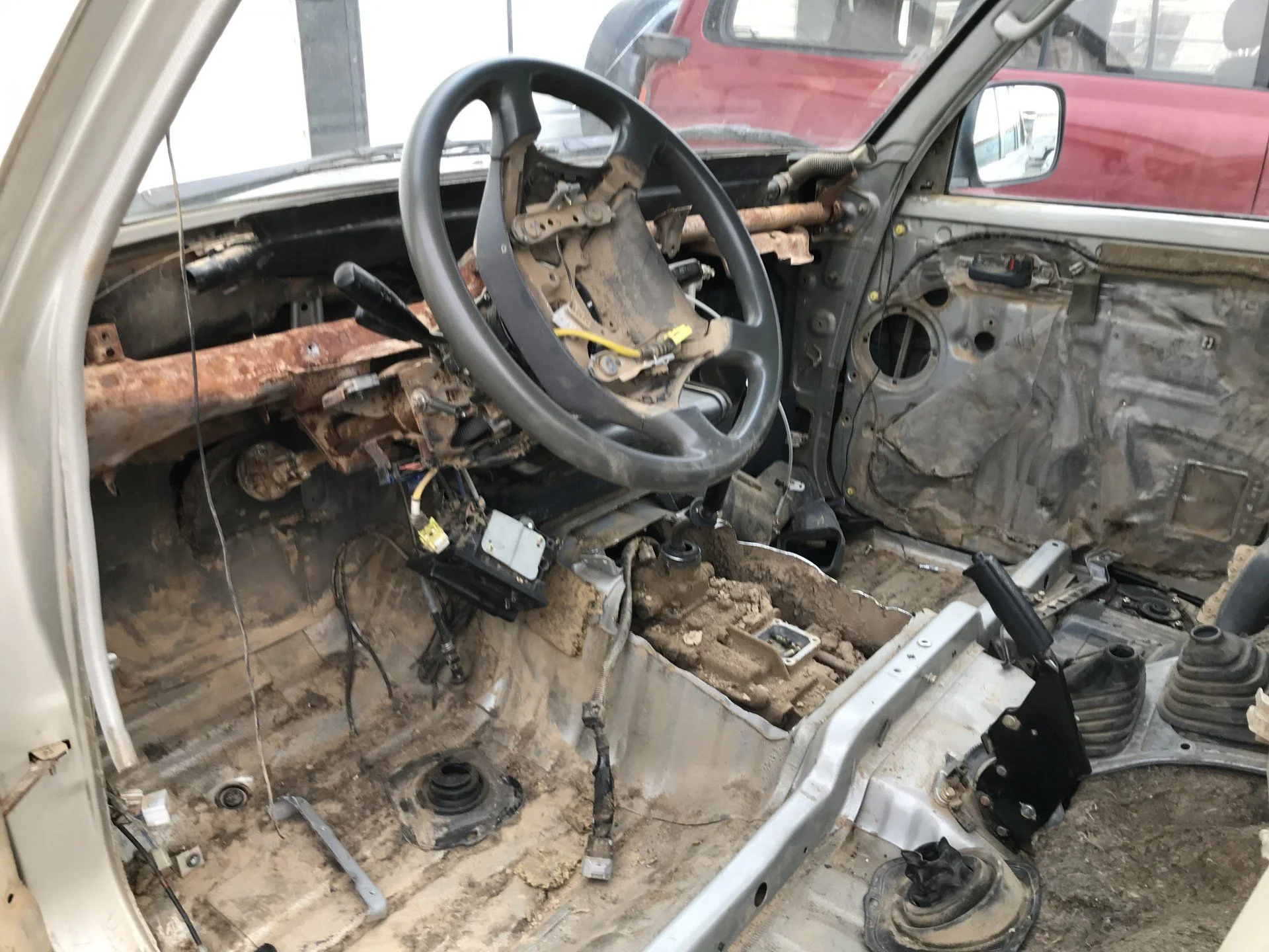

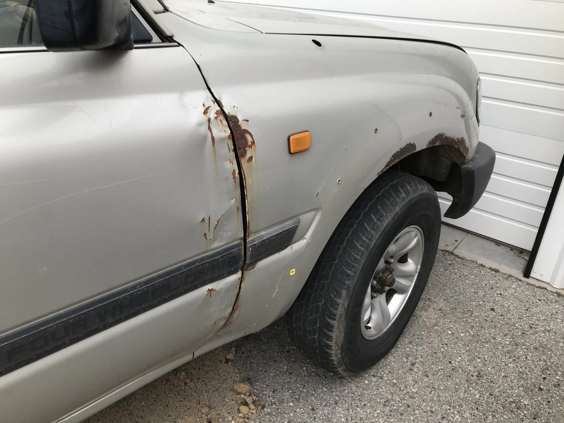

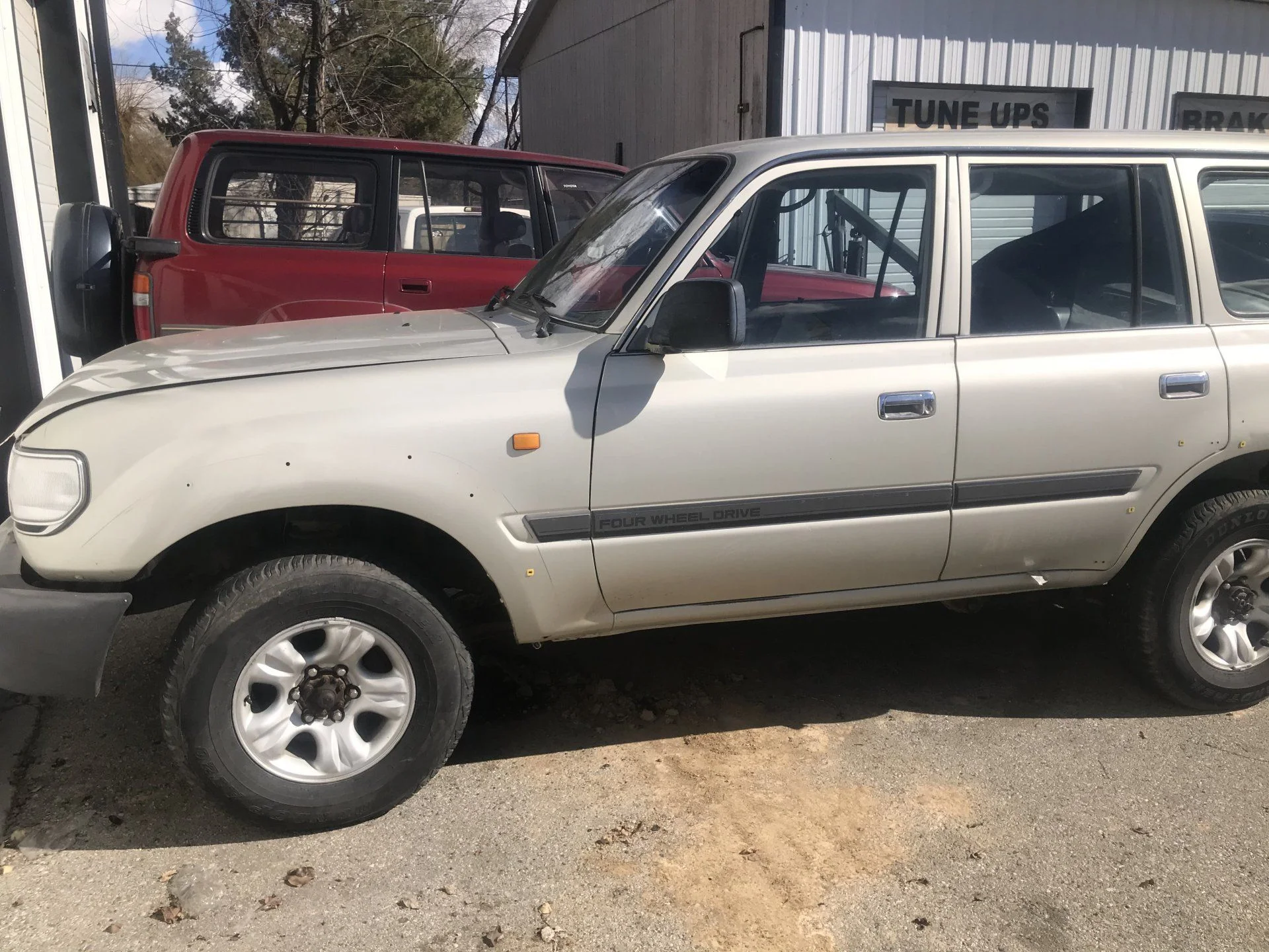

This is a 1995 LHD HDJ80 that hails from Belgium or maybe it was France. 🤷🏼‍♂️
It is a 1HDFT, H151 5spd, H2FA with x3 lockers. It is pretty friggin’ rough and extremely filthy, hence the name Pigpen. A customer sent it to us for some parts he wanted off it and now I will buy what is left that he doesn’t want.

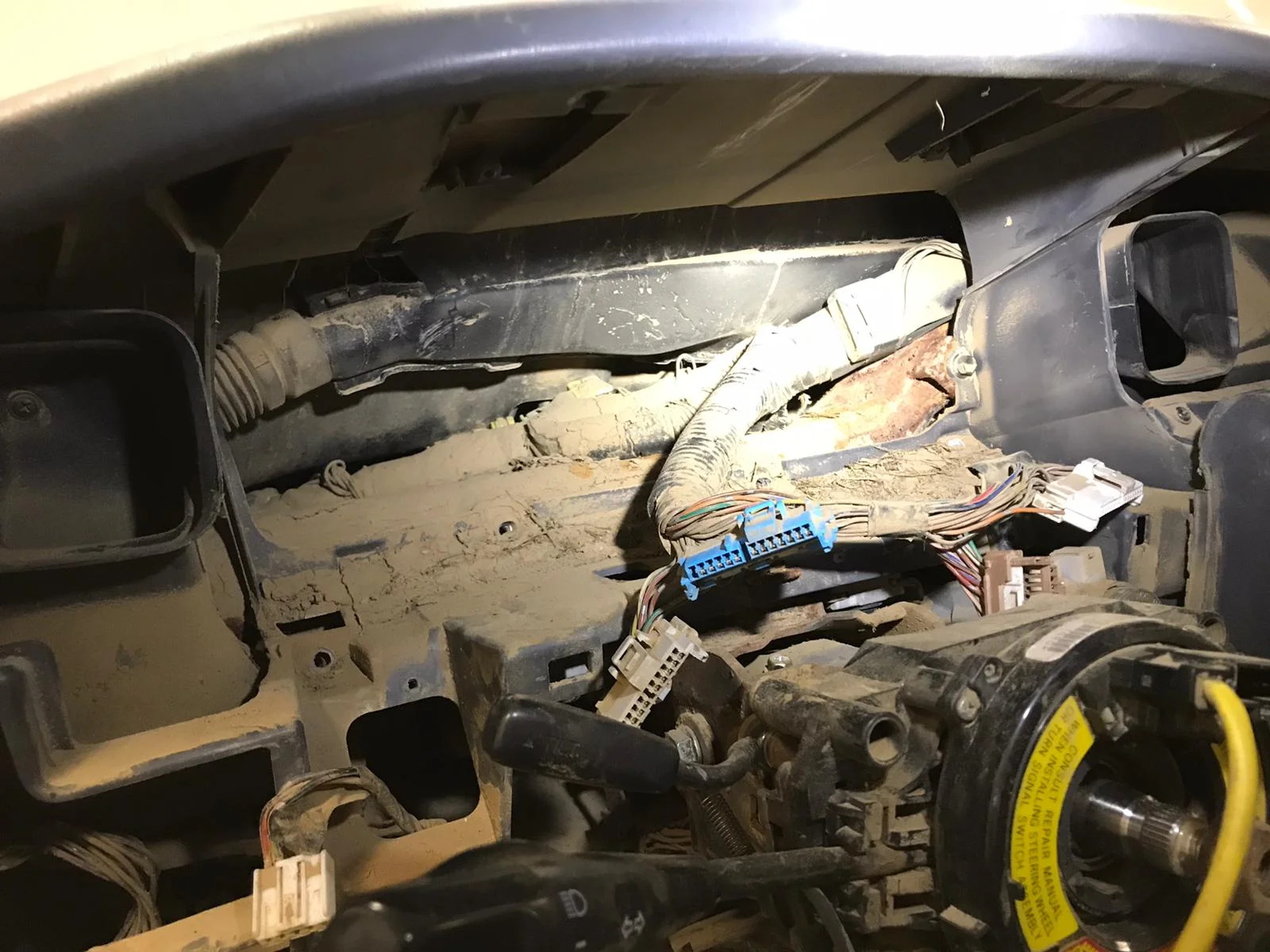

What did we take from it? Well, all the wiring, gauge cluster, few other bits for sure like vacuum system, trans hump stuff and so forth. So it’s got none of that. I do have access to a wrecked FZJ80 to scavenge that stuff from where needed.

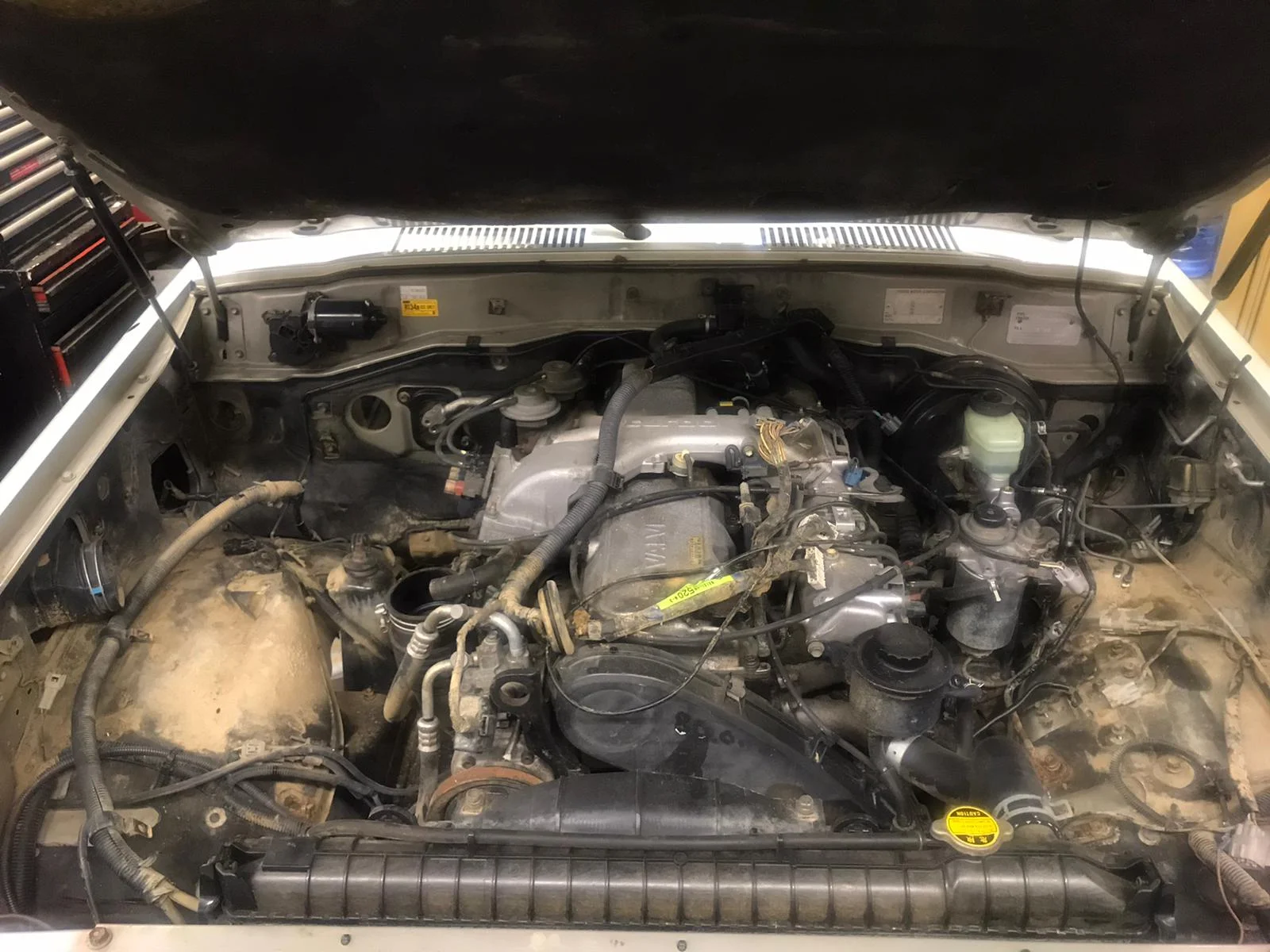

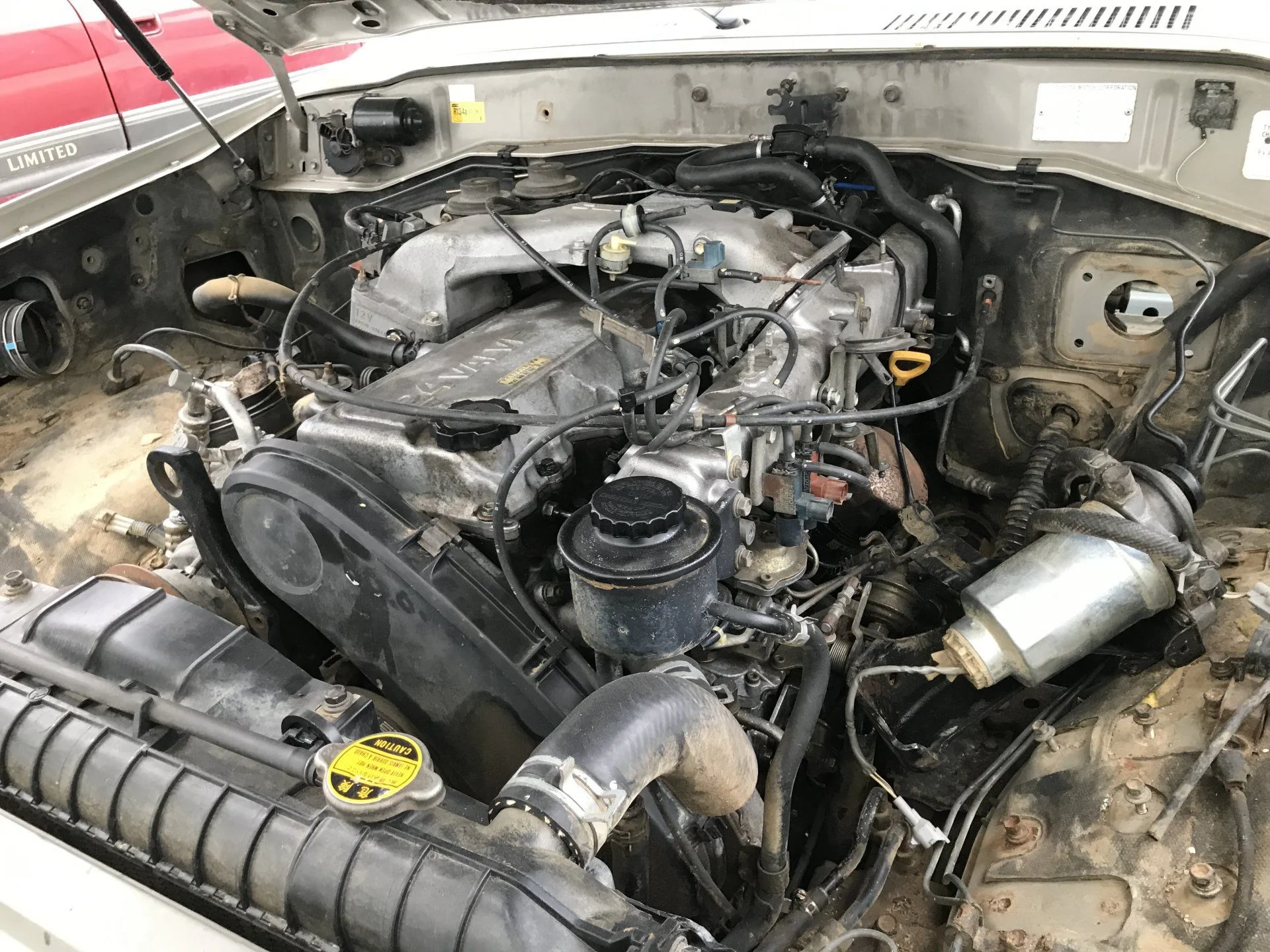

The top end of the engine is toast, it’s going to need and get a new head. No idea on bottom end yet until tear down. The engine is going to suck me dry money wise I just know it but oh well, this is a long slow build so that helps. Not planning any upgrades at the start to engine, to much cash but they will come down the road if I keep it. No idea on condition of trans or tcase, if they are anything like the rest of it, they need work too. No idea on condition of axles other than the birfields are wasted.
Going to keep the build somewhat budget until it is done and on the road. So stock turbo and boost. Probably start with 35’s but maybe 37’s. This is a fun-shop truck so being somewhat built that way. Also slightly hardcore wheeling, since a pickup is best for that or better than a full bodied 80. Less to smash! 😆
Just going to do a flatbed with drop down sides, Aussie style. Currently planning an extra-cab. Got a guy working for me who has much better sheet metal skills than me so at the minimum the chop will be a team effort. We got all we need, brake, stretcher/shrinker, bead roller, planishing hammer, english wheel, ect. We are playing with back window ideas already, at the minimum a slider but likely something cooler. 😎

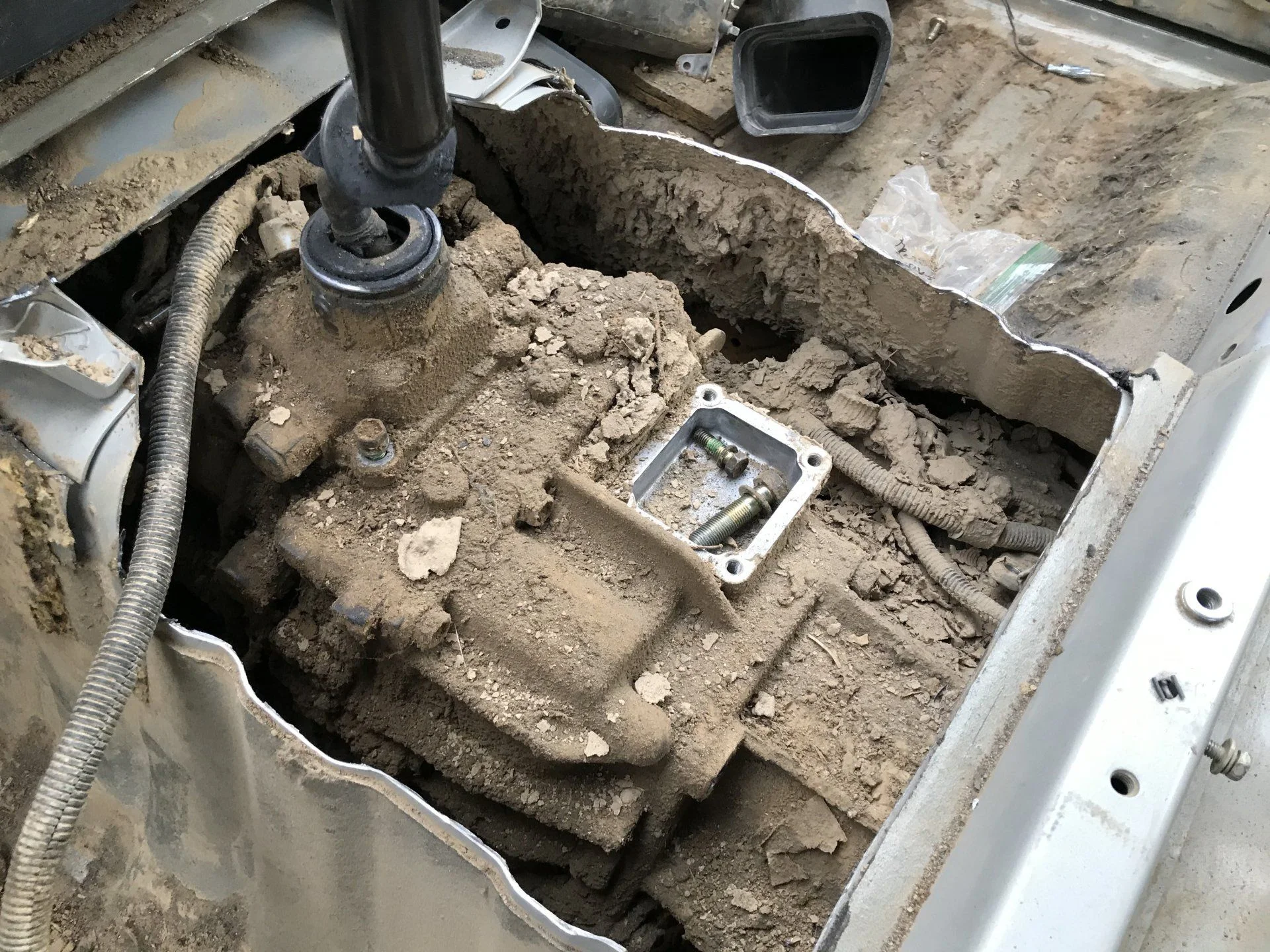

We were actually going to sell a few bits off the body and cut the rest up and scrap it. Then it hit me, Ute chop! Chassis packed with clay, like really bad, frame half full of it. So it is going to take a fair amount of work just to get rid of all that. Going to take chassis to bare metal though, probably paint it vs powder coat. More than likely stretch the frame, as a pickup I think it should have a little bit more wheelbase. Suspension already going through my head, I like custom! 😂 Going to hold back though on anything crazy like that to keep cost down on the initial build.

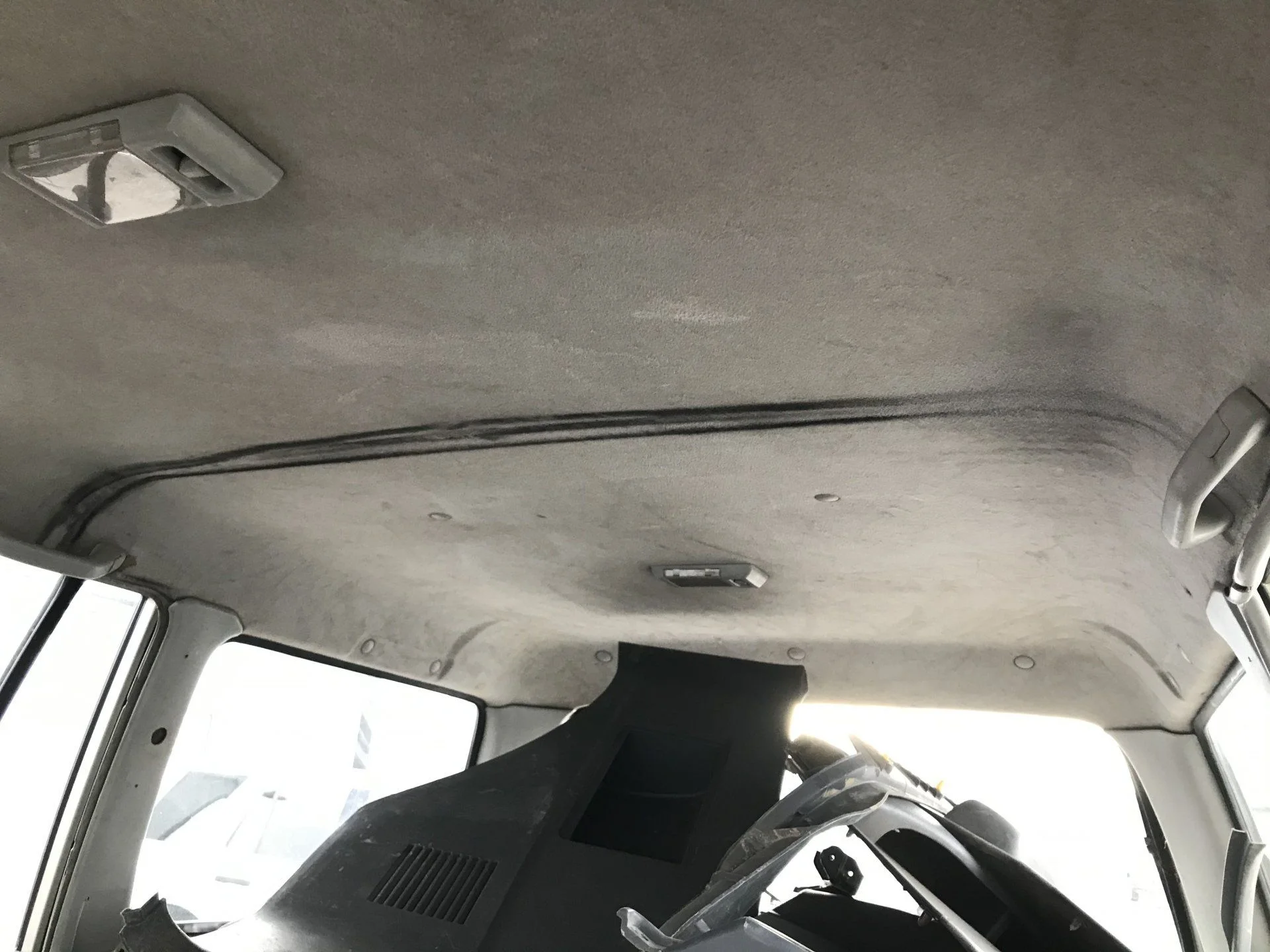

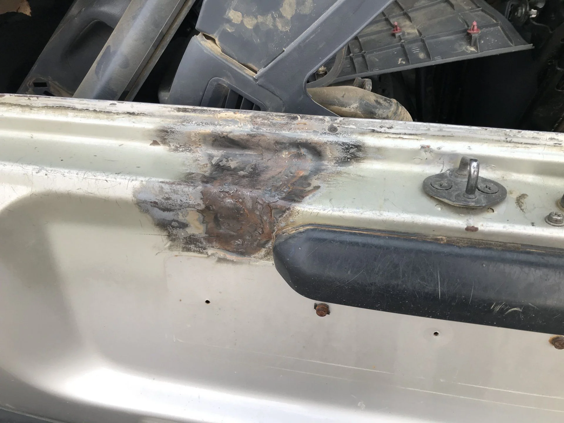

SOMEONE will buy that headliner since it doesn't have a sunroof. It would be good to recover and have one without a hole.
Going to cut it where we need for our chop. Its the least filthy up front and this truck does need a headliner too.

Wow thats dirty. Really apt name - blown away by the picture behind the cluster - where did this thing live? I know its from "france" surrrrrre!
I've seen heaps of it from out here in rural aus... bull dust will get into every nook and cranny, just the way it is
