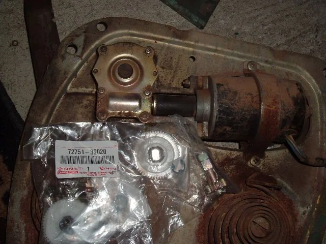

The window is "stuck" in the up position, but I just removed the guides/arms from the window stays (probably the wrong wording) and I am able to move it around and out of the way. The gears seem stuck solid, but the motor runs when the button is pushed, when going down it "knock knock knocks" put pushing it up purrs like a kitten, although it doesn't move.

For the rear window, there is a plastic cylinder that connects to the gear and this is the part that you are most likely having trouble with , it could be stripped or broken.

Good job on disassembling rear window. True, the rubber connecting gizmo between the motor and the gear may be broken. More common is the nylon gear itself. Pray for the nylon gear, it's still available from the dealer. Pics & part number on request.

Two birds/ one stone...
FJBen, yer part #
CJ, under that 6 Phillips cover is where the gear lives...

That gear is a crucial part of the entire FJ55! Fortunately it is available from Toyota and is not that expensive. Most tailgate issues are solvable and do not require replacing the entire motor. Rust, obstructions, electrical stuff, previous owner screw-ups are usually to blame. The Pig gate glass can be hassle for owners, sometimes extremely frustrating: its such an important part of the truck. Once you have it figured out they seem pretty reliable. My glass zooms up fast: a bad device for little kids if they suddenly stick their heads into the action. I caught my dogs head in the glass once and she was not too happy about it...

YES! It is the nylon gear, and my dealership had no idea what I was talking about, and "Steve" said I should call back when another guy is there, what can you expect from a place whose spokesman is John Elway !?!?!?
