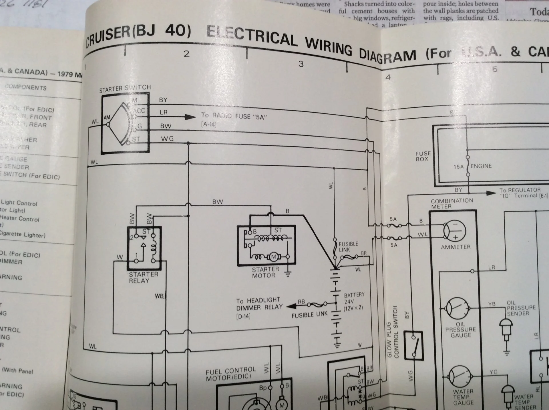

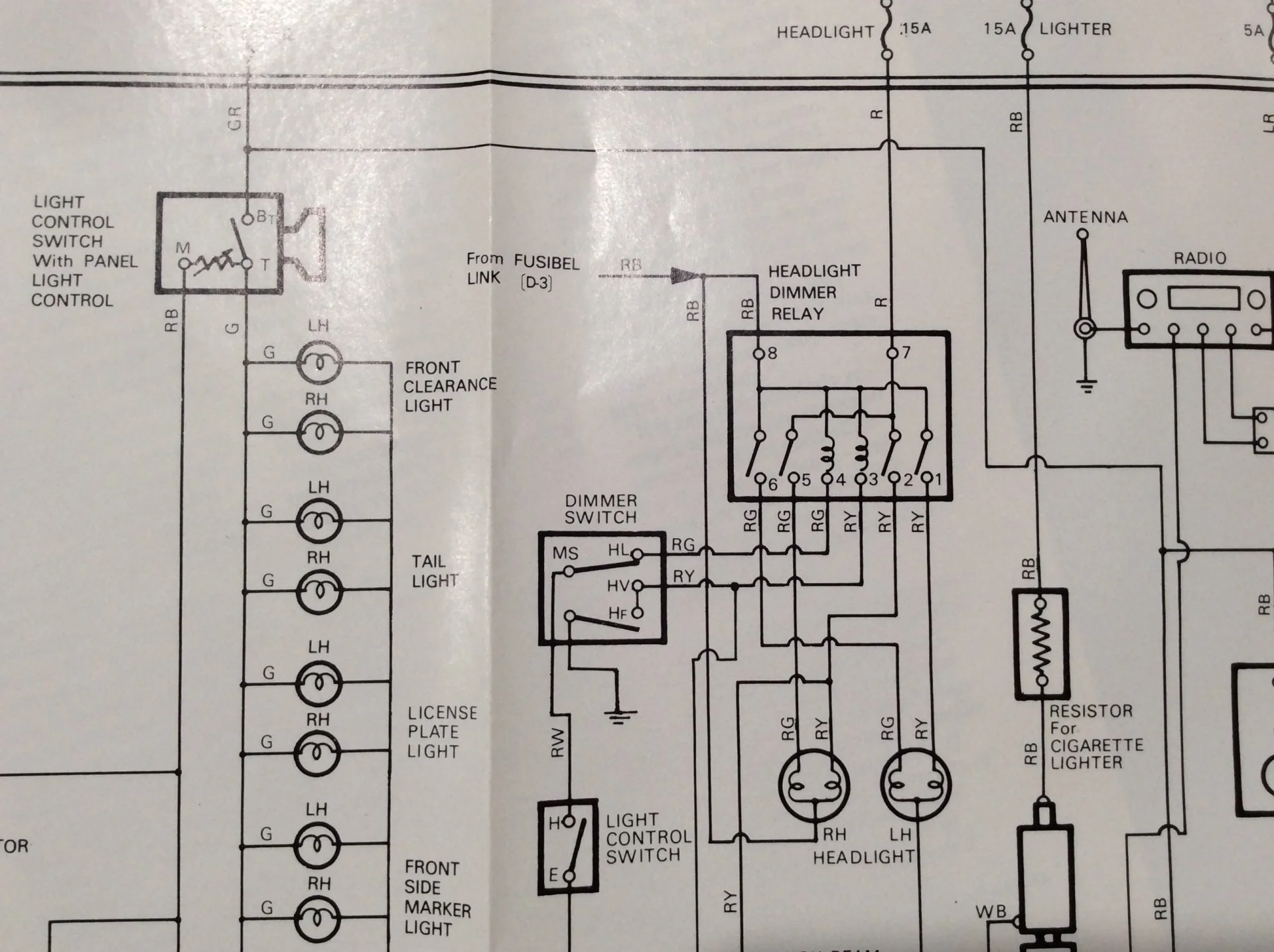

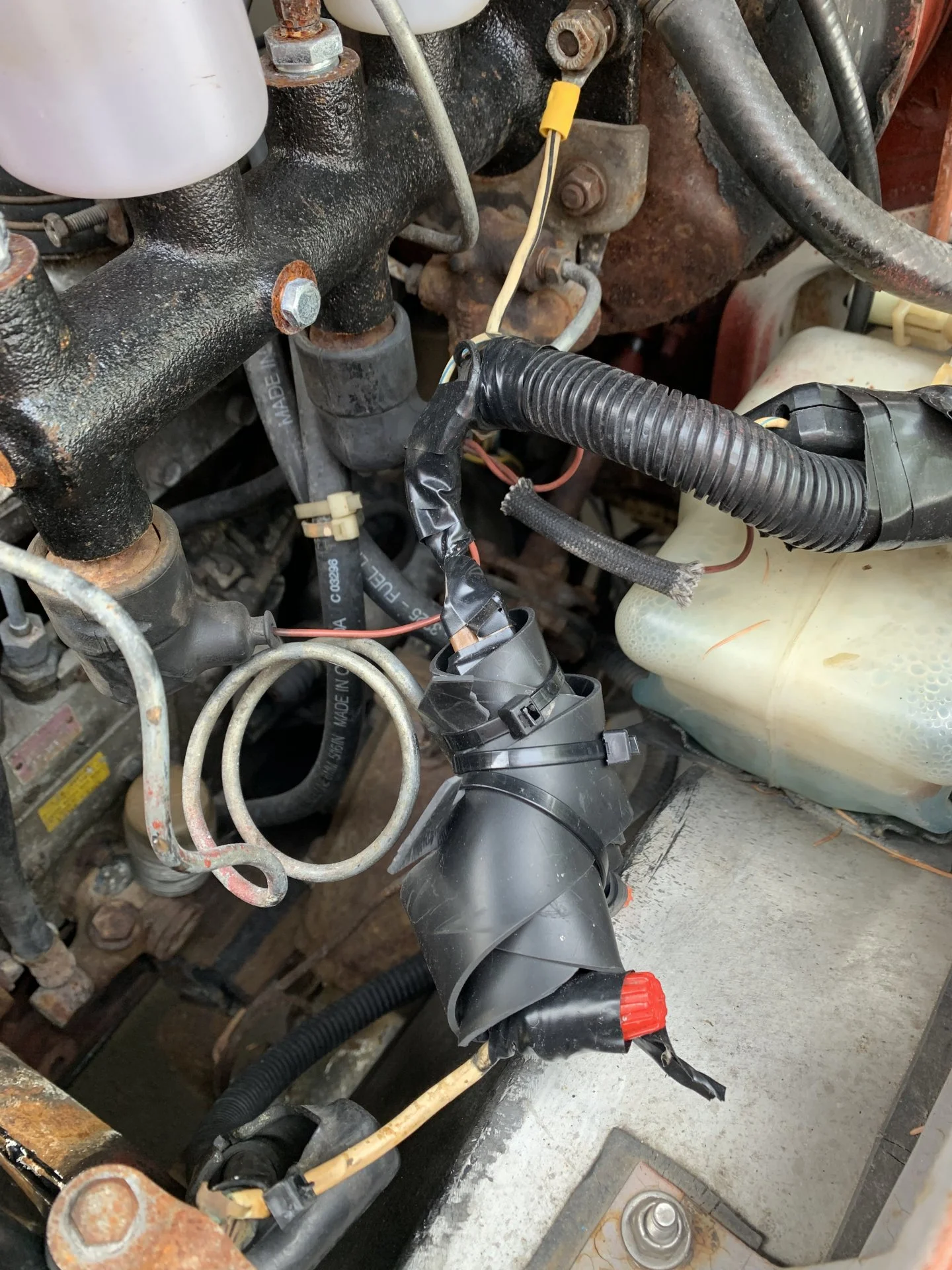

I am looking forward some pictures for the wiring for the fusible link for a 1980 BJ40. Need to clean up my set up
