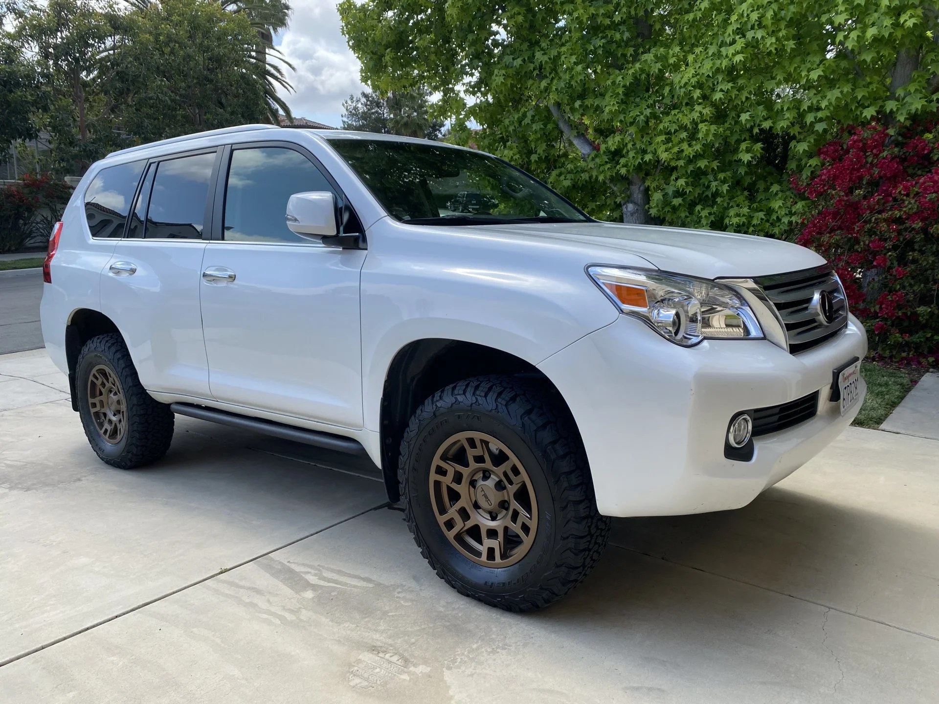

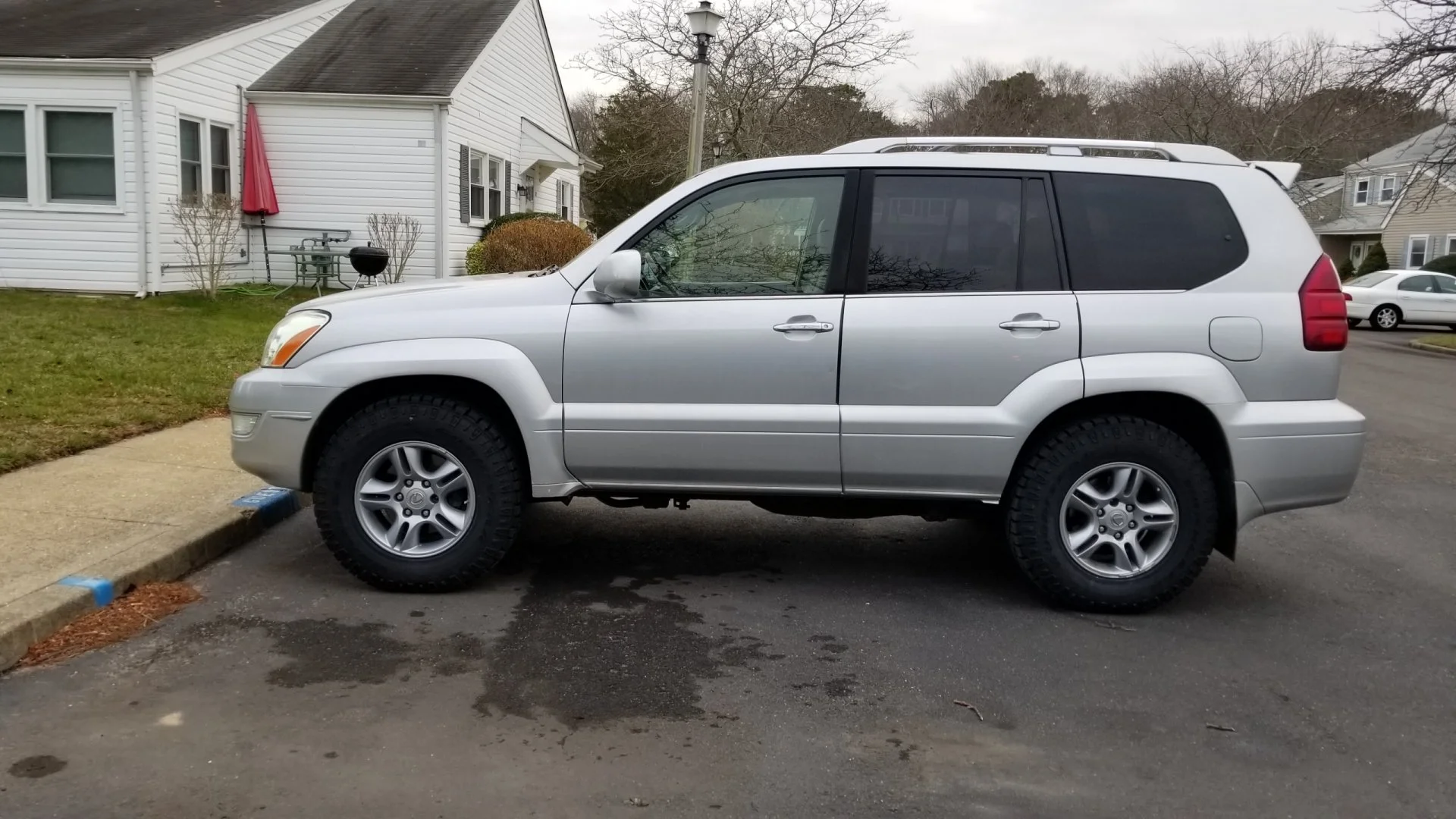

Here you go…
this was on stock suspension (BFG KO2, in 255-75/17 flavor) before an airbag blew and I went to Ironman FCP’s.
I had some slight rubbing, in reverse at full steering lock, ON ROAD.
Never took it off-road on this configuration but guaranteed it would have substantial rub.
