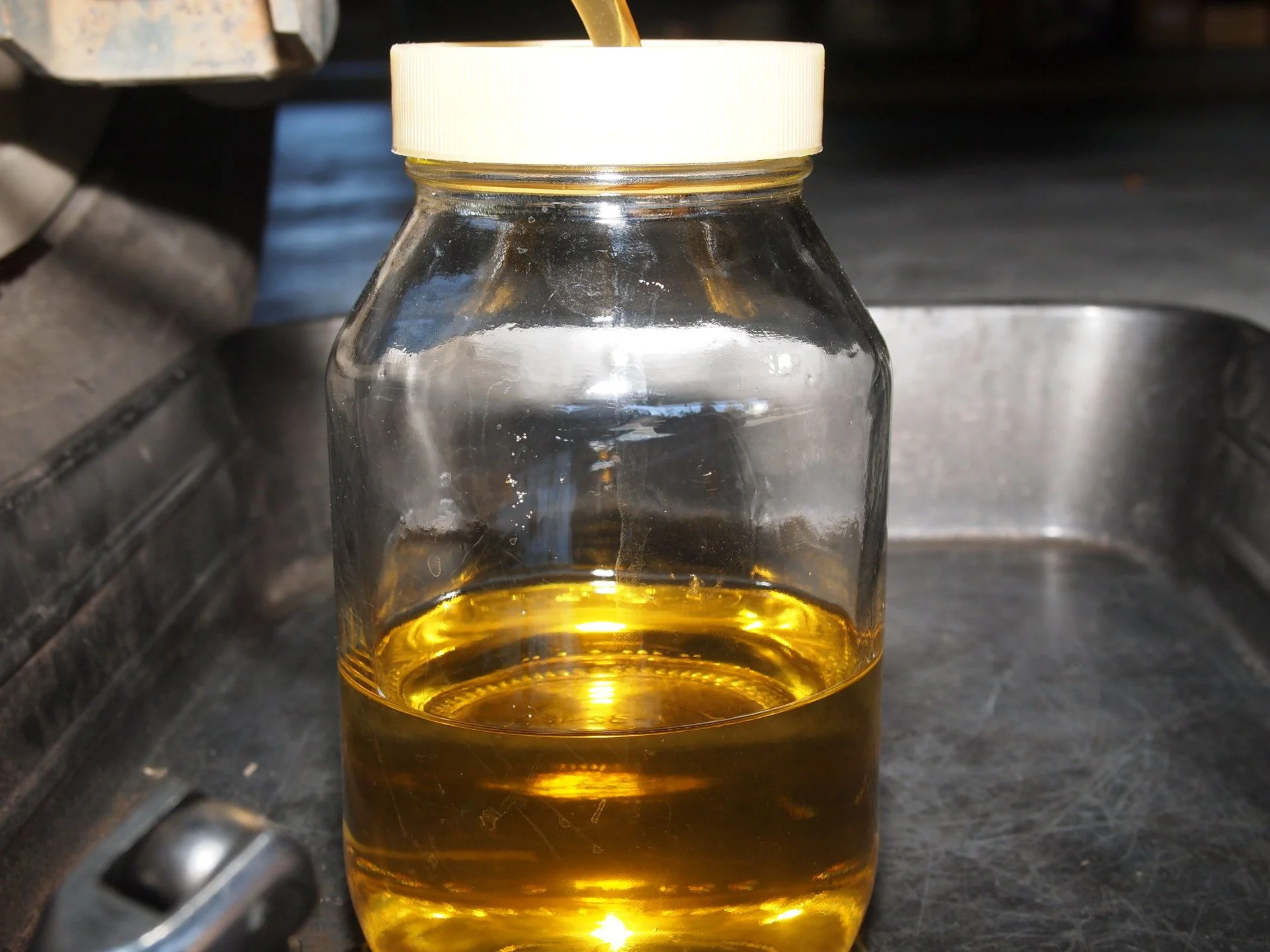

What fluid are you using that’s yellow?
Looks yellow to me. What am I missing?
Unless the PO flushed it with the wrong fluid.

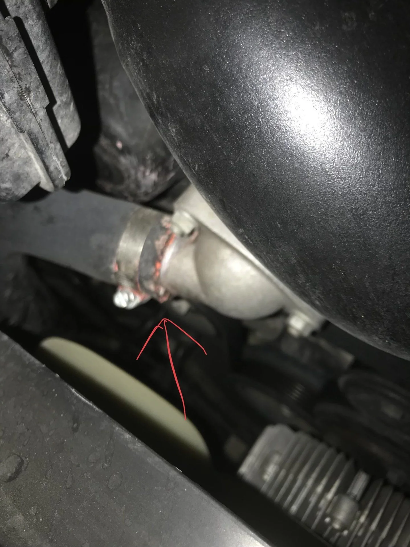

My coolant leak originated here:
Coolant ran down the under side of the hose and terminated where yours is. Took me forever to figure out the source.
The fluid will darken pretty fast. It may look yellow, brown or black as it ages. But if any doubt of what is in the system or it's condition, flush it. It's easy! Again here's a link Steering Flush & Cleaning

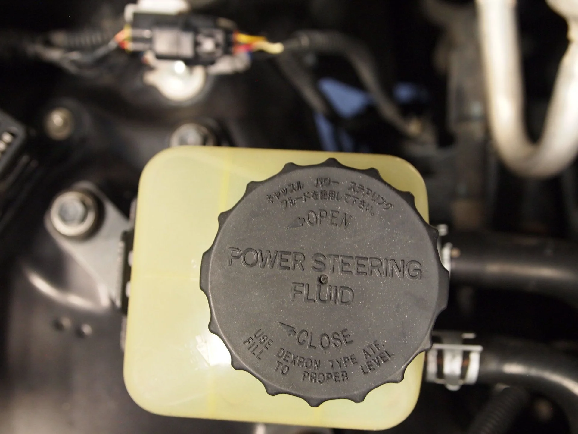

The OP location of red fluid does point to leak at or around PS reservoir. A PS pump leak will travel back along parts like the suction hose so that also need consideration, but usually not so high it's seen on upper end of brake line. Toyota red coolant is also red, but OP stated oily and it looks oily, which also point to ATF. There is also transmission cooler lines in area but they ride lower, but could spray up I suppose. As bad as his leak is, it should be easy to find. Something is low!
Again ATF fluid starts out red. Cap on Power Steering reservoir states Dexron ATF

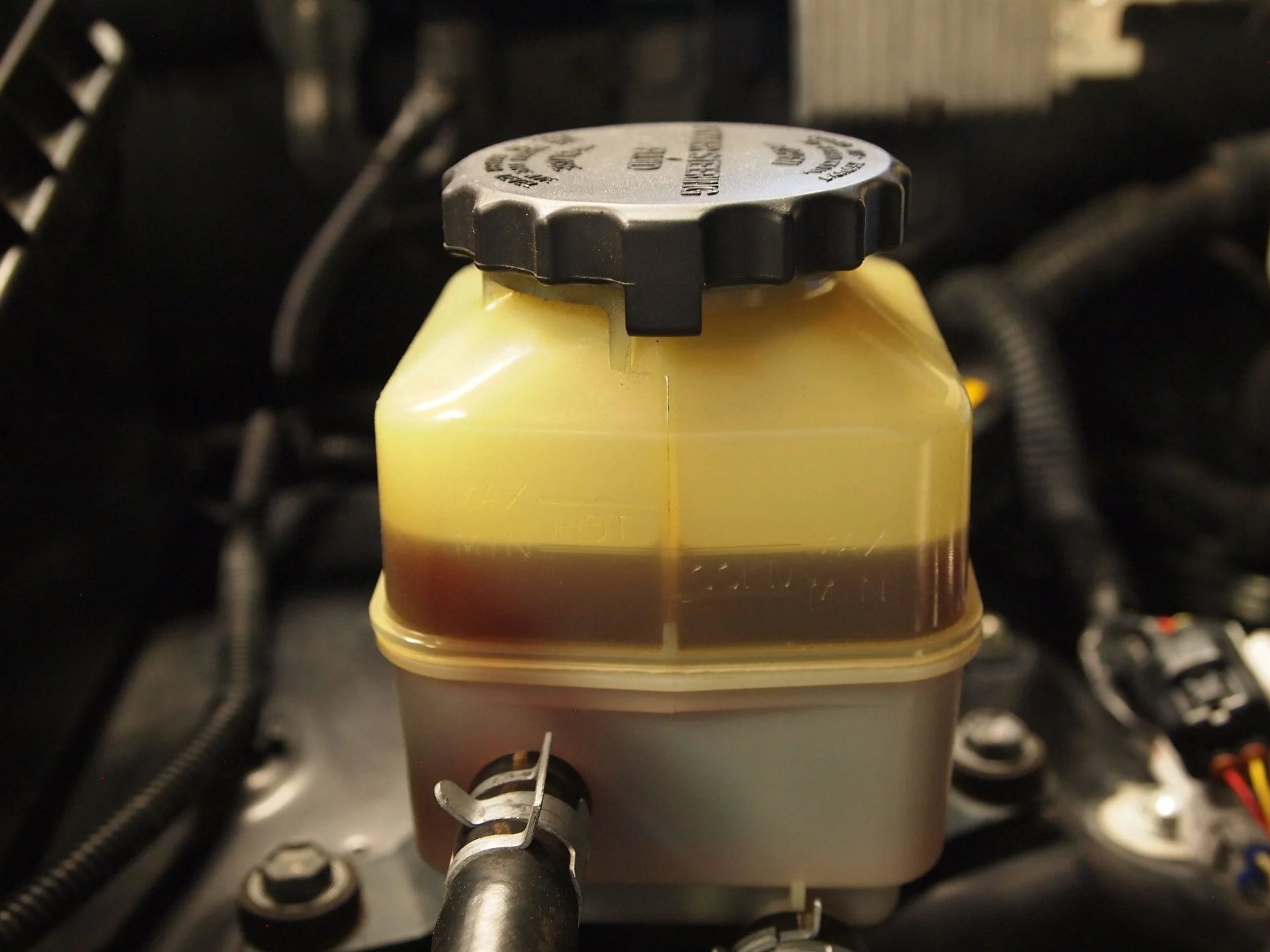

One thing that can really be misleading is how level looks on side of reservoir. I've often seen the reservoir so dirty or stained internally they look as if level is dead on when actually low.
Here's clean and correct level in a 100 series power steering reservoir.

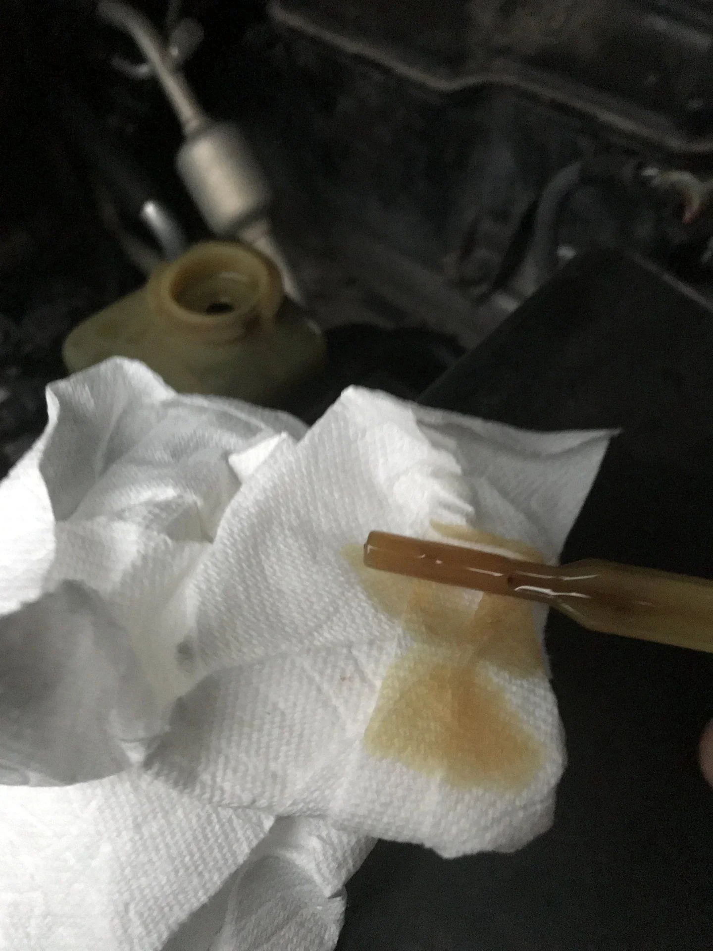

Here's brake fluid.
Fresh
Old
That's a fairly common leak. Causes can be; bad hose, pitting on inlet housing goose neck, aftermarket hose. Often someone will put on aftermarket (screw clamp) clamp to try and stop leak.
Im thinking its the coolant that was leaking and running down the brake hose. When I dropped it off at the dealership, i noticed the temperature gauge would rise fairly quickly every time I pressed the gas pedal. I also knew the leaking fluid was pink.
