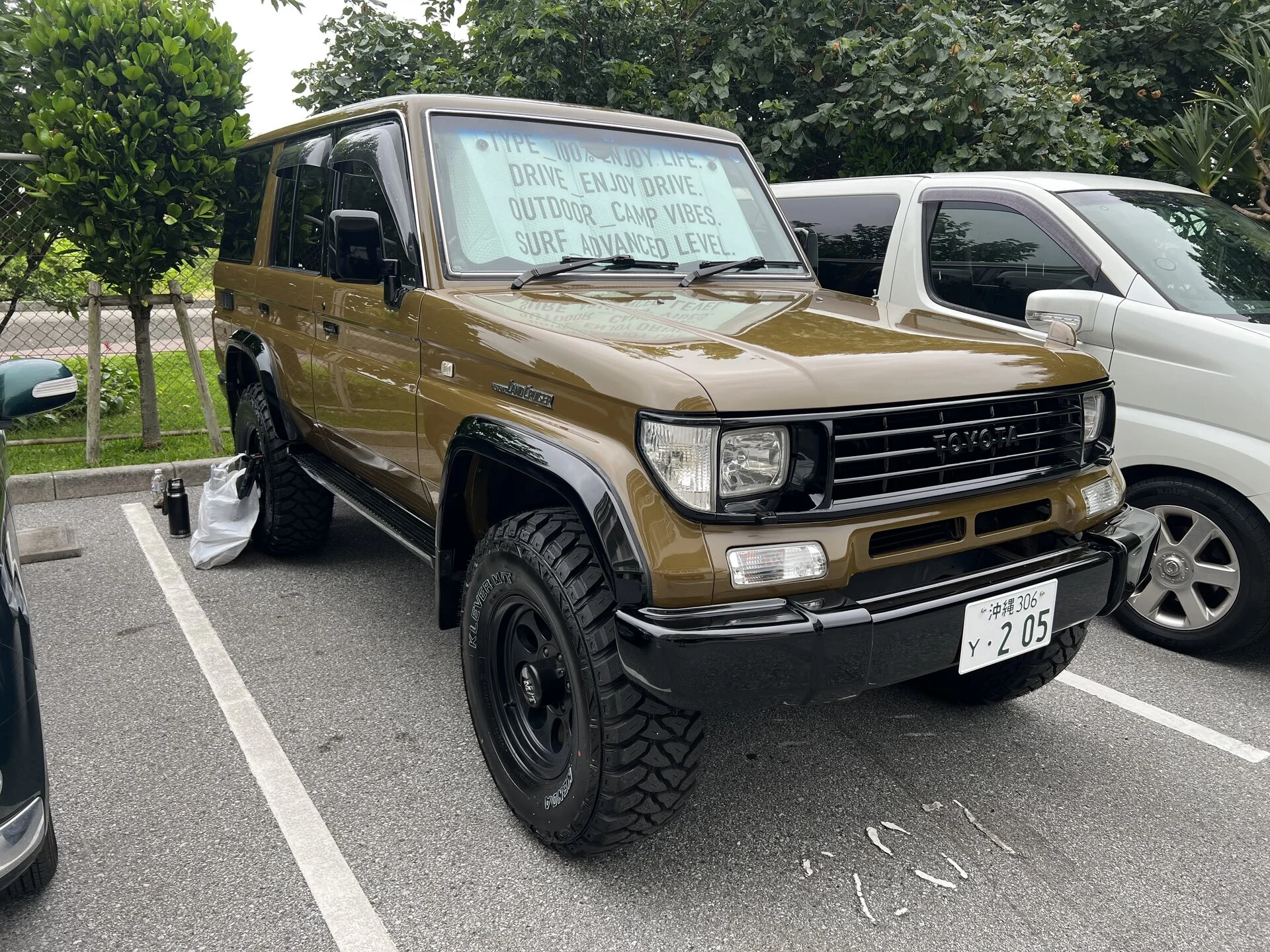

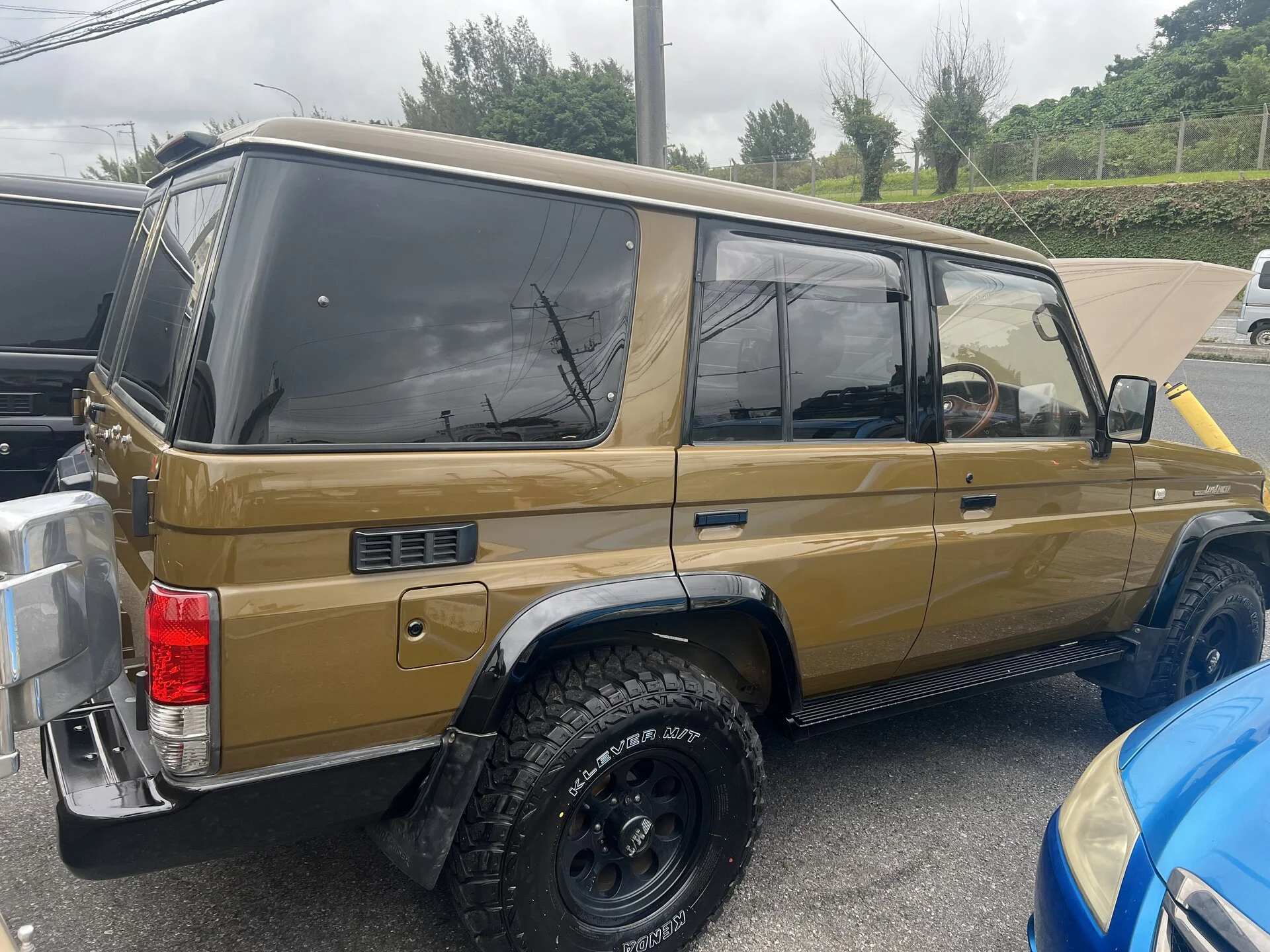

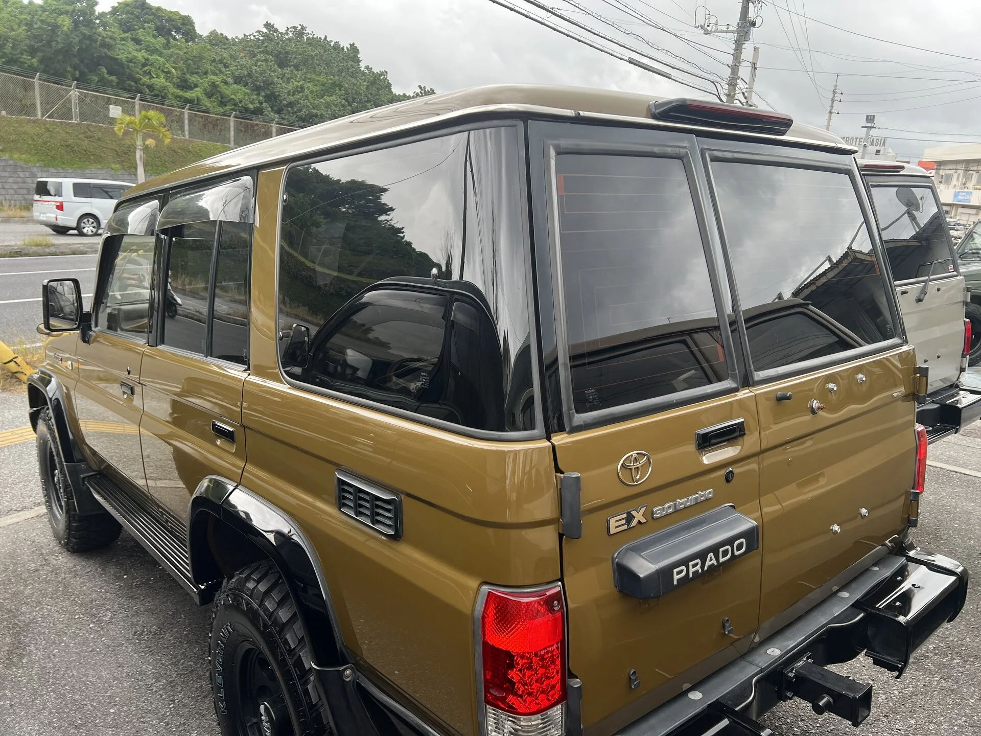

I was able to pick up my new to me KZJ 78 today so I guess it's time to do an intro post. It's a 1995 with 242,000 km on it. I'm stationed in Okinawa, Japan and decided to pick up a Land Cruiser to bring with me back to the States in a couple of years. It seems like it's in pretty good shape. There's a few things I want to fix like a floppy passenger side visor, broken vents, cracked stereo surround trim, ect. I'm definitely going to have to upgrade the speakers. I'm not really an audiophile and am generally fine with factory stereo but these sound pretty tinny and there's a bit of crackle to one of them. Probably one of the harder to find parts I know I'll need so far is the trim piece for the sun roof. Luckily it works fine with a cracked one but I'd still like to find a good one if I can. It's got Kenda Klever M/T LT285/75/R16s on it which I'm sure are great for a mud tire but I'll need to find something more all terain oriented since I won't be taking it on any trails out here. There's plenty of them but they're much better suited to a Jimny or the like. For the next two years I'll be working on making it as bullet proof as I can before I take it off island and it gets much harder to find parts.
Interesting color. Looks very clean. 👍

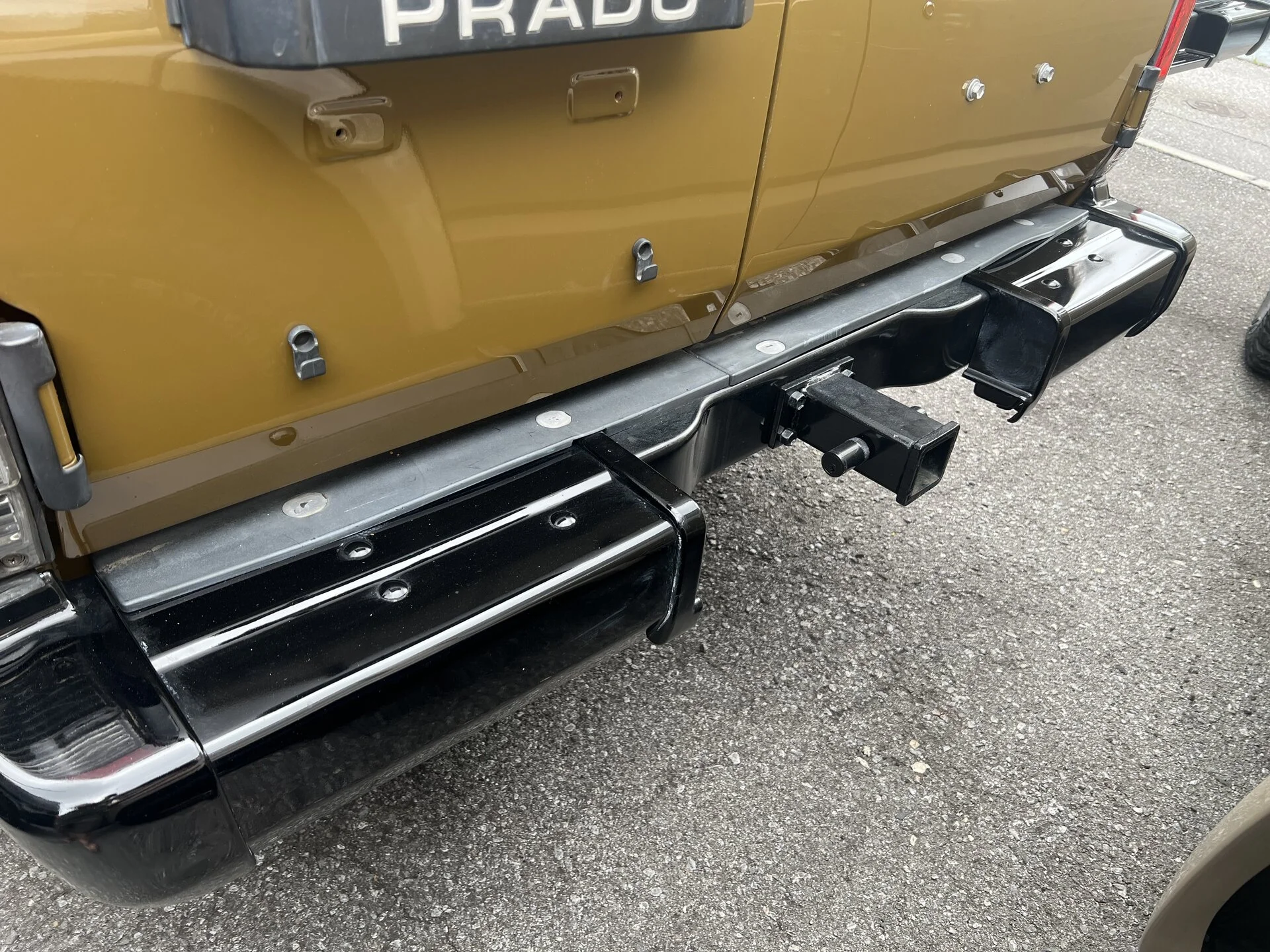

Dig the looks. Especially that de-chromed rear bumper.
