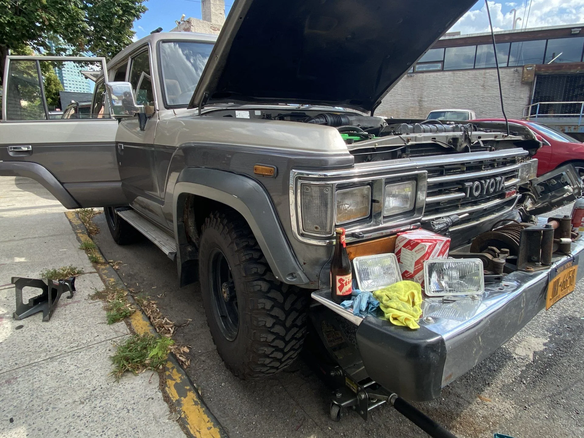

- original Koito. headlights were rusted through and had me driving to Indiana with high beams as my lows. Recently changed out for Hellas for the win thanks to a thread on ‘semiscientific headlight test’
And a great deal on eBay.

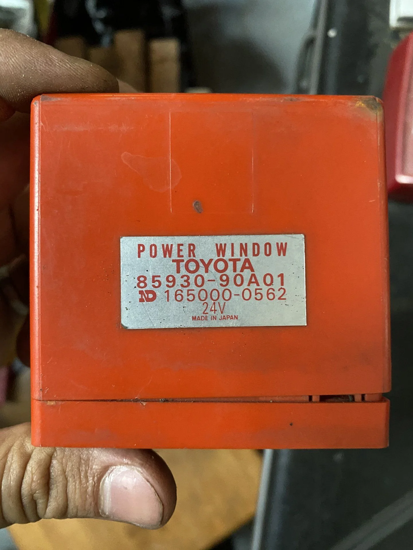

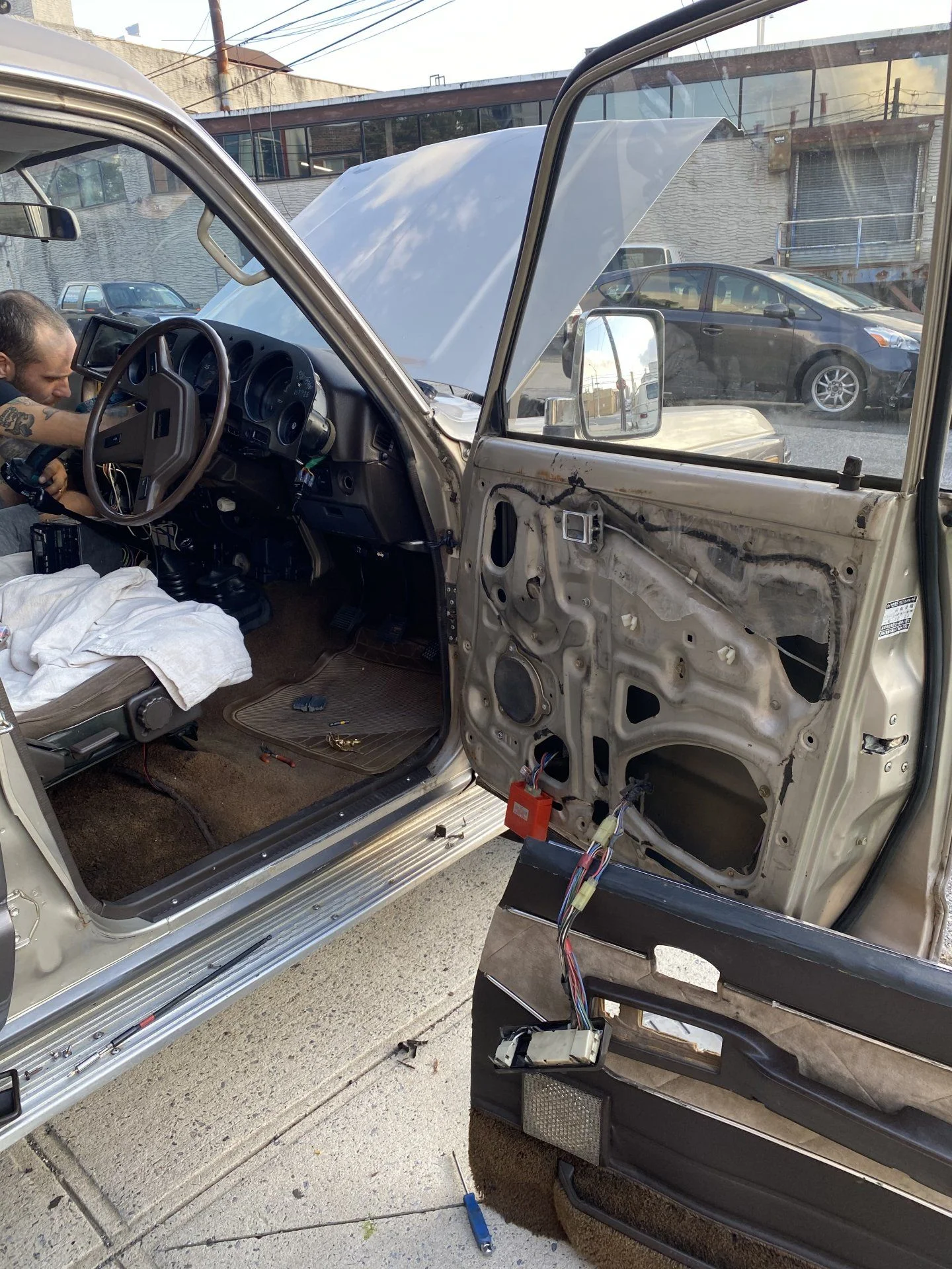

-drivers window didn’t roll down when I got it. Opened up the door and found a short in the original harness with the multimeter. Opened up the oem relay box to find the arc in the box had split. Tried to bridge the gap with dialectic grease to see what happened; blew a fuse in the ‘power box under the hood:no dice. Had me scratching my head until I traced some aftermarket electrical to a 12v motor switch under the dash. Rewired that And cleaned up some of the previous connections. Still want to trace that short but at least I have natural ac on the drivers side now...

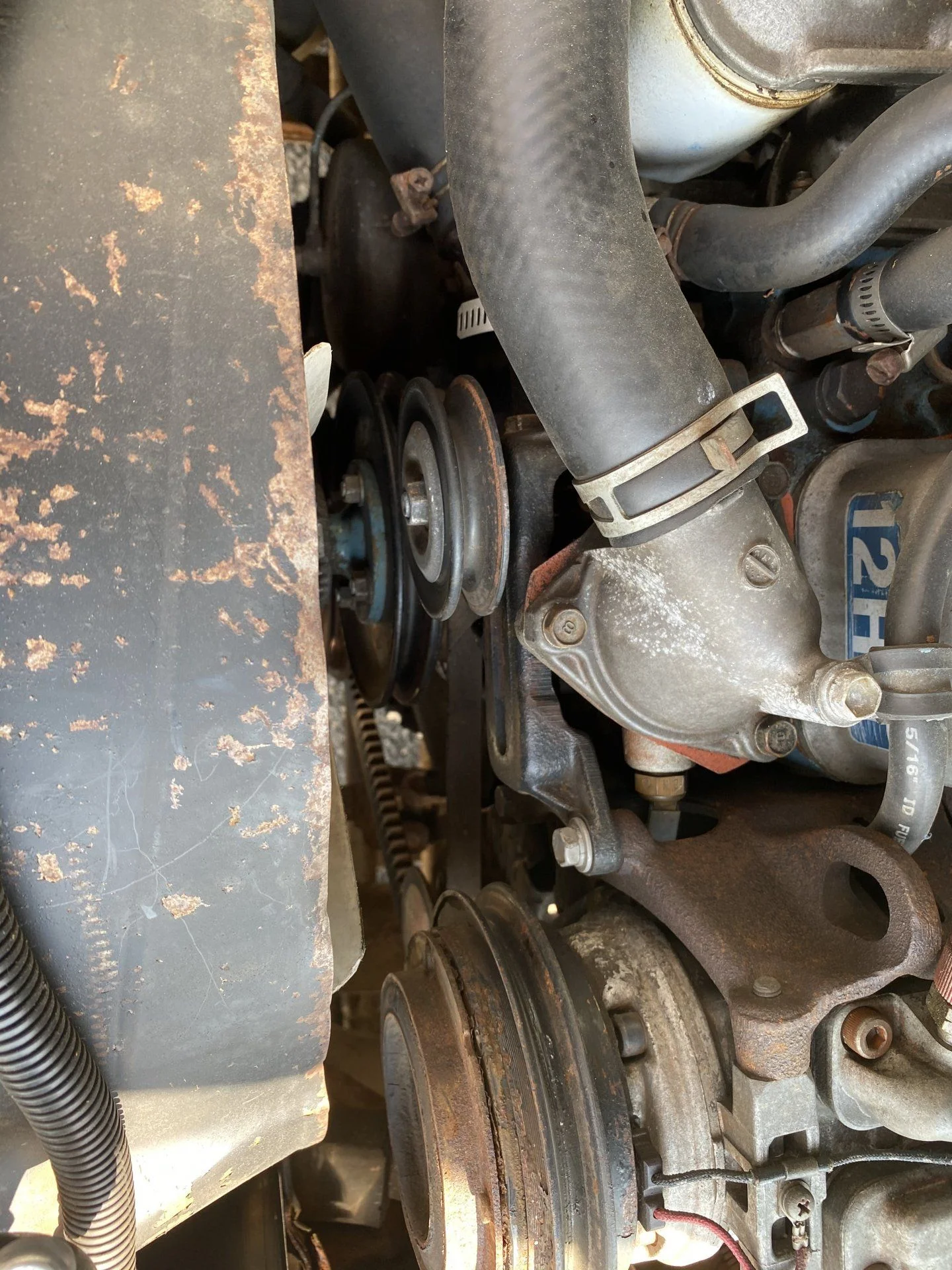

.....Oh yeah, coming up soon is finding an ac belt:)
And likely changing all the belts while I’m at it

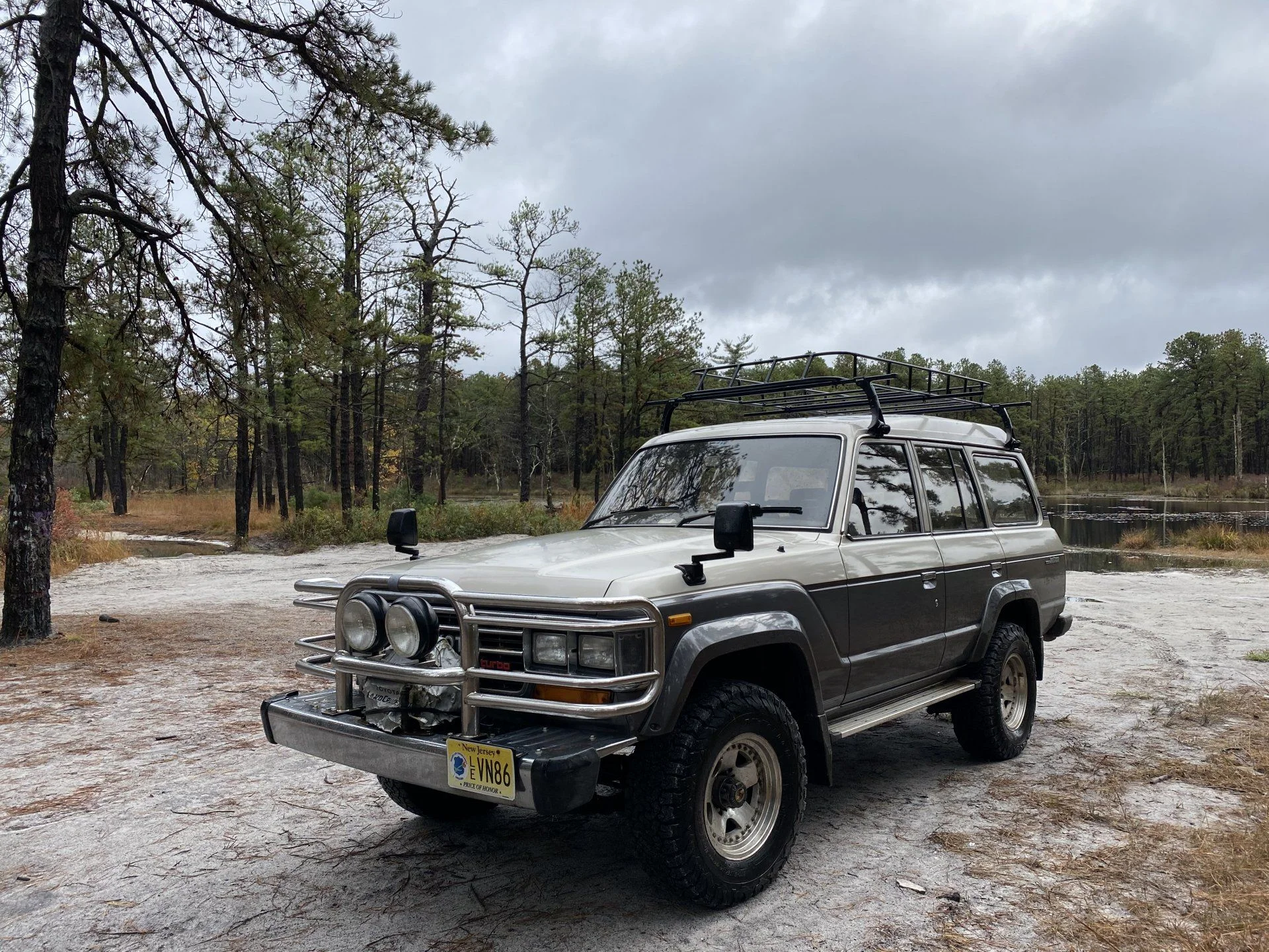

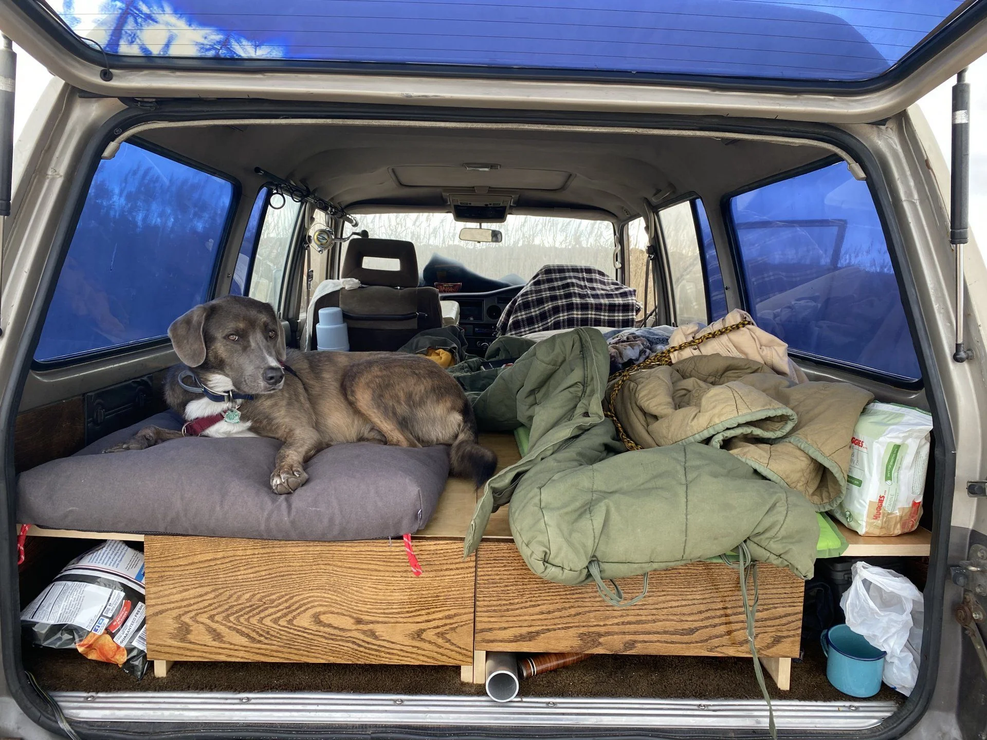

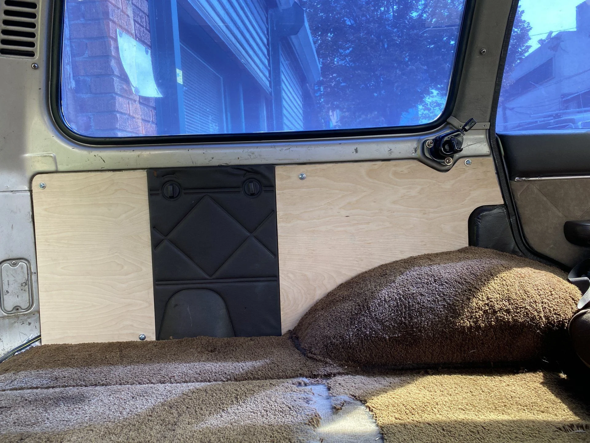

currently building a drawer set to go out and utilize my 4x4 fishing permit in montauk. Striper season is soon to be here!

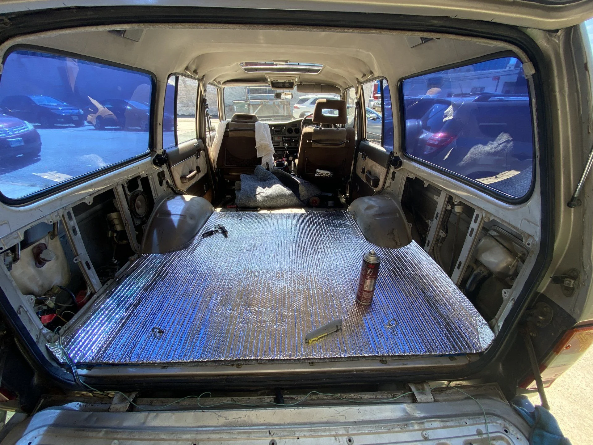

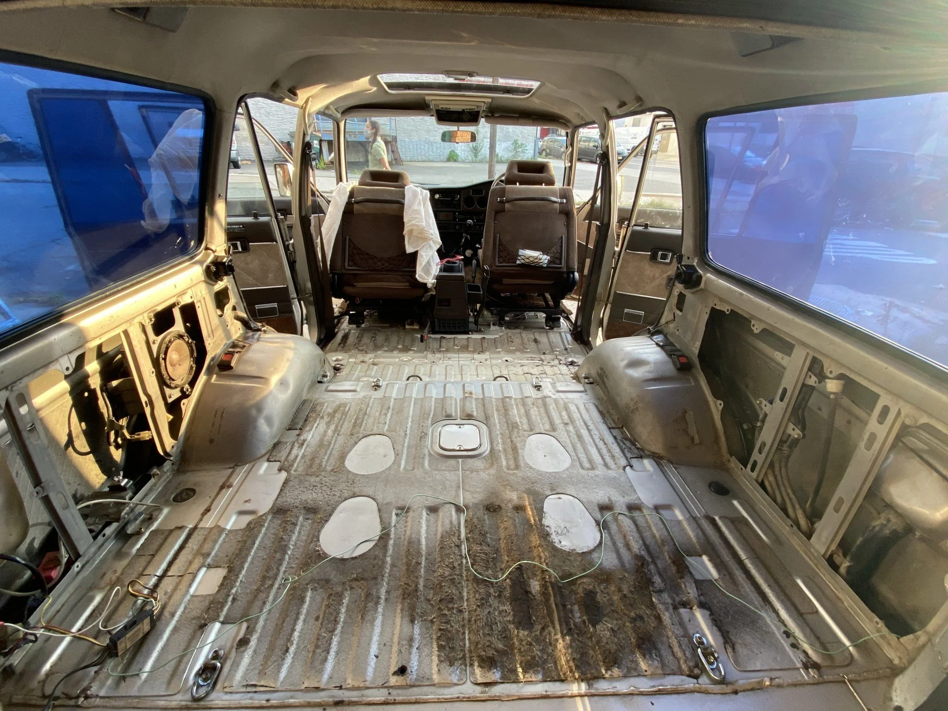

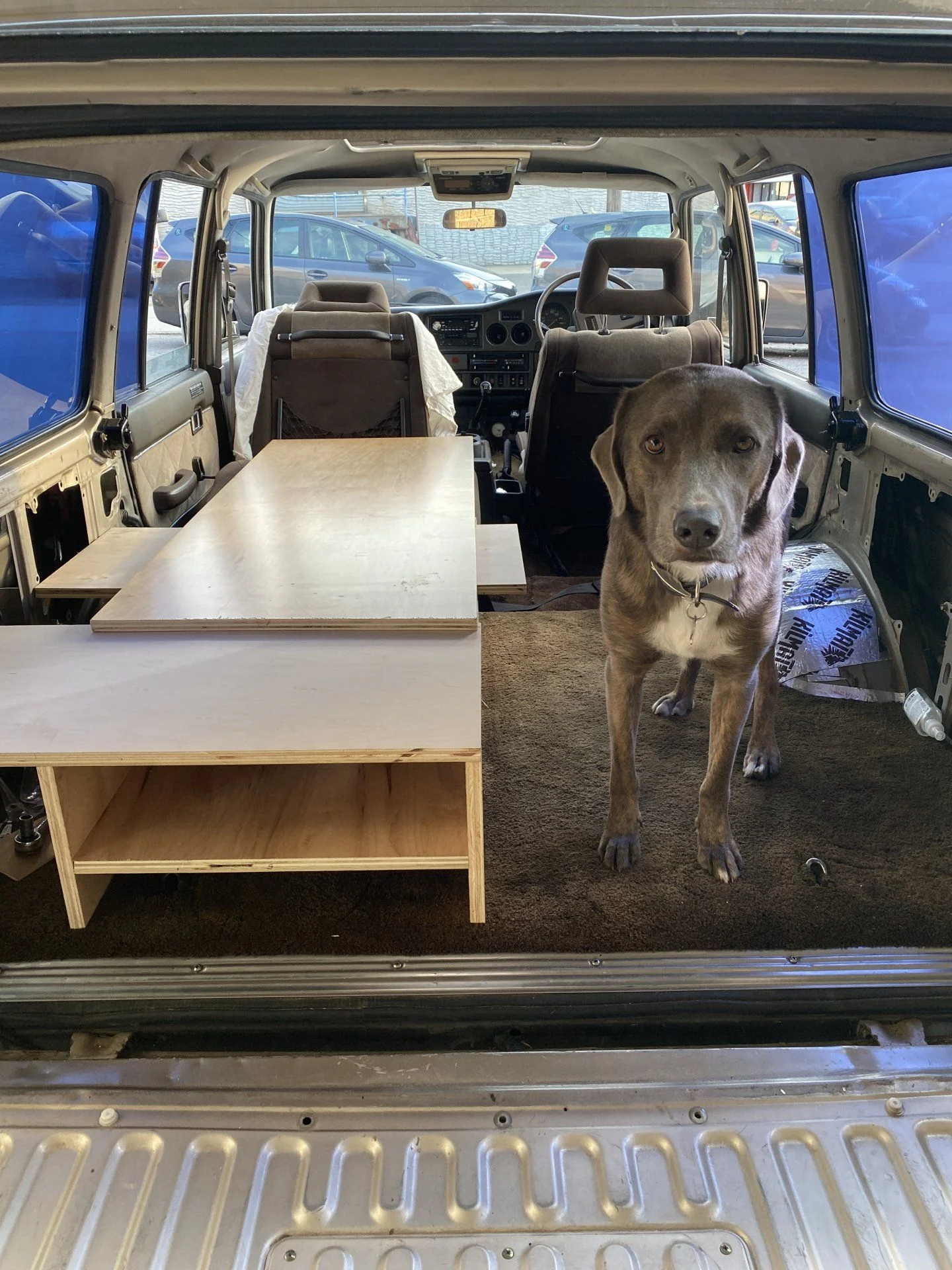

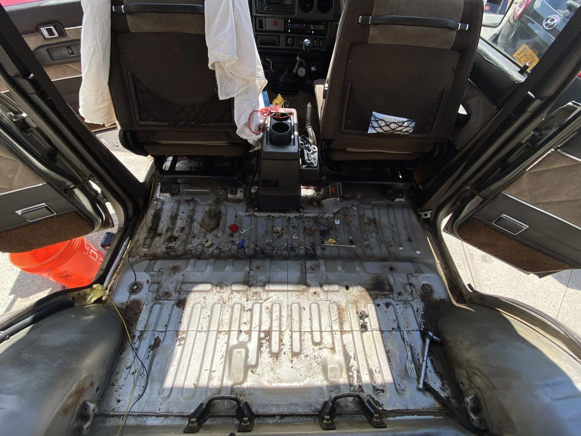

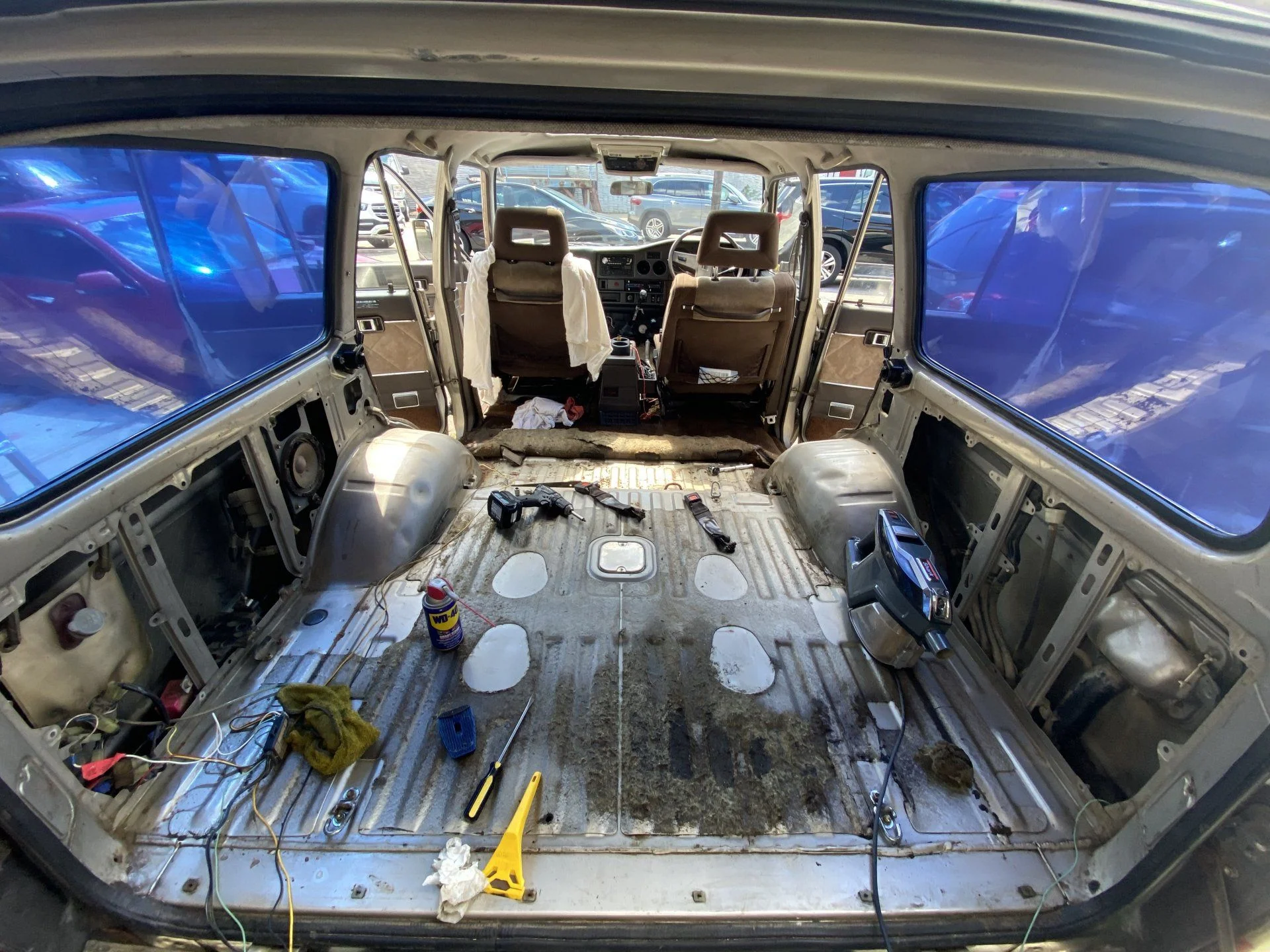

decided to clean the carpets before laying wood on top. Pulled the carpets, underlay was filthy. Tossed that and found myself down to bare floors. Installed new insulation and cleaned old carpets sound proofed the rear wheel wells and inside the vinyl panels in in the back.
drawers are finished but have to figure out a system for extending the sleeping platform over the rear passenger seat. First time doing something like this so I’m taking and making the plan as I go along.
looking good so far!

have you found the belt P/N?

picked up a set of belts from Napa based on the make and model but have yet to install. Will keep you posted.
sound deadening was a huge difference. Also kept it much more insulated.
