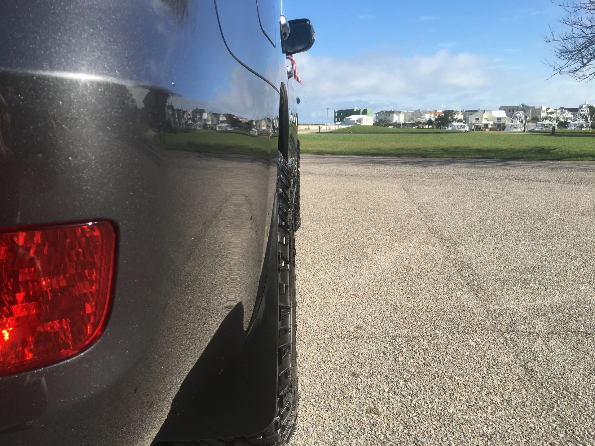

I have Method NV305 18x9 +25, tires are 295/65/18 33 inches tall and 11.6" wide here is a picture of how the sit
