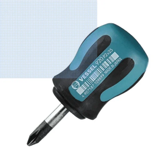

If you are working on Toyota, Lexus, Infiniti, or Nissan, and you see a screw that looks like a Philips, it may by a Japanese Industrial Standard (JIS) driver.
Here's a video about the different between Philips and JIS. JIS will not cam out like a Philips. After I started using Vessel JIS drivers, I stopped stripping screws. I use JIS drivers for everything now.
I use them also. Wished I would have known about them years ago. Vessel's impact driver is the schnizel when removing old rusted bolts with JIS heads.
Yes, I'm thinking of JIS as sort of in between Phillips and Pozidriv. IIRC they still have tapered ribs.

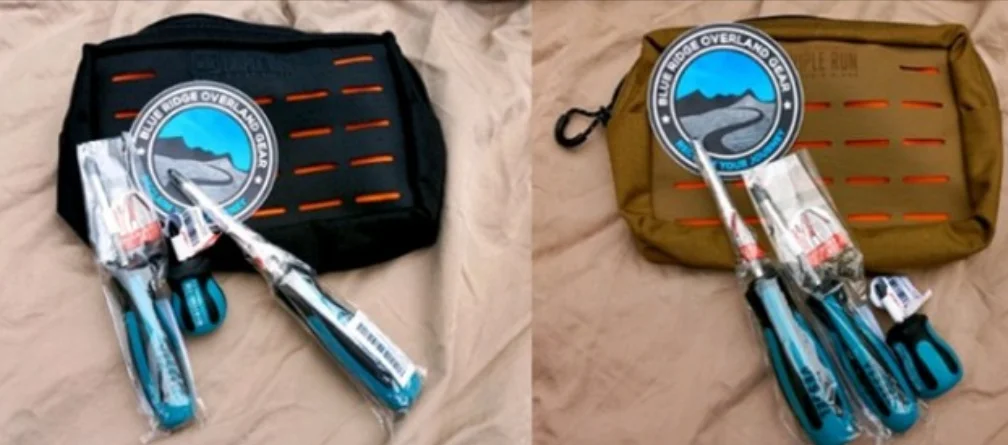

Toyota Trucks of Arkansas FB group gives away three JIS drivers (1,2, and 2 stubby) with a Blue Ridge Overland Gear (BROG) bag to the most active member each month as a way to promote good Toyota maintenance practices. They have given away 14 or 15 sets so far. facebook.com/groups/ttark
