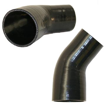

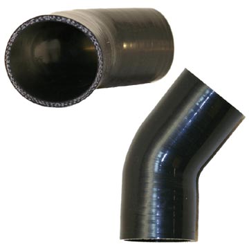

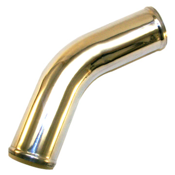

Now dear readers please think better of me than a pink intake hose would imply there weren't any other colors availible and its better than running the turbo open or through a stocking... But fear not it will be replace with the following upon my arrival. Parts from Intercooler Pipe Fabrication - Silicone Intake Systems Auto Parts. First is a 3" 45 elbow to com off the turbo to the 12" long 3" OD aluminum pipe to a 3"-2.5" reducer to the airbox all held together with t-clamps. Got silicone fittings to plumb the snorkel to the airbox as well. Should be nice and water tight and leak free.
[URL="http://www.siliconeintakes.com/images/product/45_black_picture.jpg"][/URL]
[URL="http://www.siliconeintakes.com/images/product/45_reducer_black_picture.jpg"][/URL]
[URL="http://www.siliconeintakes.com/images/product/1ft_mandrel_45_picture.jpg"][/URL]
