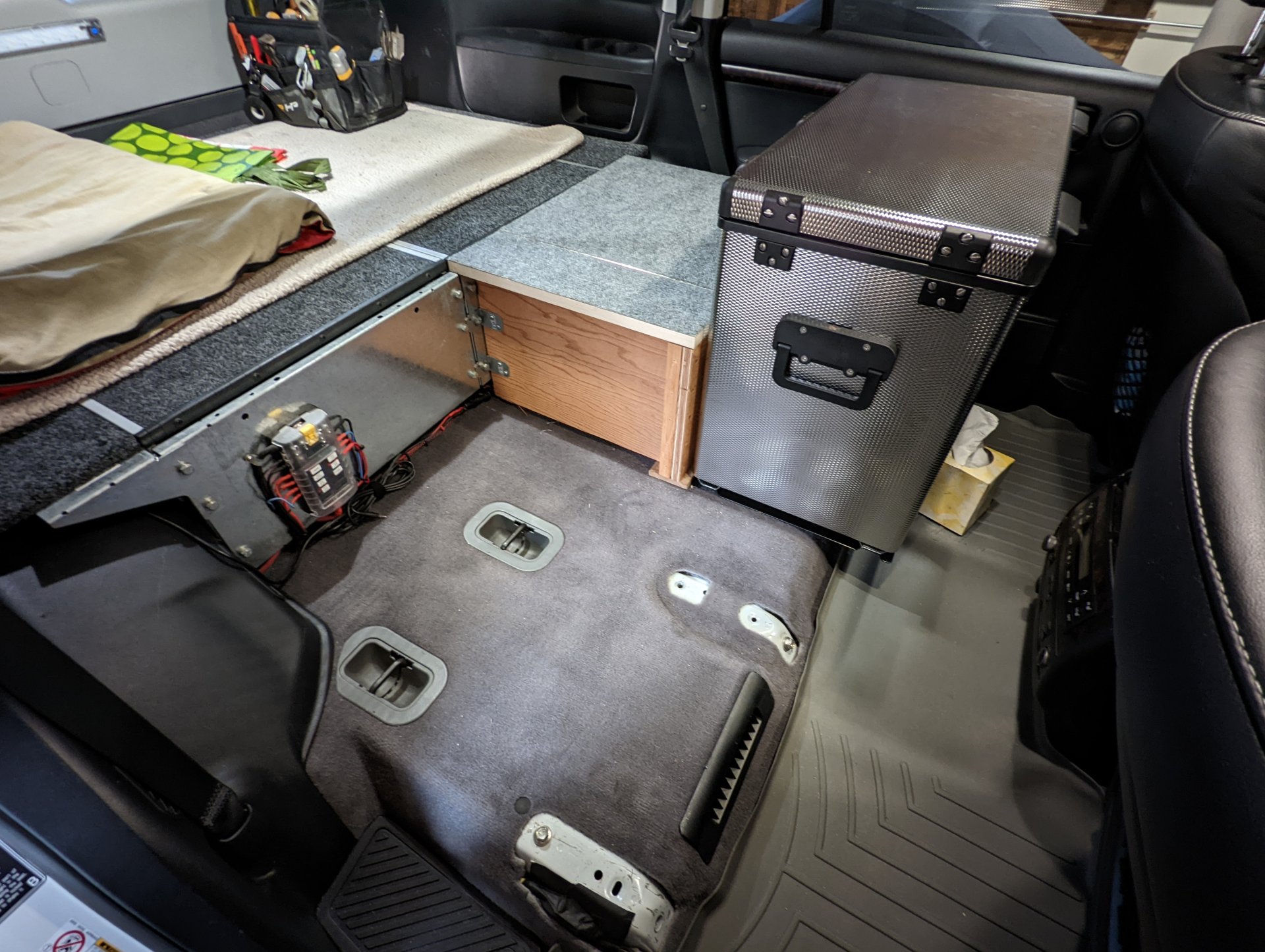

Thought I'd post an update, show my solution.
This is what I came up with. All of this was made with wood and other supplies that I already had in my stash. Used a piece of 3/4" plywood to make a platform for a travel bed, then added an edge with some poplar to keep the bed from moving around. Bolts go down into the existing threaded holes for the seats. Very easy to remove.
Found him a cushy bed on Amazon.
But I still needed some sort of barrier to keep him from crawling into the back, and to keep cargo from sliding forward. Found an old pet gate in the basement that I wasn't using anymore, so I harvested the plastic mesh. Used more poplar and pocket screws to build a frame. This bolts to the drawers and the Victory molle panels, where I installed some M6 threaded inserts, using some Simpson brackets I always keep on hand. (Extra credit for using OEM hardware ;)) Again, very quick and easy to remove, very strong.
The carpeting piece is held with snaps, it protects the fuse panel and collects extra fur/hair that he seems to shed in abundance.
We've taken him on several outings now and it works really well.
