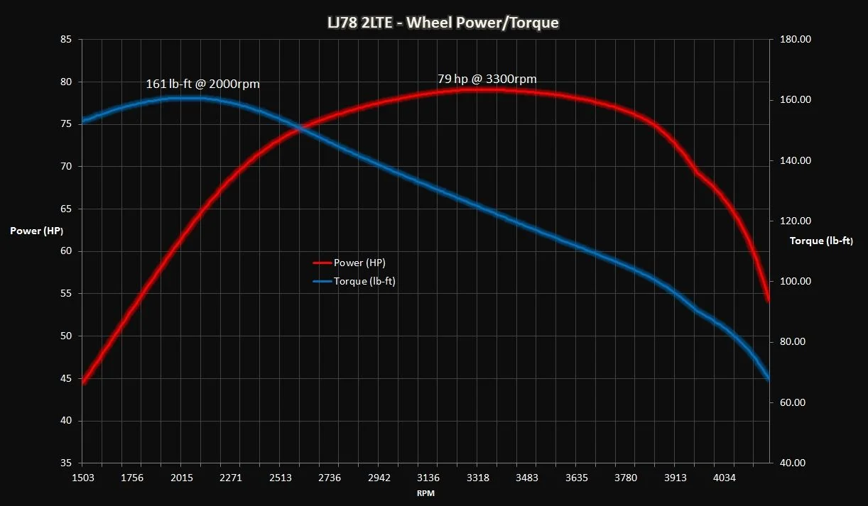

Thought I'd try out a poor man's dyno. :) Home - PerfExpert
Did a bunch of research on smart phone accelerator based power estimators. PerfExpert seemed to have the highest reviews for realistic results (when used properly). I went for it and installed it on my Android phone.
I also have a 'G-Tech Pro' device which was popular over a decade ago. Also known to be very realistic (again when used properly). I have used this with other vehicles and it is usually dead on.
I have a weight scale near my house, so am able to get a pretty accurate weight for my truck. I meticulously entered all the specs for my vehicle into PerfExpert.
So the G-Tech device on multiple runs on many different roads gave me a solid average of 78hp to the rear wheels.
And here is the result from PerfExpert (a typcial result of five different runs). I exported the raw data and made a graph in Excel so I could post it here. This is power and torque at the rear wheels. Matches the G-Tech result very closely.
It is an automatic. Done at sea level at 10 degrees Celsius. This is my daily driver and towing tune.
LJ78 with 2LTE engine:

I'm quite impressed with the app to be honest.
Oh, and from my research, a stock 2LTE with a manual transmission puts down 42 hp to the rear wheels. So I am seeing nearly double stock power unless I'm missing something here.

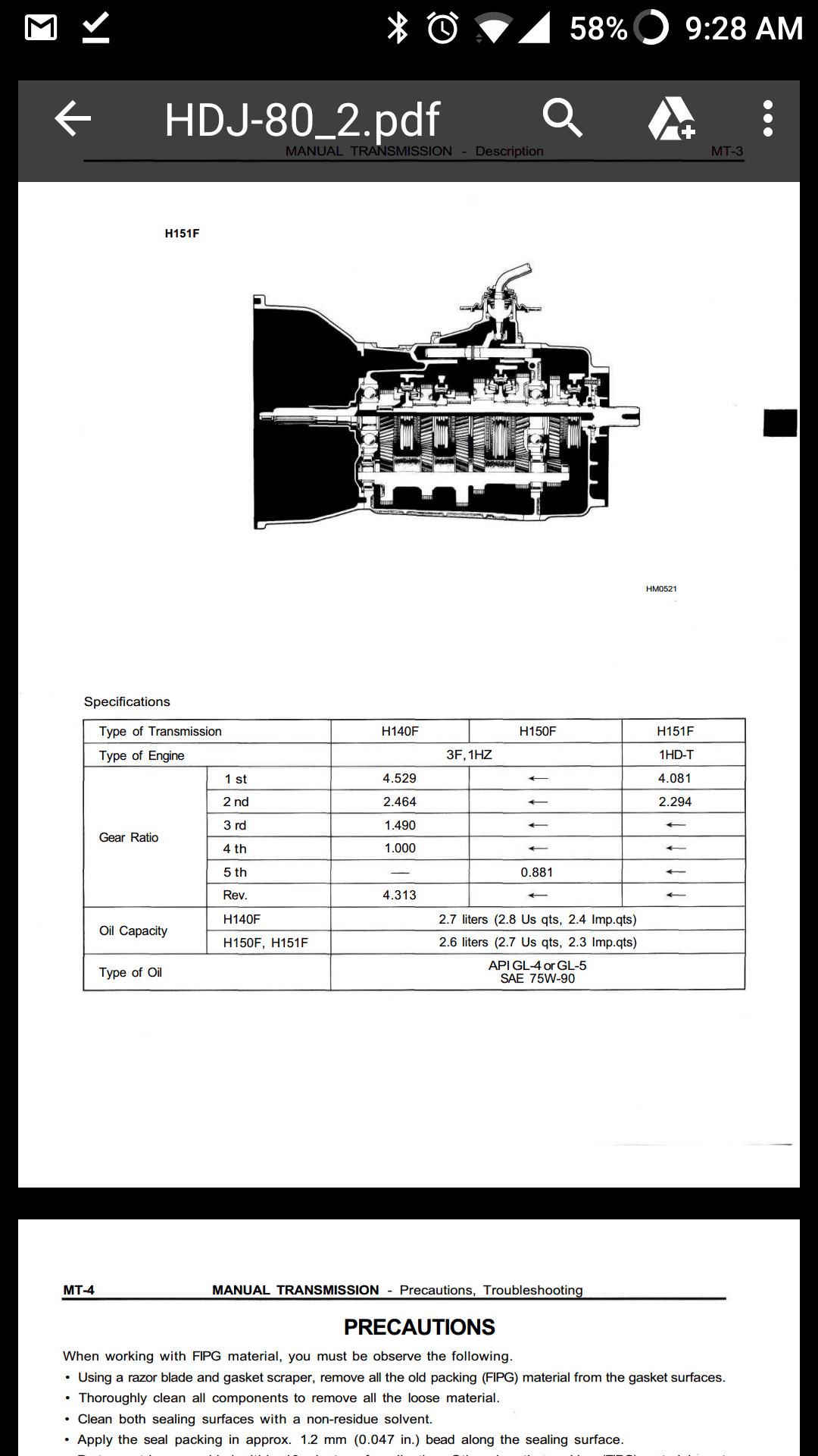

From my Ellerey's aftermarket workshop manual.
1hd-t is rated at 115kw@3800rpm, 357Nm@1800.
115kw is approx 154hp.
357Nm approx 263ft/lb
Not sure if those figures are supposed to be engine hp, or at the wheel. I expect it's engine.
This is the first I have seen mention of taller 5th gear in the H150 vs H151. Curious the source of that document. I would love to know if a taller 5th could be swapped in to my H151. "the book" shows same 5th gear between the 2.
@tweeek I would take your info as correct. The photI I posted is from a non-genuine workshop manual. It's pretty good, but has errors.
As for 5th gear. It would not be possible to change only the 5th gear ratio in the h15* boxes, as all the forward gears use a single cluster gear

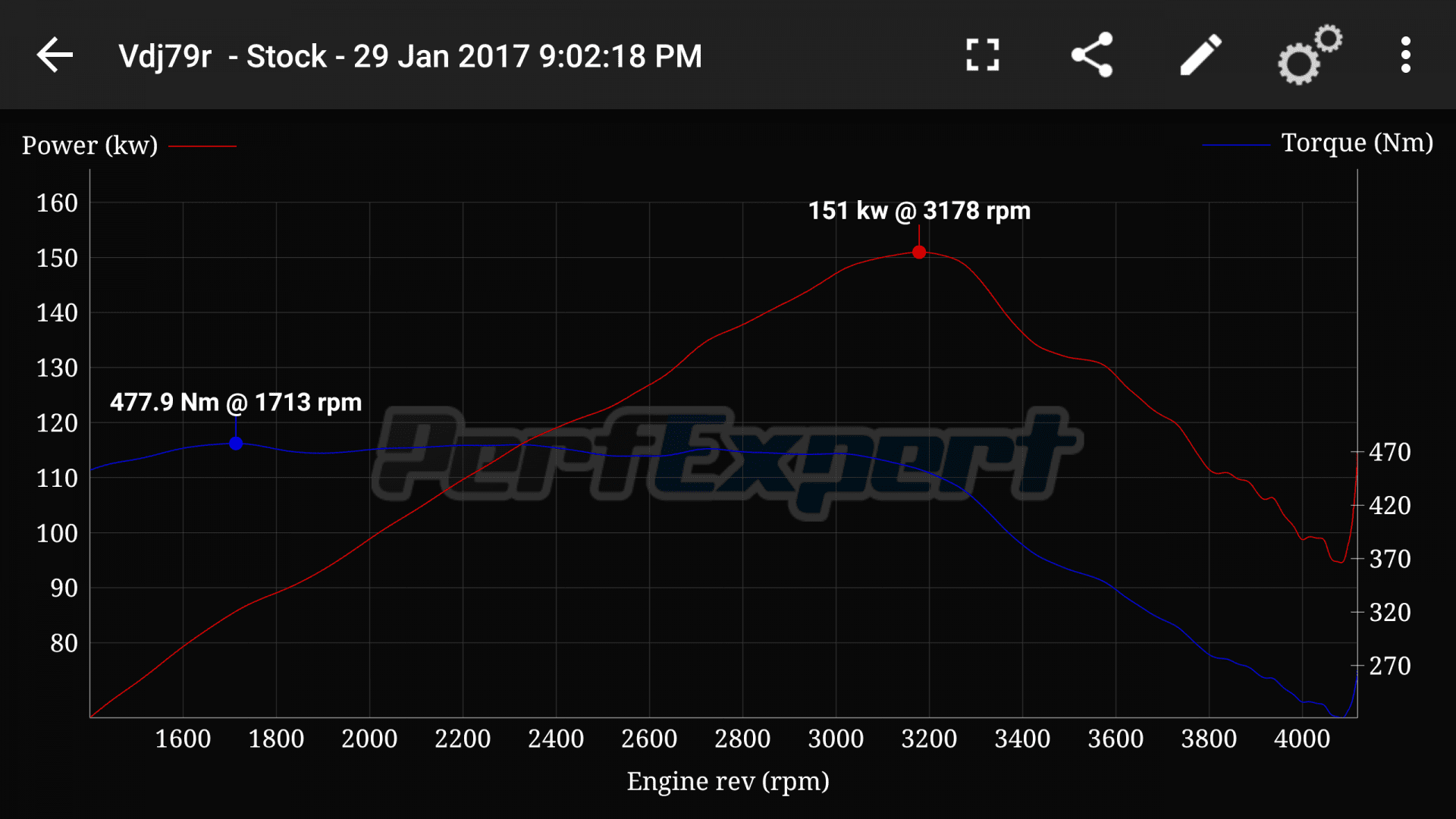

Interesting little app, so I thought I'd have a play. This is how my vdj79 went. Its all standard apart from 3.5" exhaust. This graph show engine power. Factory numbers are 151kw/430Nm. I did 3 runs, this was the average.
Torque seems high, but peak power and flat torque curve seems correct. Any comments?
Any comments?
It's probably reading high due to the vehicle pitching under acceleration. Soft suspension with the rear squatting and front rising will add to the accelerometer readings.

PerfExpert does have a degree's/G Pitch setting. It recommends 4 degrees/G for a soft suspension, 3 for regular, 2 for hard, 1 for very stiff. I set mine to soft. But now that I think about it my truck does not really pitch noticeably while I accelerate. Rear springs are pretty heavy. Maybe I should try a stiffer setting? Might get more power...:rofl:
