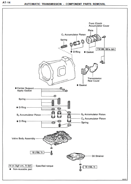

2. Installing the throttle cable seems a complex process involving removal of the valve body and then 'REMOVE O / D CASE AND CENTER SUPPORT APPLY GASKETS'. Here is a figure (page AT-14 of FSM RM314E):
Moreover, these gaskets seem to be installed to some kind of elongated thing with a pitted side (page AT-121 of FSM RM314E):
Whatever the heck such 'center support apply gaskets' are, they are non-reusable and I have to locate their part numbers before starting the change of the throttle cable. I have not been able to find them in ToyoDIY neither in japan-parts.eu. Toyota Spain is useless for anything older than ten years which, further, was never sold in the country.
