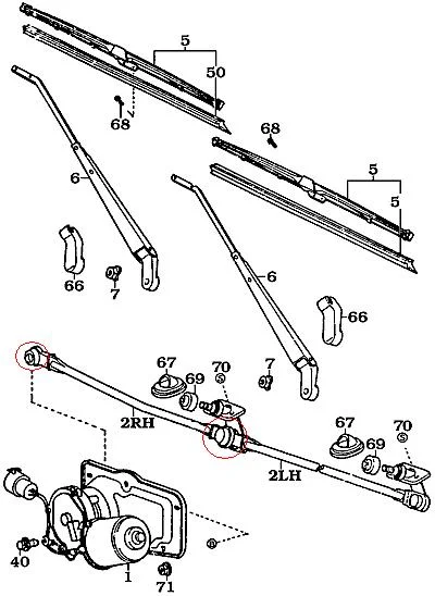

I need bushings for my wipers - a bushing to connect the left link arm to the motor, and another bushing to connect the two linkage arms to each other.
SOR doesn't list these separately, so I don't even have a part number (see attached image - I circled the bushings in red).
Any ideas?
They are not available separately, you had to buy the whole arm assembly and I read that part is no longer available from Toyota.
Have to find used ones..

Unless the bushing is completely rotten do what I did. Run safety wire across each side of the bushing with it attached to the ball end. I wished I had a picture but I would have to take it apart to show you. It keeps the bushing from popping out and the linkage dropping down on the ball causing a lot of slack and noise! My 60 is the second vehicle I've done this to, and it's worked for about a year now. I'm not paying that much for a bad design in the first place, if the bushing finally breaks my plain is to cut the ball off the other end drill a hole, and use some small sealed tie rod ends off a riding mower.

But they are $11.00 for each bushing and $63.00 (AU) for shipping, and I'm not sure if that is $63,00 each either as the never replied to my question. Plus this is aftermarket parts not stock. For $100 more, I'll take the whole assembly.
My plan was similar to above, to use a pair of tie rod ends attached to the stock arms.

I bought a few of those aftermarket bushings a couple of years ago and they WILL NOT work on stock toyota 60 series linkages. They only fit on the same aftermarket manufacturers linkages.
I too have run a repaired drive bushing for a number of years, but decided that my safety is worth more to me than saving a buck. So that is why I bit the bullet and bought a new OEM linkage (I was also told they were being discontinued). The old one lasted 25 years of hard use in west coast rain and wet snow, so i figure the design's not that bad....
